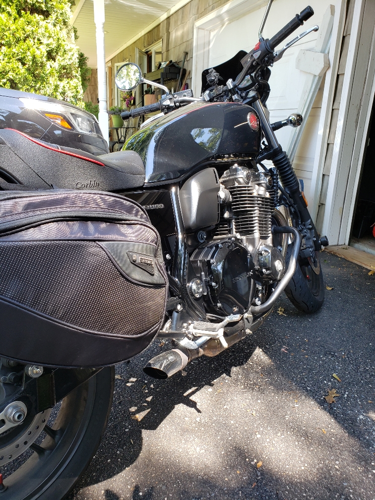

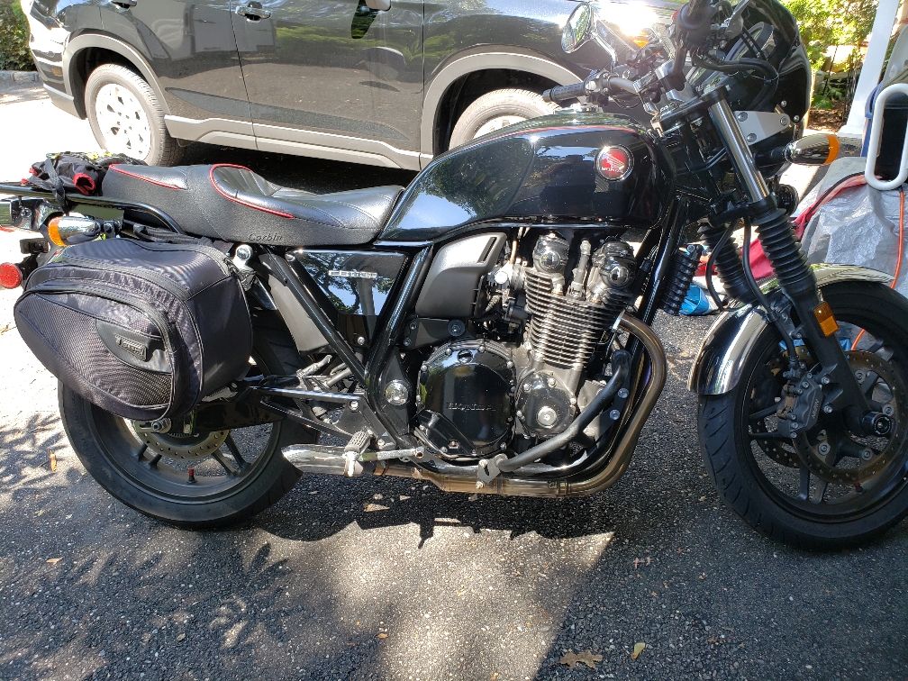

I am also happy with the way it runs, but I do want more sound! It sounds like a hair dryer. I drilled the end plate almost completely out, but it made very little difference. I was thinking of decatting it, but my BIL says that will introduce tuning problems, so I don't know. I modded the exhaust of my first Nighthawk 750 and it sounded great. My second Nighthawk had a Yoshimura pipe that I repacked to tone it down some and raised the needle on the carbs. If you dont mind taking the center stand off. I have this exact shortt exhaust, it actually has a small glass pack in the side walls you can replace occasionally. Its significantly louder than the stock exhaust and its 1 stainless steel band to install.
Very clean looking exhaust end, weighs almost nothing, all the room in the world for aftermarket mounting saddle bags without a muffler in the way. And it sounds awesome - not obnoxious but not quiet. Its quiet on the low end and around town but when you wanna open her up you'll hear her roar lol.
https://www.amazon.com/dp/B07V67KYV8/ref...oFbM87R6QT[Image: f69bd9a3c5c5cf2cf3a37d7e1cee1a40.jpg][Image: e0faf178a4fc468ee48eb9e3c375afae.jpg][Image: f8916206074069d1a89243d140c9deed.jpg][Image: fcc9cdaff2de1185e3cdbba0c02464a8.jpg][Image: 3cacf89fd2743983f35c011843ff0973.jpg]
https://www.amazon.com/dp/B07V67KYV8/ref...oFbM87R6QT[Image: af5b8914ba6893d6d38798804eb7a254.jpg][Image: 5b36dc29a6d930bc44091090dd44fc96.jpg][Image: dd70e2c857471f5a03eaf38d4eb2e1d5.jpg][Image: 6955a0ea822e0df351e5cf5d94160f81.jpg][Image: 92084df1b6b7cc0322ae501b851bb6c6.jpg]
Sent from my SM-G965U1 using Tapatalk If I could post a video I'd grab you a sound clip with some of my higher quality mic/camera but I believe the only way to do that is with YouTube. **I've so had that tip on for 15k miles with no issues**
