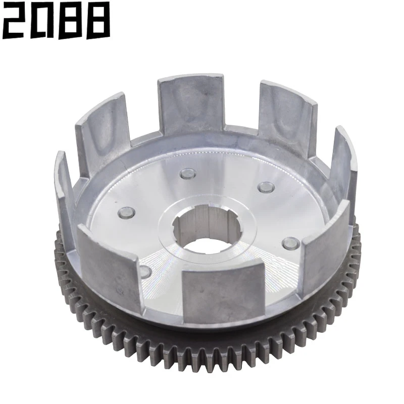

The clutch plates are circle shaped with tabs that stick out-

The tabs on the clutch disks sit inside the clutch basket. The basket has fingers that line up the tabs on the clutch plates-
[Image: 11ce6c180b60d9d8cada712193773213.webp]
When the disks spread or clamp- they are spinning with the engine- so the tabs ride back and forth against the clutch basket fingers.

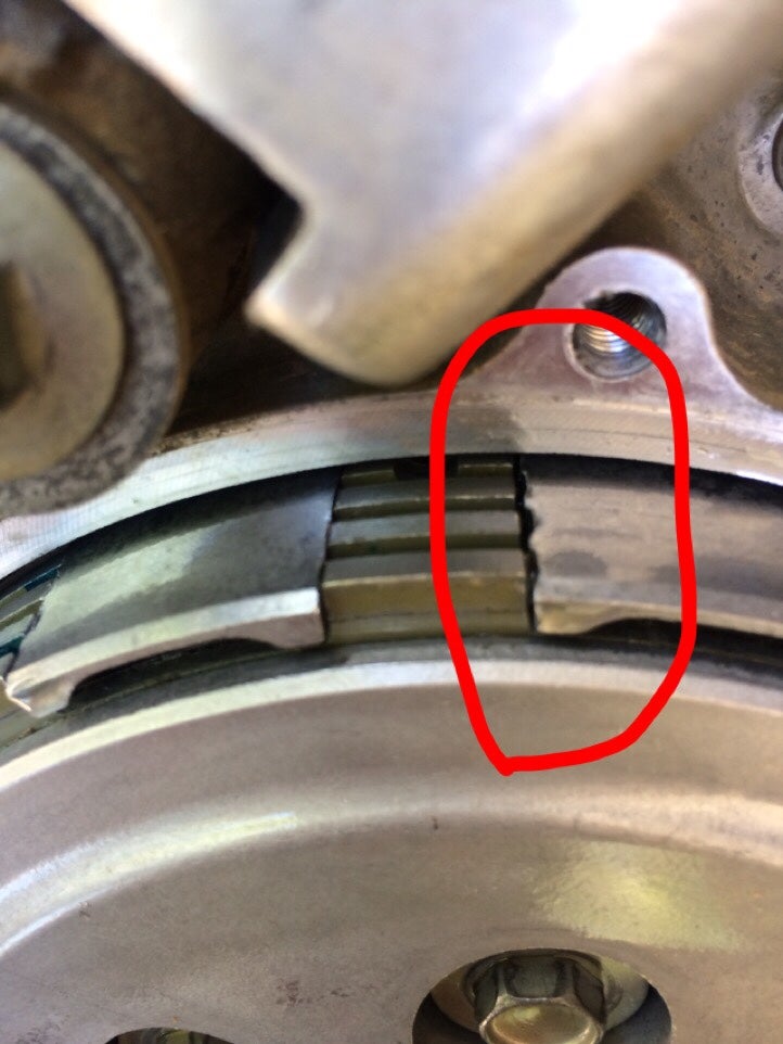

Every time you get on or off the gas- the plates move a little forward or backward wiggle inside the clutch basket and make a small impact. Eventually that impact starts to wear the fingers and creates notches.
[Image: fd3cafeef8b8ea7de9455a6ce8a2550c.JPG]
Those notches make it difficult for the plates to move back and forth across the fingers when clamping / unclamping.
[Image: 5effa61557a4f36cd6df39854286ec33.19420]
That leads to plates not fully separating so the clutch drags, finding neutral is more difficult, etc.
