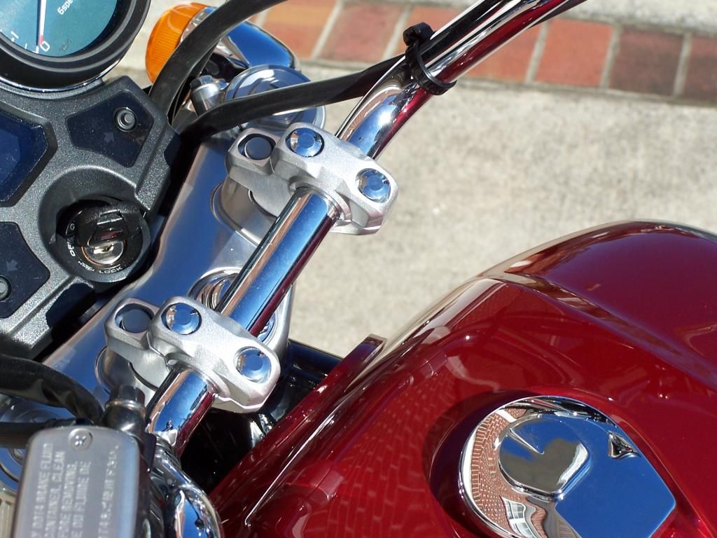

I wanted to bring my handlebars a little closer to me. Looked at SW-MOTECH Handlebar Riser Barbacks but had concerns about wiring and cables. So I made my own set with the same dimensions just for trial purposes. With a little rerouting, it appeared to work. Ordered the real thing from Twisted Throttle. After installation I was able to also rotate the bars downwards slightly and gain a little more movement towards me as well. So far so good. I took the photos of my homemade products (Fred Flintstone barbacks) with a flip phone, hence the not-quite-in-focus shots. My first try at posting photos so here goes.....

interesting, but it looks like it worked so..good thinking, and congrats

The Sw Motechs look great.
