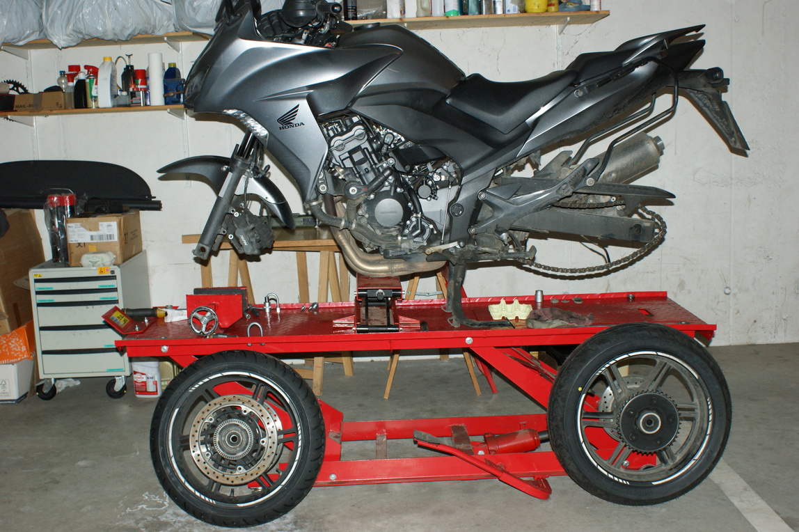

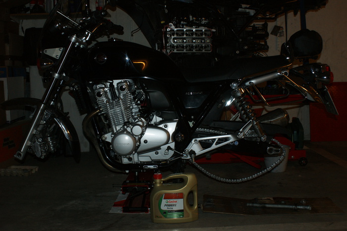

These are mine:
[Image: b2debcbcf30bebb1cf160e0fb43efde2.jpg]
[Image: 7e97c301332cf24c9754cbc99b3b454c.jpg]
Well, that was a little bit more than tire change:

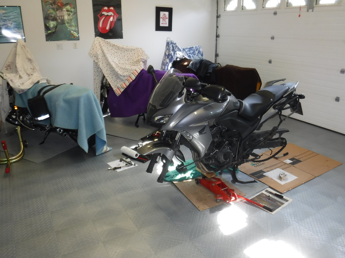

And sometimes somebody else does the complete job (more or less):
[Image: f5861bbcf74114d4b47b31b8e019ddc2.jpg]
I thought I was the only one that covers his bikes with towels, sheets, blankets and T-shirts!Tongue
