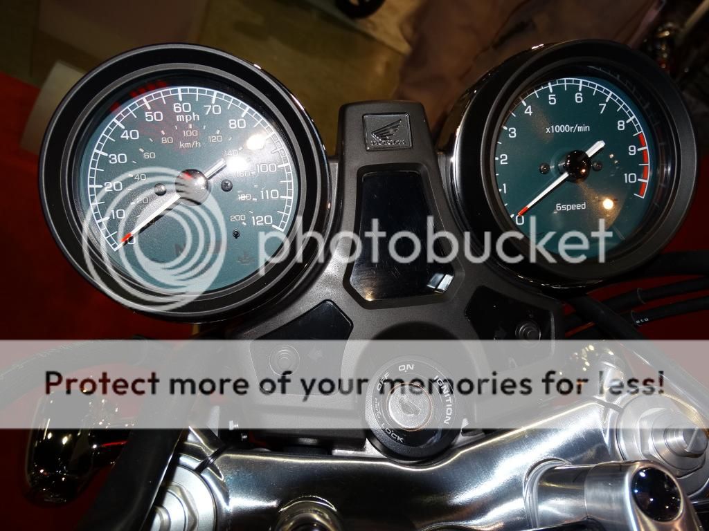

In this photo, you can see the difference in the finishes between the upper and lower clamps. The lower appearing more silver/gray like the 2013 model clamps:
[Image: 99d8a5efa86b8fc345366f7f3e8698c3.jpg]

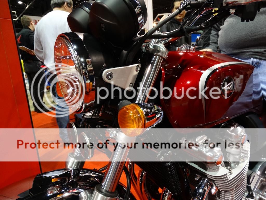

And in this photo, the upper clamp certainly looks more polished to my eye than the silver/gray finish on the 2013 model:
[Image: a6a83907d4bfebb37fe7377204d58fad.jpg]
I think this works nicely with the styling of the Deluxe.
