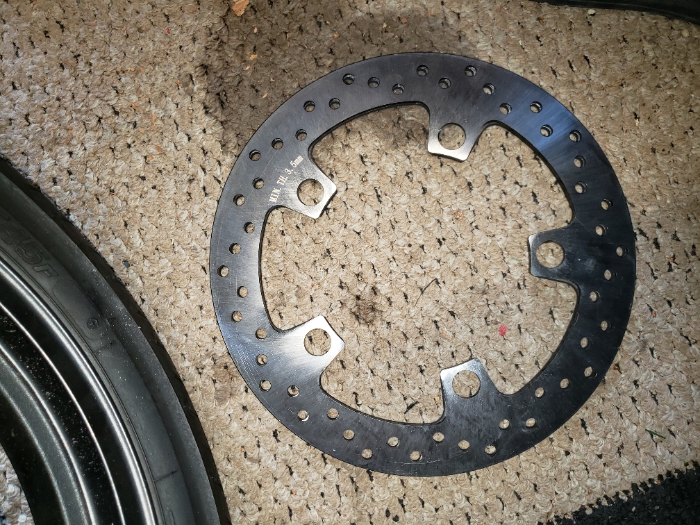

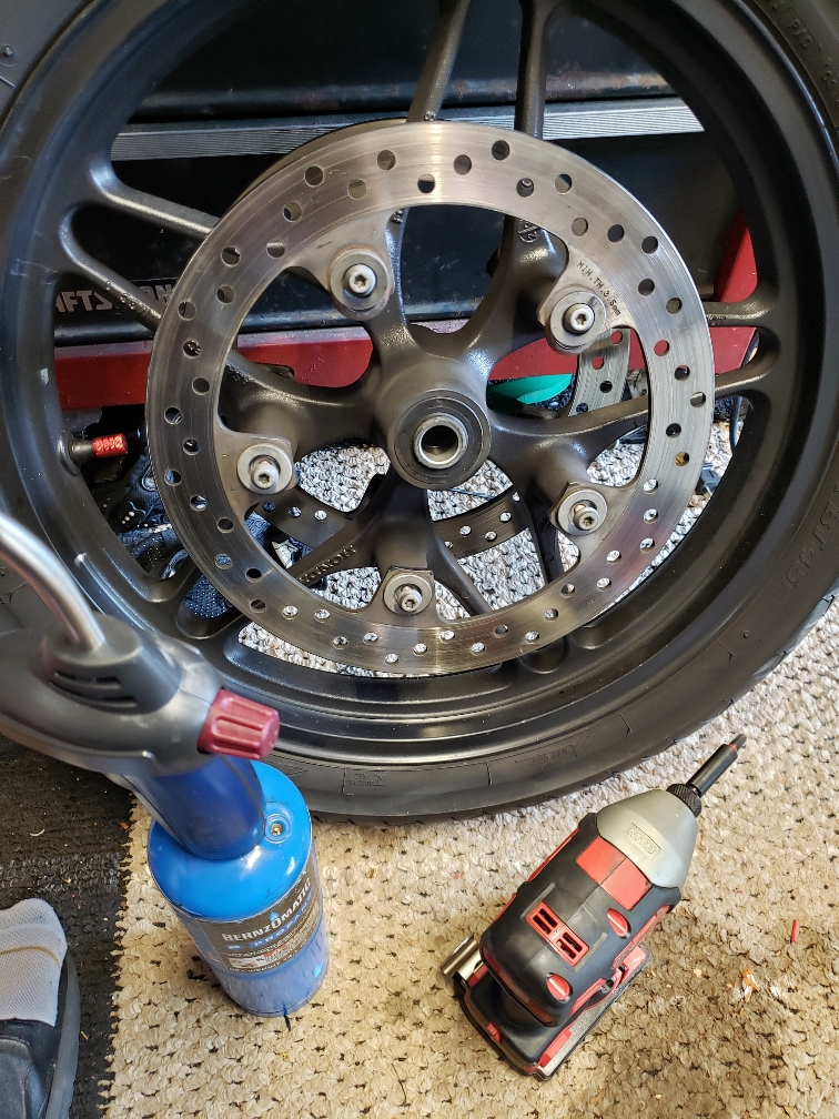

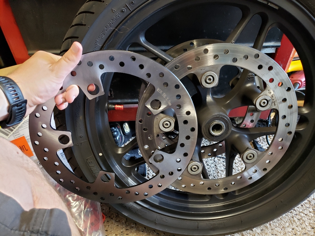

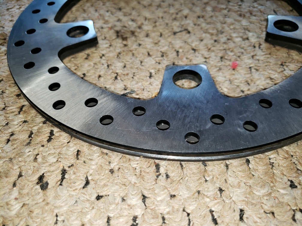

Are warped rotors visibly supposed to look bent or anything? As I lay the old rotors over the new they look perfectly straight and flat all the way around ontop of the new ones and I didnt get any weird measurements with the micrometer around the old ones?
I definitely had the low speed pulsing on the front end when I was coming to a stop. Either way, putting the new rotors on. I'm still getting a perfect 4.4mm on the old rotors all the way around. Still plenty of life of them if warping wasnt a question. The new rotors are 4.5mm all around...
