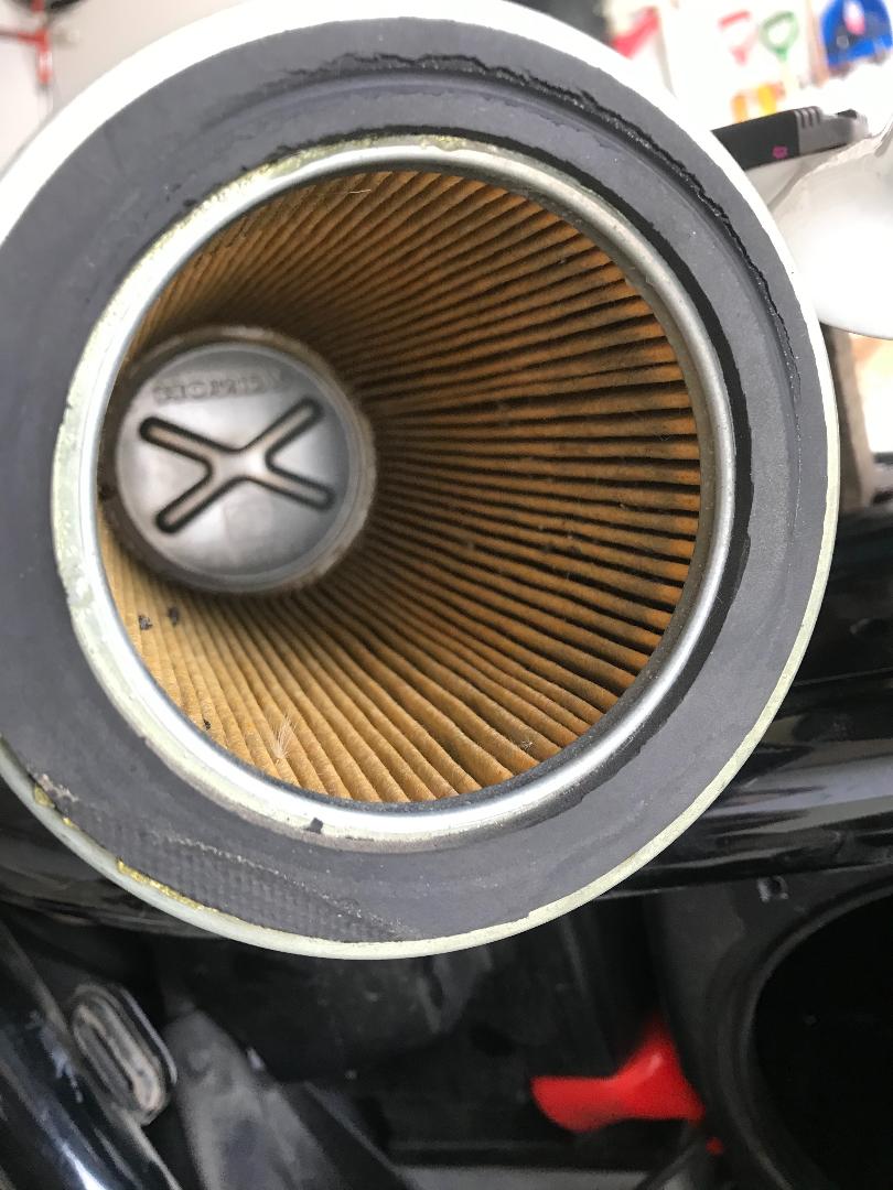

At 17k miles…first change:[Image: c2b66d28bd58a98481940b478364e8bb.jpg]
Thank you mtneers. Your filter doesn't look that bad! I will check my filter this weekend and replace it if it appears dirty.
