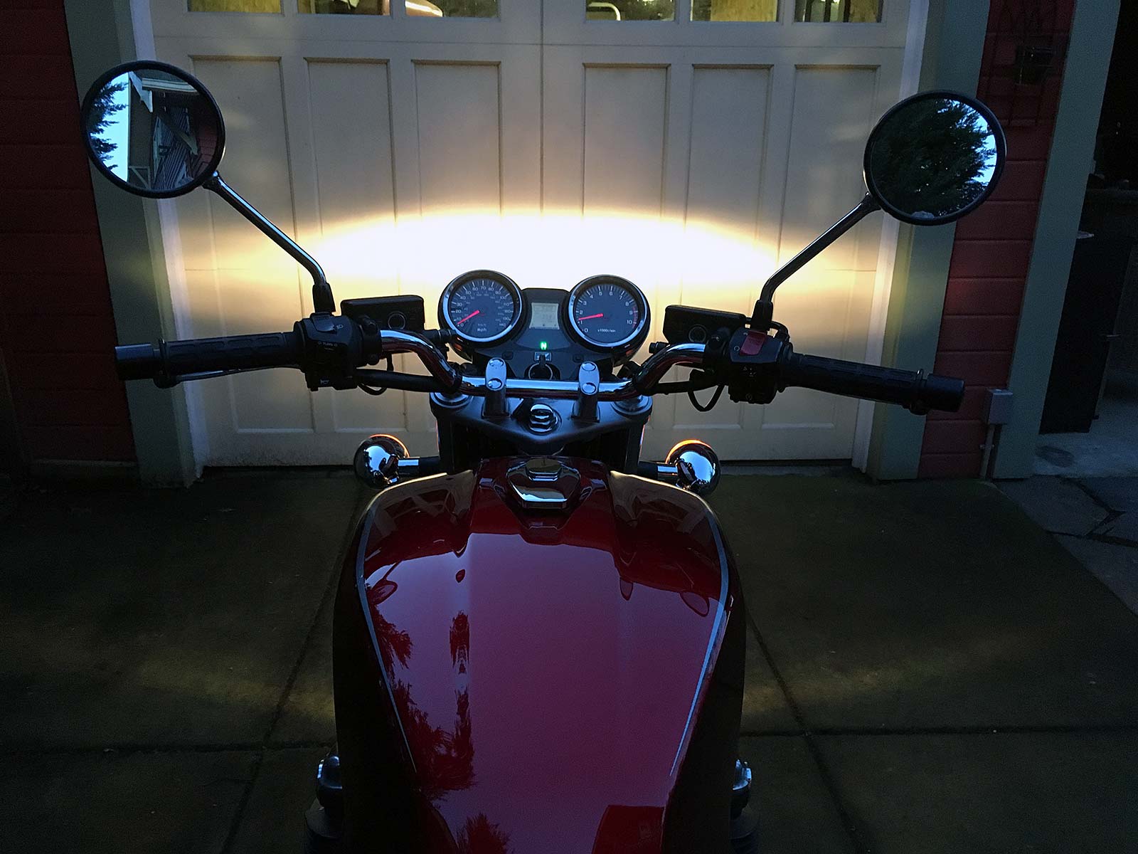

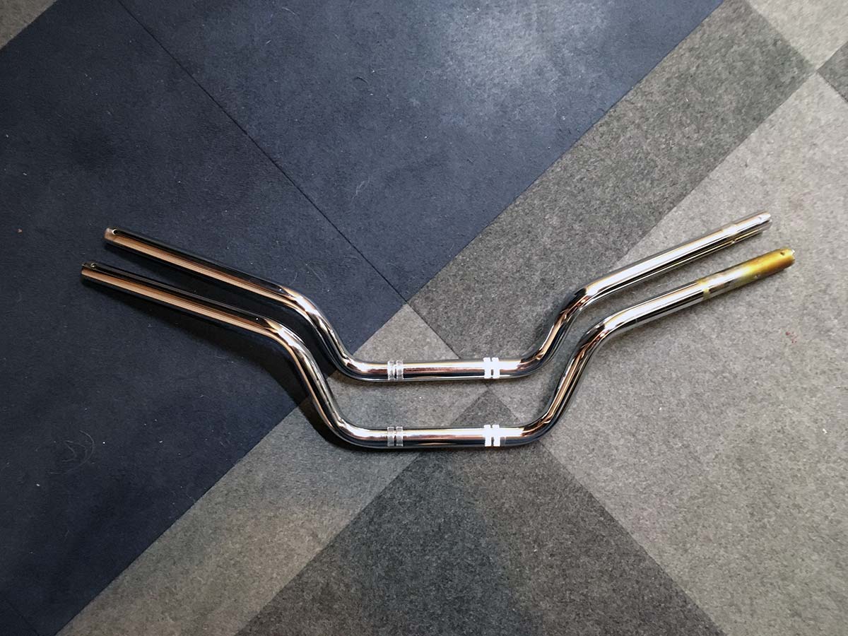

I finally got around to swapping out the original Type I handlebars on my CB1100 for the Type II bars to go along with my lower OEM Japan market seat. Sadly, I didn't even get in a ride after finishing the swap. Fortunately this evening I managed to roll the bike out of the garage, go for a quick spin and snap a couple of pics. My first impressions (and that's all that I have at this point) are positive. I can certainly feel a difference, but it's not too dramatic. The seat feels firm, yet comfy enough but I won't really know how well it does on a longer ride until sometime later on. The e-cushion material definitely feels a bit denser than the foam in the stock seat. Being able to firmly flat foot the bike is really nice. The bars are nice too, being a bit narrower and lower than the Type I bars. I probably felt more difference from the handlebar swap than I did from the seat swap. I'll let the photos tell the rest of the story. Good stuff!

Looks good. Hope you get the results you want. What exhaust can is that? looks lighter than the original.

That's a Staintune. I'm reminded just how much I like it every single time I ride my CB — it sounds amazing.
