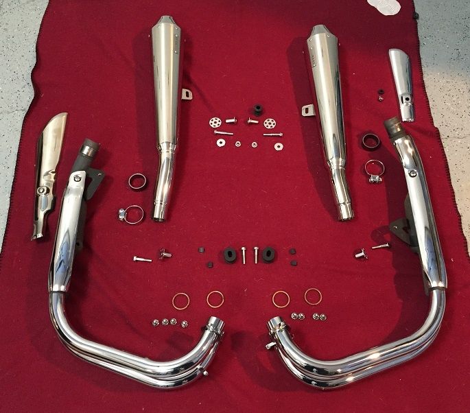

Picture all my new parts:
[url=http://s1376.photobucket.com/user/ronsteinbruegge1/media/Mobile%20Uploads/00000000-0000-0000-0000-000000001A3A_zpsbc0wsmhn.jpg.html][Image: d0414737a4c1981e6175d783d8d2aeaa.jpg]

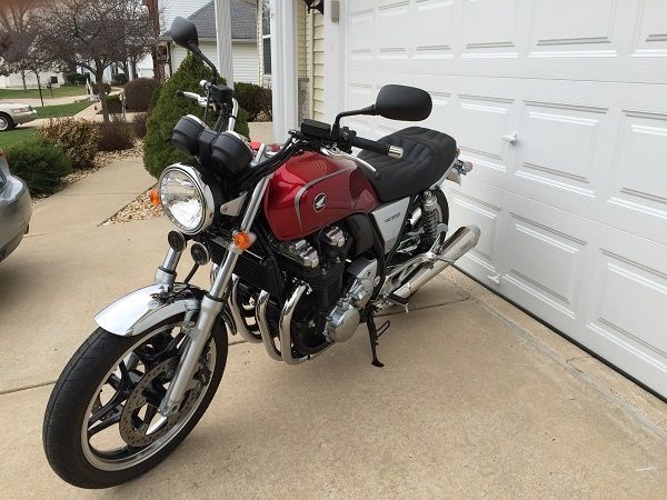

All in all, this project went very well and the new sound it great! Not to mention that I love the looks! Now I'm waiting for my fairing, side covers and engine guards to get her ready for riding season.
Here are pictures of the finished product:
[url=http://s1376.photobucket.com/user/ronsteinbruegge1/media/Mobile%20Uploads/00000000-0000-0000-0000-000000001A40_zpsuw3wghm7.jpg.html][Image: 42a0b5147669f7af07e60c195bbe328e.jpg]
[url=http://s1376.photobucket.com/user/ronsteinbruegge1/media/Mobile%20Uploads/00000000-0000-0000-0000-000000001A44_zpsax88uksj.jpg.html][Image: 803f3d975fd3d2168b5da3eaab01bf5a.jpg]
[url=http://s1376.photobucket.com/user/ronsteinbruegge1/media/Mobile%20Uploads/00000000-0000-0000-0000-000000001A39_zpsbdkjytrg.jpg.html][Image: c14e381e0e2ae5a0f8cc308fc4251acc.jpg]
