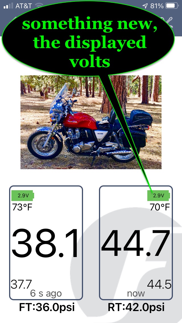

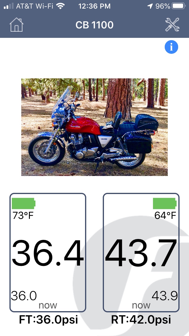

. fobo news.. to me anyway.. I have just noticed, the app now displays the batteries voltage.. nice.. no issues lately with the fobo.. knock wood..
..[Image: 893b5b5d8d017ae69efcf374f2ff31f5.jpg]
..[Image: b6e3eddb420a00fb1eda19a2d6e3b513.jpg]

Fantastic Chuckk. Glad to see it still working well after all this time.
