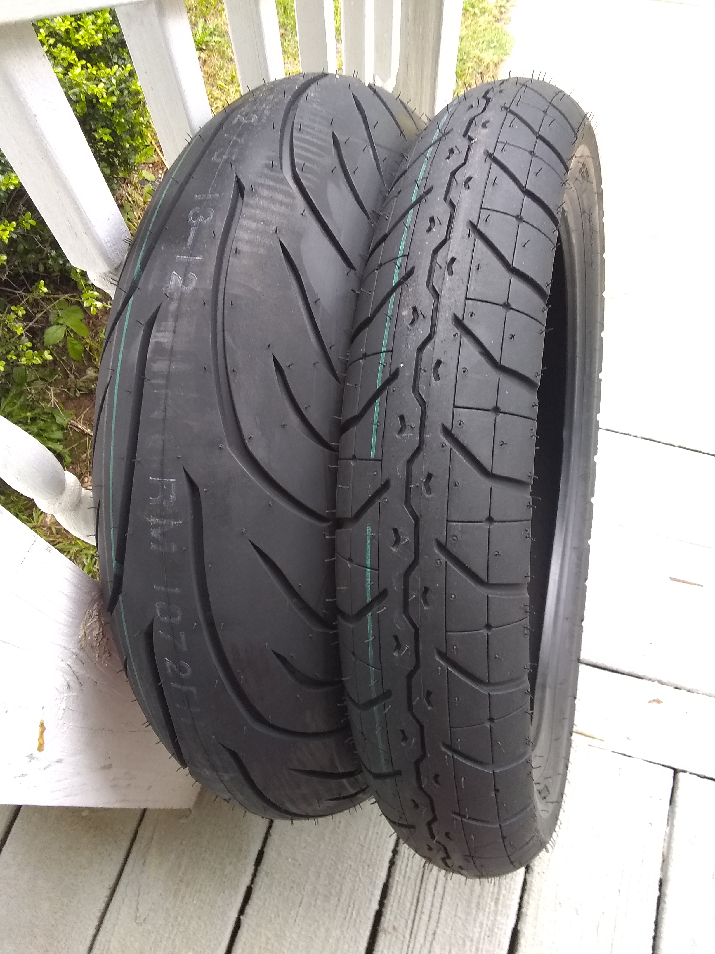

E11even, rear is SE890 Journey front is 230 Tour Master. Pegs dragging (feeler screws removed) wet or dry, brake or gas, no problem! Amazing tires!!! I'm guessing around 9k miles like the Pirelli's. My lowrider (2018) has haunted the mirrors of many a sportbike on hwy's 19/129 and 60 in the N Ga. mountains...
[Image: 5288ab3228d68dbba2a7afbaf7bc79f5.jpg]

they are installed. over 1000 miles wet and dry and they perform equal to the Pirelli Night Dragon. can't get matching pair in sizes for the 2018 FXLR in Shinko tires. front is a 110
