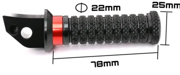

Also, I think I've come up with some good footpeg lowering options to explore:
A) eBay has up to 40mm  passenger lowering pegs you can order for a CB for about $50:
      [attachment=1234]
--but if that is not exactly the solution to get your passenger comfortable, a more-flexible option is to...
B) buy round replacement passenger pegs like these...
     [attachment=1235]
... and then attach adjustable highway pegs like these...
     [attachment=1236]
...to the round pegs, which in theory could possibly move the passenger pegs up to 10" lower/forward! (though you have the exhaust pipe, ground, and your own rider footpeg clearance as considerations, too, of course).
I'm still ordering product and playing with options--round passenger pegs delivering tomorrow--so this is all "should work" not "will work" currently.
I can keep you updated if interested....

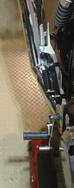

Here's the update.
As such things go, moving the passenger pegs forward enough to prevent my wife having knee pain resulted in not enough room for my own feet, so the rider pegs also needed to go forward, which in turn necessitated moving the shifter forward
The passenger peg is moved 8" forward.
The rider peg is moved 3" forward and 1/2" lower.
This makes the new rider peg about 6" distant at a 45 degree angle downward from the new passenger peg.
[attachment=1301]
Passenger pegs (old and new) folded away for solo riding:
[attachment=1305]
This may not be the final setup, but it is solid and anything mounted to the bike has a layer of rubber protection, meaning everything can come off leaving a pristine CB1100.

Lucien, what product/process did you use to move the rider pegs and levers? Looks like just a little step-out extender?
For the front footpegs:
I replaced the OEM rider pegs with adjustable McMotoparts 40mm extension front pegs that I found on eBay searching "CB1100 extended footpegs." There are several colors and styles of footpeg offered by various vendors, though McMotoparts apparently makes all the versions no matter the vendor (as far as I can tell).
These pegs consist of three main parts that bolt together:
[attachment=1320]
Because of their modular nature, you can actually addan  extra 40mm middle section to extend the pegs.80mm, which is what I did:
[attachment=1317]
You can buy just the middle sections direct from McMotoparts:
[attachment=1318]
https://mc-motoparts.com/collections/foot-pegs-extension-adapter
For the brake and shift levers:
Both the levers are still works in progress, and I can post an update once I have this project finished, but the current plan is to use a bolt-on brake pedal extender (currently awaiting delivery) and cutting and recombining two OEM shift levers (currently with the welder) in such a way that I end up with a lever that is nearly twice as long as  the stock length.
Please stay tuned for pictures and a review once this project is completed.ko
