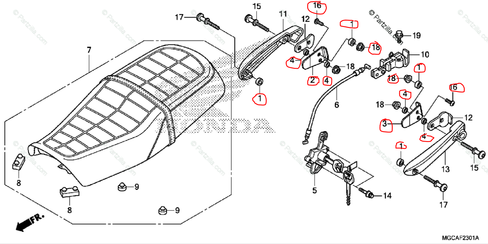

Ooo nice! Will those extra brackets in the schematic level out the grab rails?

(03-18-2019, 11:41 AM)Danlea83_imp Wrote: Ooo nice! Will those extra brackets in the schematic level out the grab rails?
I am in the midst of exploring options as well and have been doing quite a bit of research on the Japanese blogs/forums. The low Australian seat is the same as the Japanese seats 2010-2011. From 2012 onward there was a new seat part number for Japan with the new e-cushion material. The seat height is the same but the seat is apparently more comfortable.
The DLX/EX models from 2014 will fit 2010-2013 standard models. The only thing being the grab rails may interfere ever so slightly but is mostly cosmetics.
Note if you are using a Honda genuine rear carrier/rack for the 2010-2013. Once you level out the grab rails you will need the dlx/ex version racks.
