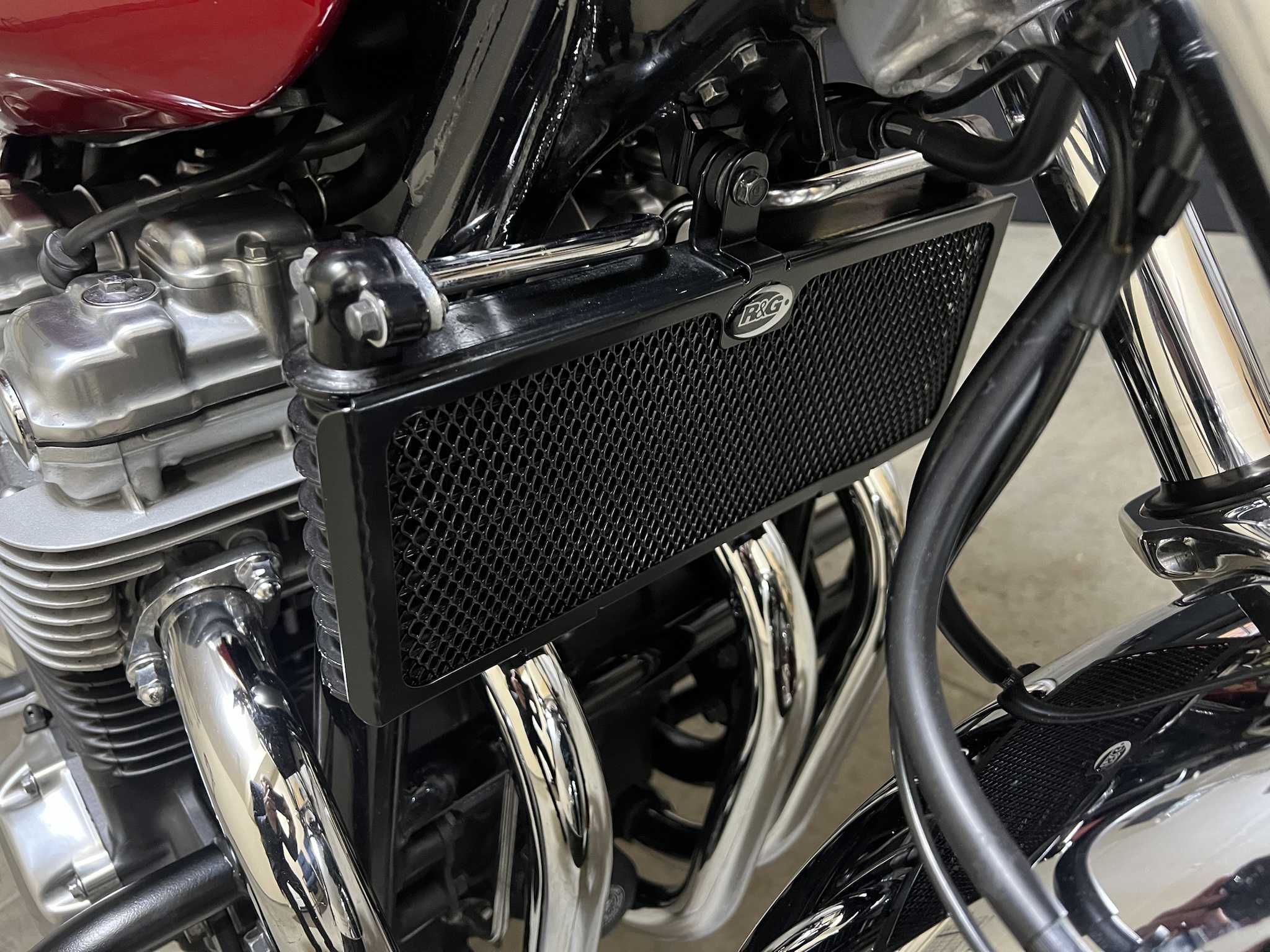

Today, I may have been foolish because I did install a R&G Oil Cooler Guard on my motorcycle. It arrived properly packed and took about 15 minutes to install. It is made of pressed aluminum, has a lovely finish, and has been customized to fit the profile of a CB1100. It reuses the bolt currently holding the oil cooler along with some foam and zip ties to secure the guard and protect the oil cooler:

I welcome your feedback on the oil cooler guard. Do you think it has some practical value? Do you like how it looks? Does it enhance or detract from the appears of a CB1100EX? Have I yet again been foolish? Smile Or did I help protect a motorcycle from a road which can be unkind?
https://www.rg-racing.com/browsetype/Oil...da/CB1100/
It is on the motorcycle now. I welcome your help in determining if it will remain so after all the construction is completed at year’s end. Feel free to have some fun at the expense of what little dignity I have left! Tell me what you think and please have a great weekend with friends and family. David

Looks fine to me, David, and I’m sure it stops the larger lumps o’ crud from damaging the fins of the original. Does it stop the little bits? Do they get stick behind the screen cover?

(01-24-2025, 06:14 PM)Cormanus_imp Wrote: Looks fine to me, David, and I’m sure it stops the larger lumps o’ crud from damaging the fins of the original. Does it stop the little bits? Do they get stick behind the screen cover?
Great question. The mesh appears to be an optimal size. It looks like it is 1/8 of an inch (3 millimeter). It will block most stuff easily but is large enough to be cleaned with a water hose for little bits and not have to be removed. There is a small gap between the oil cooler and the guard that will allow the water and little stuff to “drain.”

I installed this R+G guard as a couple of my oil cooler fins had got slightly bent (my driveway is gravel). It was easy to fit and is very unobtrusive. No complaints here.

I think there will be about a 25% reduction in airflow...??, there is no thermostat.

(01-24-2025, 10:40 PM)peterbaron_imp Wrote: I think there will be about a 25% reduction in airflow...??, there is no thermostat.
PB, you raise a very interesting question! The mesh covers only the front of the oil cooler. Hence the two “sides,” bottom, and rear of the oil cooler remain exposed to air currents. However, there is the top which has a solid plate about 1/2” wide that covers the “top” of the oil cooler. I believe that air can still flow from the front and over but heat can no longer rise “up” from the top. I am not a thermodynamic engineer so I cannot quantify the impact even though my gut tells me the momentum of the bike moving draws the heat backward toward the rear wheel.In my research, no one brought up this point nor did the manufacturer. However, you may just be smarter than the rest of us!
Aesthetically, I have always found the OEM oil cooler to be less refined than the rest of the bike. It may have been that way to vent heat up. As of this post, I like the appearance of the guard better than stock but not so much to place engine life at risk. I will do some more research.

(01-25-2025, 03:34 AM)m in sc_imp Wrote: guys, its not going to risk engine life, the cooler cover is fine, going to pass plenty of air around it, thru it. you can always calculate pass thru area of the cooler itself vs pass thru area of the cover to see. fwiw, the cooler is more there for sitting and radiating heat in traffic and low speed running than it is at speed. at speed, the motor is surrounded by moving air, not as much of a need. Its when you slow down and there's lack of airflow over the motor that it matters, and then it radiates out.
Copy. And thanks for explaining to me the underlying engineering behind an oil cooler. Oil coolers are “new” to me.
R&G Racing told me their guard will not impact oil cooling but will provide significant protection to prevent physical damage. They claim they took lessons learned from the track and applied them to the Street. They also claim to be the market leader for protecting air cooled motorcycles.
