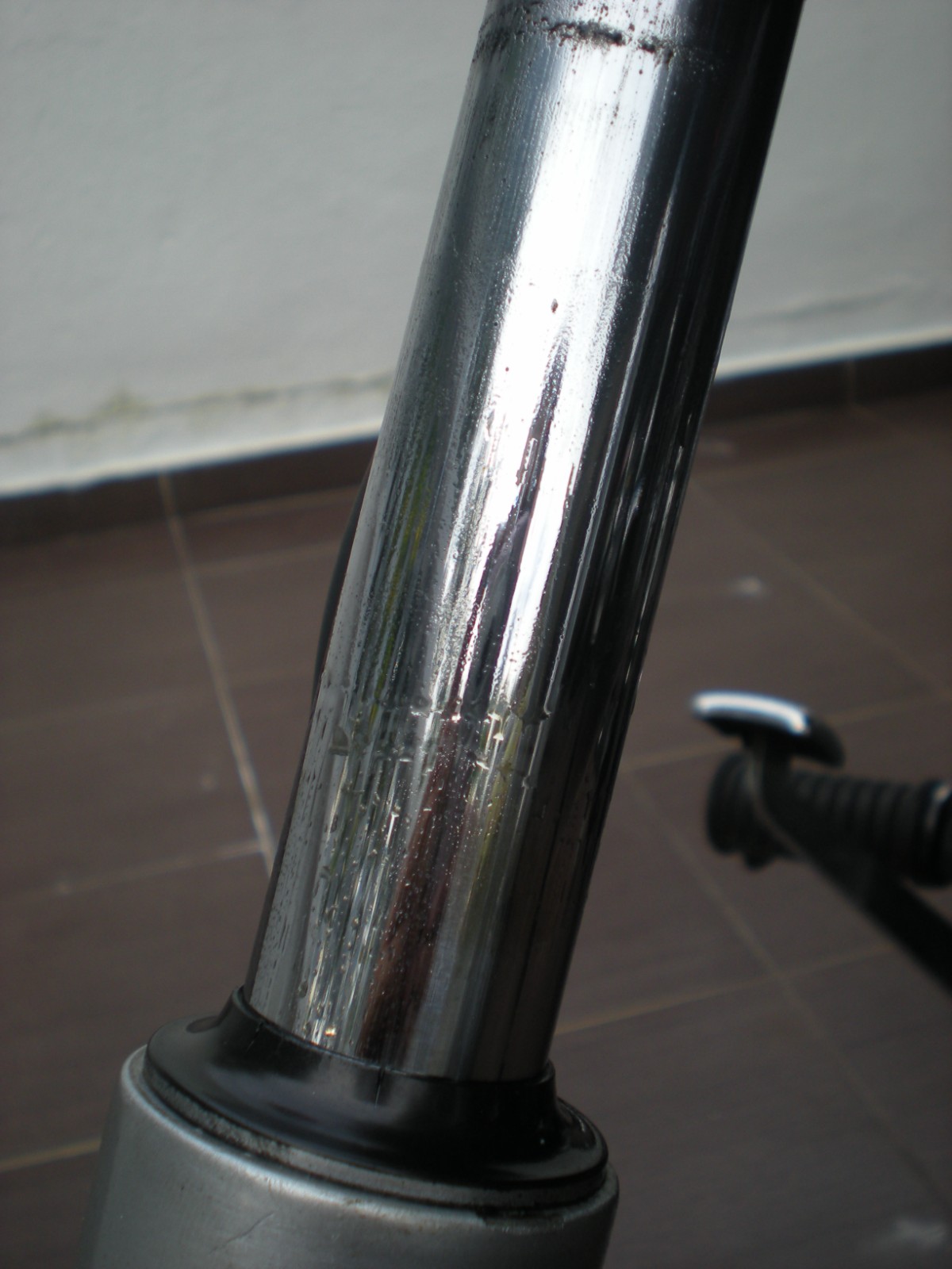

Usually there is a visible dirty ring higher on the fork tube where the suspension action pushed it, or in the case of a really bad leak oil will run down the lower fork tube.
It'd look like this:
and this
[Image: 12e6662d307b3bd293d10c3dc379bd50.JPG]
and it's not a critical thing to get serviced right away.

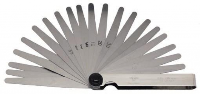

(04-27-2016, 04:34 AM)LongRanger_imp Wrote: Agree with the camera film, but is it even available for sale anymore? I haven't seen any of those ubiquitous yellow Kodak signs for a decade! And I'm a curmudgeon.
Better to use one of these:
[Image: e91b0de6ddb0dc3e9e689844d9991e88.jpg]
