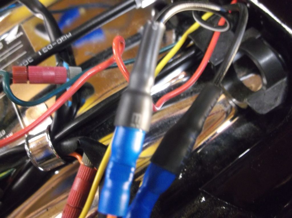

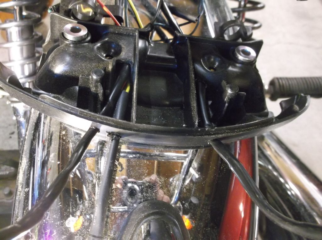

OK I spent the day moving my turn lights on the rear of the CB first I cut a chrome u clamp and then welding it to the rear luggage rack at an angle to make them square to the bike removed old turn lights and used smaller 10 mm bolt lights cut the wiring and rewired the new lights I think that look OK work fine sitting just under my rear luggage I see if I can post pics my I don’t seam to get hang of it
