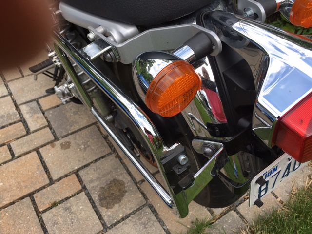

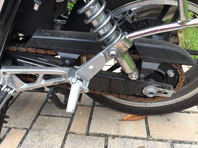

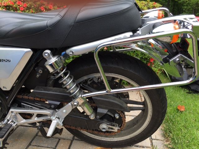

Here you go. Let me know of any easy questions. And don't judge me because my chain is rusty. We have had a bit of rain
![]() [url=http://s1331.photobucket.com/user/inhousebob/media/IMG_0804_zpsv6foiwv2.jpg.html] ![]() [url=http://s1331.photobucket.com/user/inhousebob/media/IMG_0803_zpsl1njorjw.jpg.html] ![]() [url=http://s1331.photobucket.com/user/inhousebob/media/IMG_0802_zpsaonkraod.jpg.html] ![]() [url=http://s1331.photobucket.com/user/inhousebob/media/IMG_0801_zpsdhv37ed0.jpg.html] ![]() [url=http://s1331.photobucket.com/user/inhousebob/media/IMG_0800_zpsynvjohj9.jpg.html]
05-19-2016, 04:48 AM
Bob, Great pics! Shows a whole lot more that the MotoMachines pics.
About that chain though.....
05-19-2016, 08:28 AM
Very nice! So muffler doesn't need to come off or anything? These are at least as helpful as the whole instructions list haha
