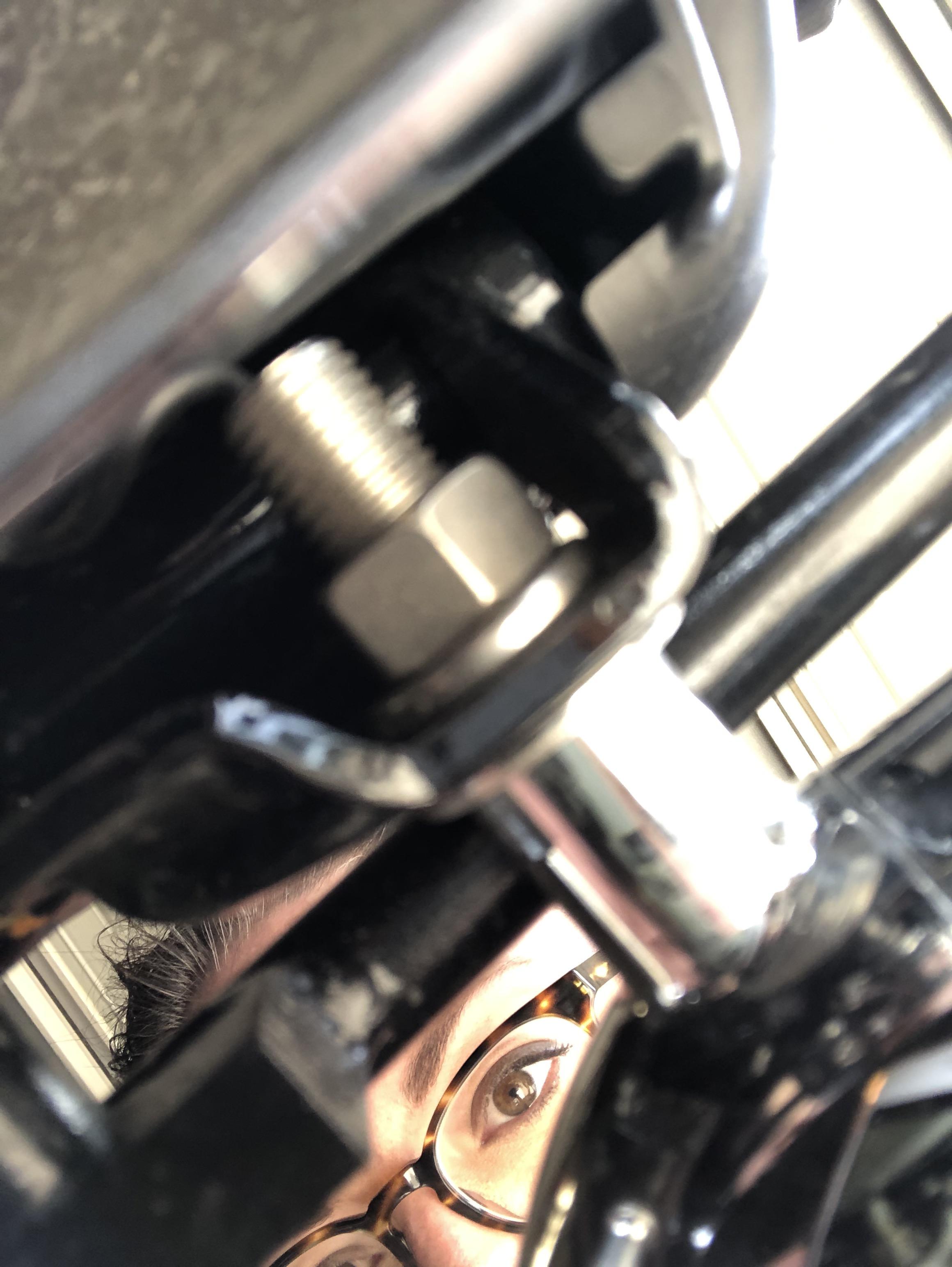

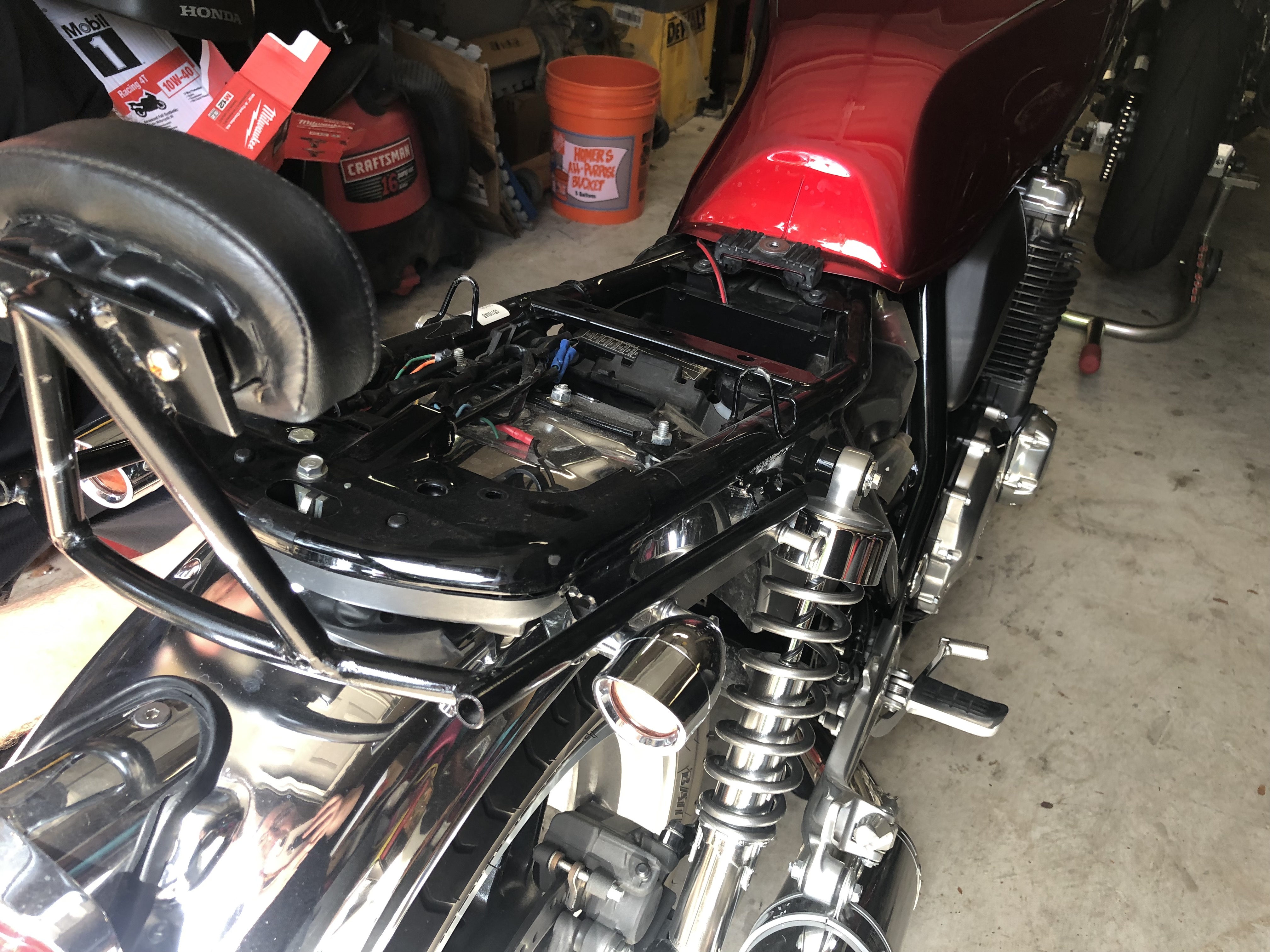

SIDE PROJECT! Some of y'all may have seen the world's smallest pillion backrest in my original post - that thing was bolted on so as we removed the seat to consider loosening the throttle cable we went ahead and took this piece off. No idea what to do with it. Excuse the selfie - I was trying to see what kind of nut was holding it in place.

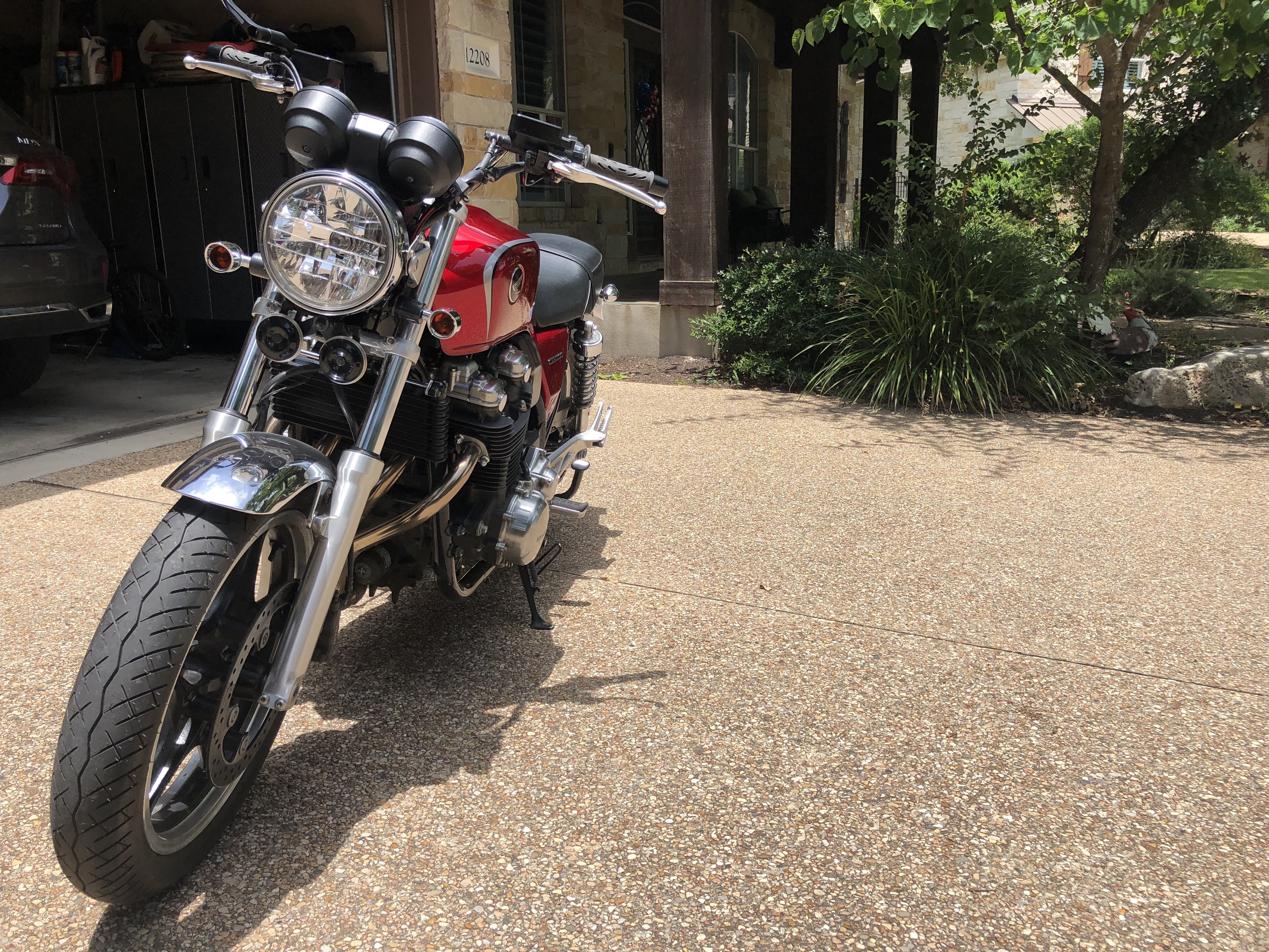

Naturally I didn't get any good photos of us putting the new bars in place as we were moving pretty quickly at that point (except for jamming all those little bits in the ends) but here's the final product! Stock bars!
My seating position now is WAY more comfortable and I feel really confident in moving the motorcycle around, whereas before I felt really unbalanced.
