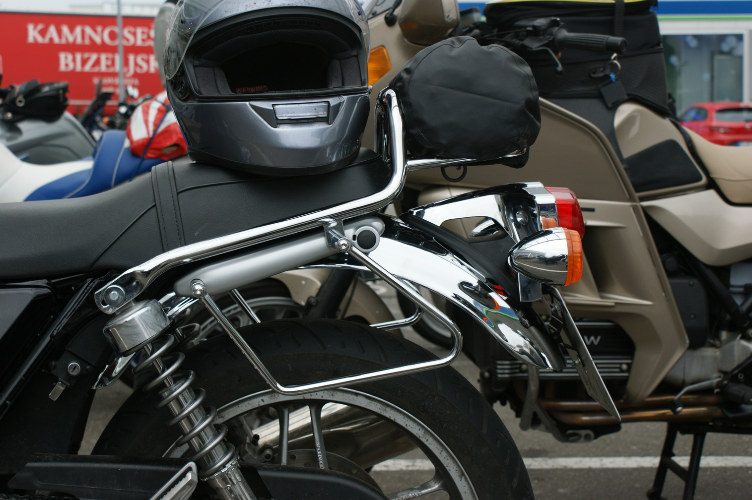

I cut the cables and soldered a cable extension. That was the only way, to get'em thru the funnel in the fender.
[Image: 89ae9cfb0c7f2c613ac92245d5322932.jpg]
[Image: 9111e489b2658e13889c64d54a9b921d.jpg]

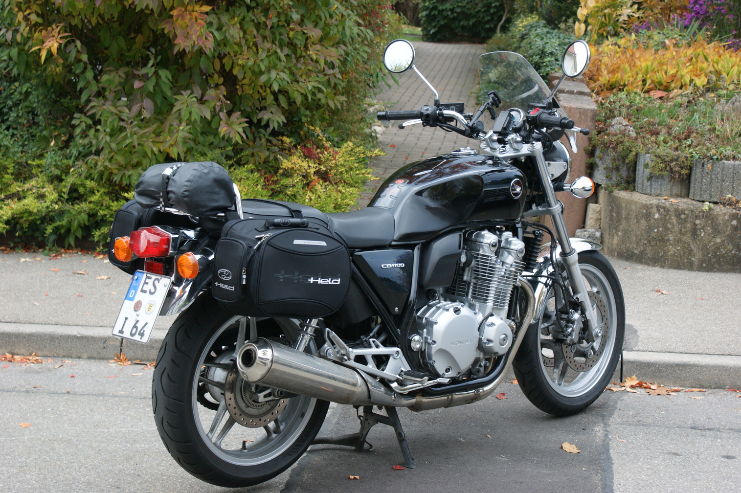

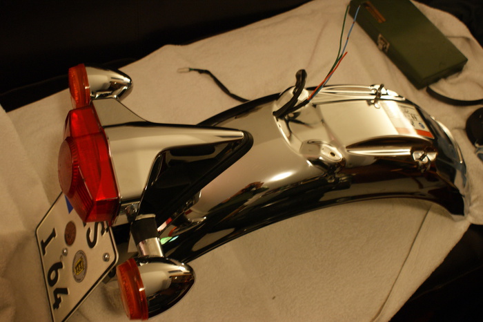

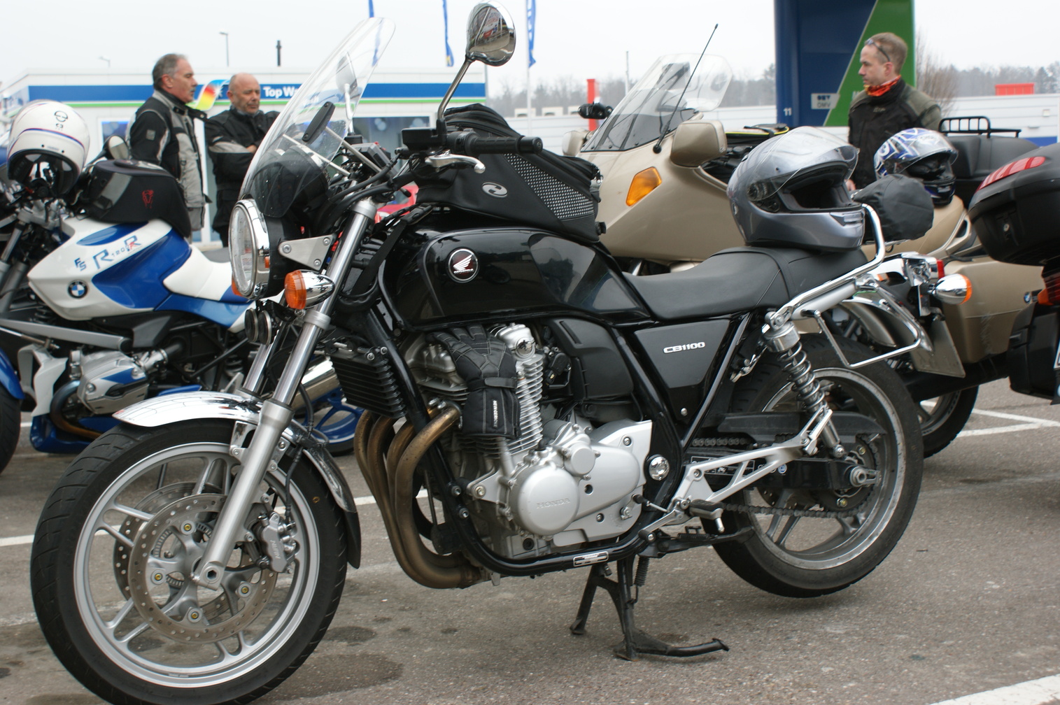

Well, looked hard but did not found that close photos. Here the best I got:
[Image: a5df1246cf33f854eb95f38ac692fcf0.jpg]
[Image: dad5f58be253efb8bdf6b9bf512422b6.jpg]
[Image: 2c2bf1ed6a7a40c09cedcb10ee3009ce.jpg]
[Image: fdae7af179c697da7a5e30e7063e65b0.jpg]
The clamp has the form of a U is mounted using the bolts of the tail light.
It comes with the baggage holder from Fehling.
Here's their homepage, search for '1100':
[url=https://www.fehling.de/index.php?content=preise&markenid=6&lang=eng]https://www.fehling.de/index.php?content...6&lang=eng
