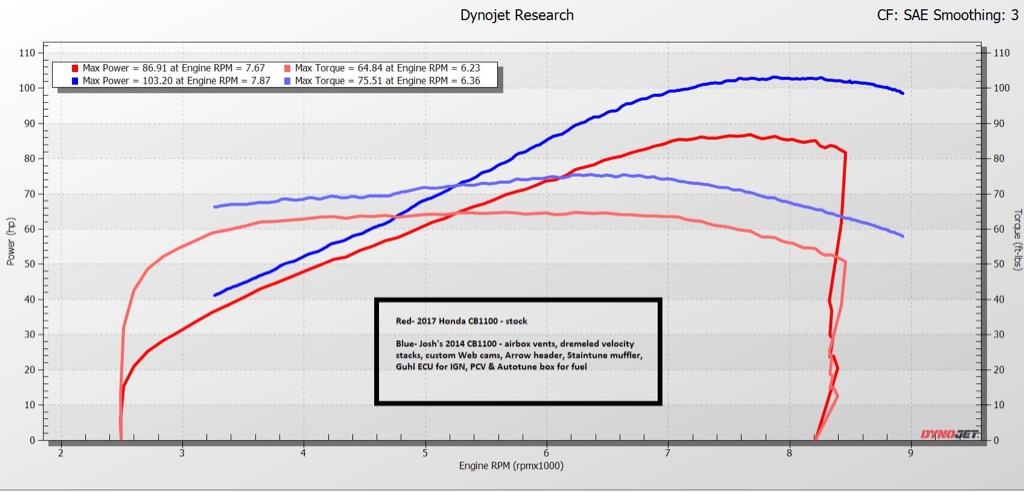

Yea. Last dyno it made 103whp, and over 75 wheel tq.
Here is an overlay to give a rough idea compared to a stock bike.
You can see as you rev it out- she really starts to move.
[Image: 1f5057761d0634763afc091828a1de1b.jpg]
The across-the-range flat power delivery is repressed?
Nice Gains!
What all did you do?
How does it feel when riding?

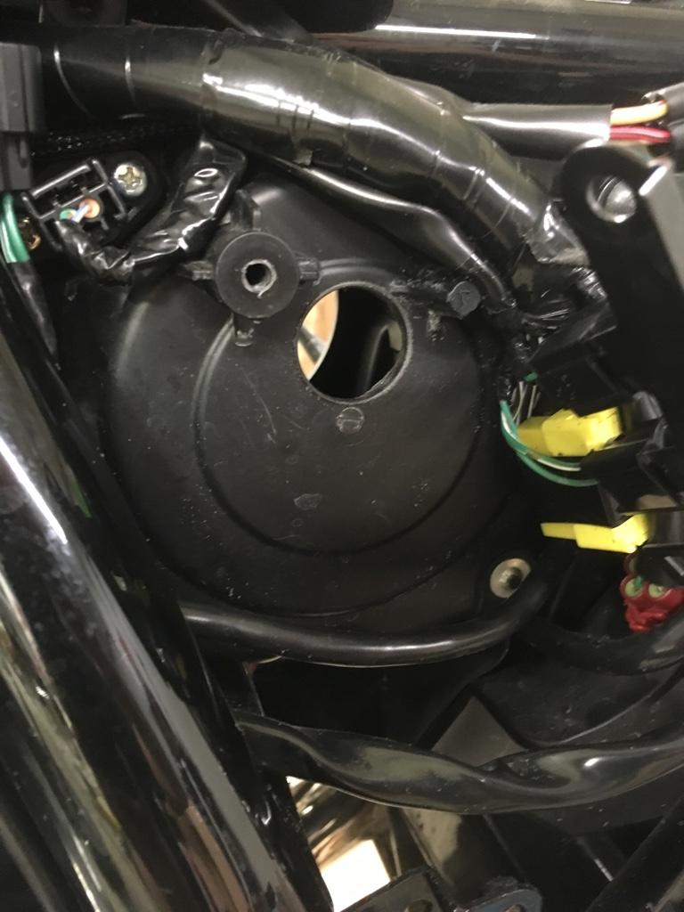

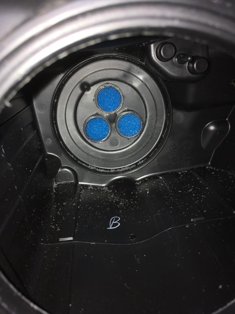

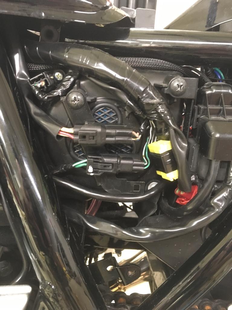

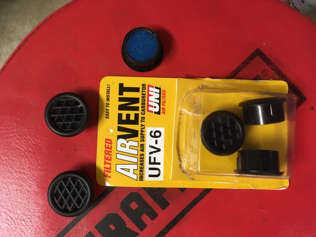

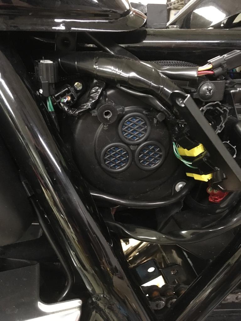

Added some unifilter airbox vents, bored out the plastic velocity stacks, had custom cams made, full exhaust, fuel and ign adjusted.
Feels the same as stock, until you get on the throttle.
It's not going to change the 'mood' or demeanor of the bike even then- just wakes it up and pulls harder.

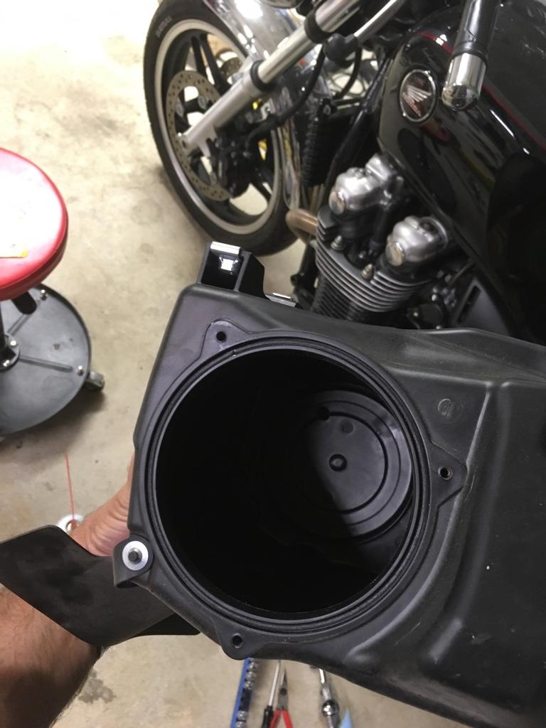

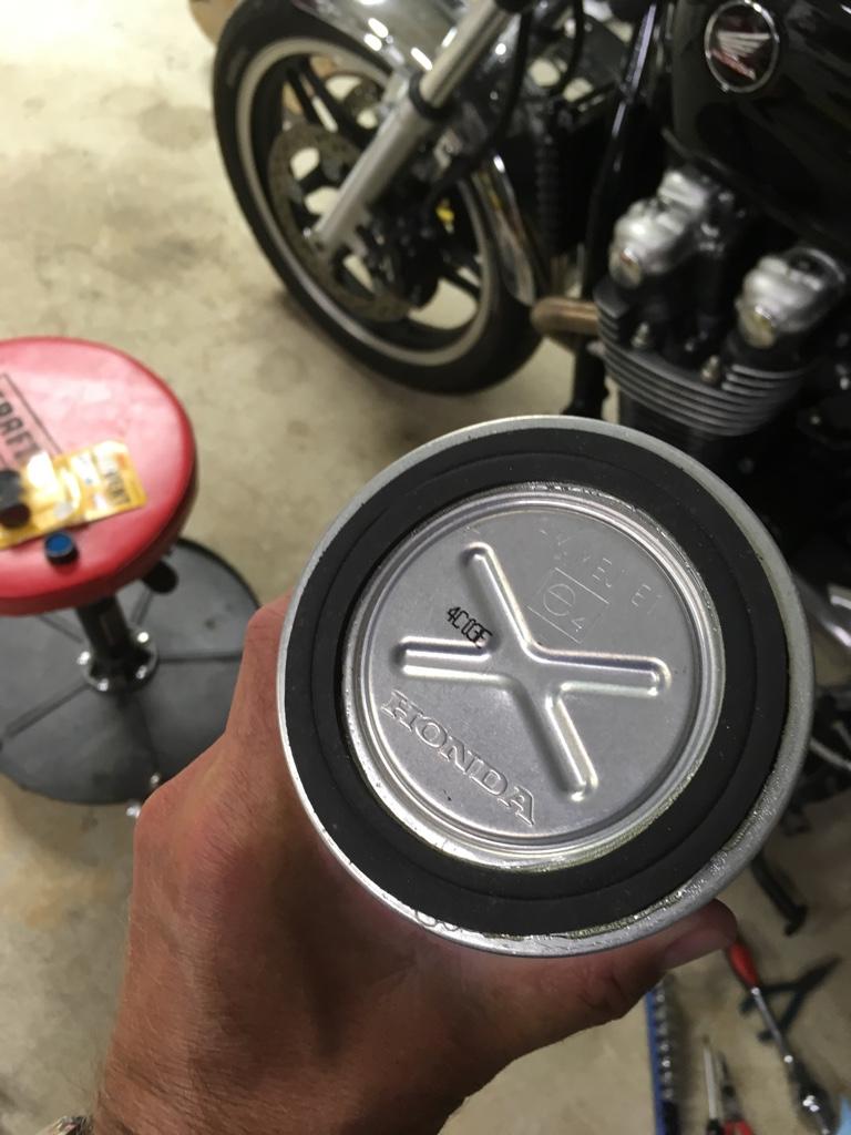

Do the unifilter vents eliminate the need for the air filter in the stock location?
I use a K&N now...
No.
I am just letting more air into the filter, without the additional noise removing the stock snorkel and adding the TSR plate makes.
The closed end of the stock air filter has a gasket and pushes against the air box.
So- cut out the metal portion inside the gasket, and open up that side of the airbox = more airflow, add fuel = more power.
I chose to put filters in, not because they are needed- but it is cleaner than just a hole and I used to use these on dirtbikes and quads when I was a kid.

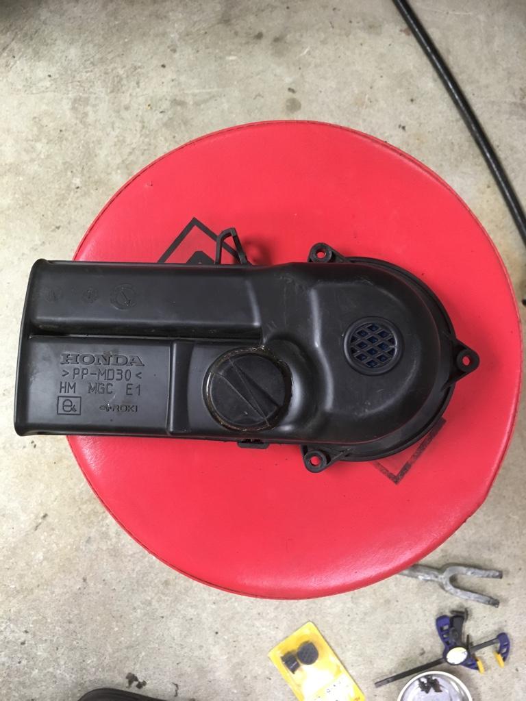

I threw one in the snorkel bowl for fun as well-
