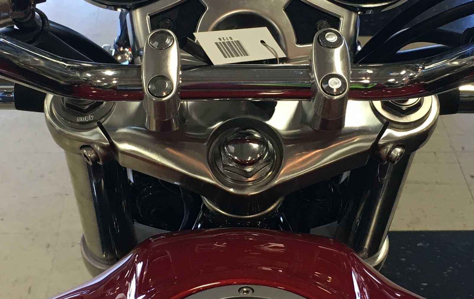

Best pic I have of the fork caps, taken on Saturday at a dealer.
[Image: 53a3bbc7c6e5046a2a16e6ca3f566ec8.jpg]
