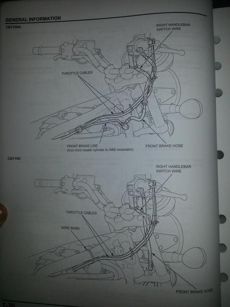

#66
These show the differences between the std and the ABS models for the brake routing.
[Image: d3bd3145f9f0bd007918c127a78d02fa.jpg]
[Image: 3c8d12c53cac74bb4e168eb30761fd54.jpg]
[Image: b268e516348f66692fd04e8138cb2f6b.jpg]
[Image: a7755dd40094636f99f2a4932fb3ead1.jpg]
[Image: 53f8ab41dcbfa6b69cba1b0d46864321.jpg]
[Image: ecfd46d28dcc39551c18ae2611bdf423.jpg]
