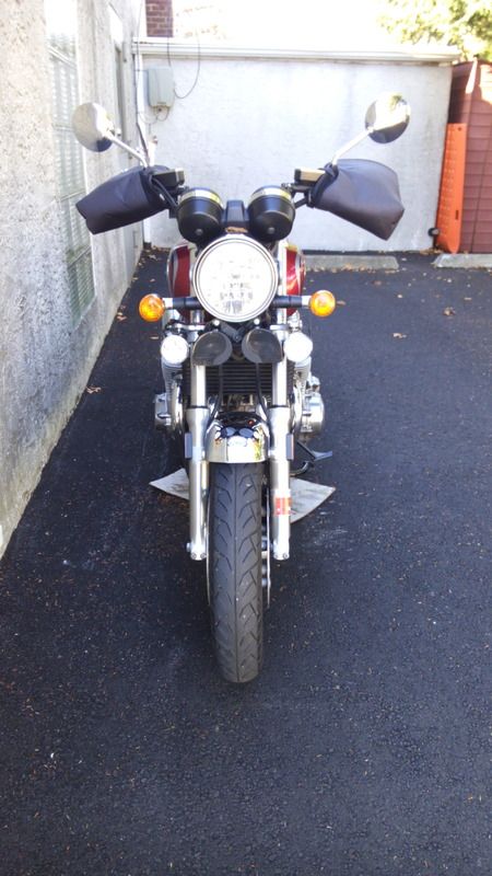

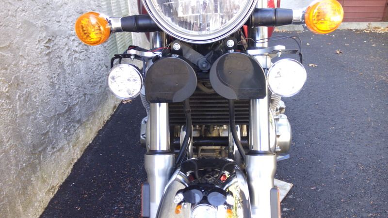

DJS_imp Offline
Posts: 235
Threads: 18
Joined: Mar 2015
RE: Horn Relocation
(11-29-2015, 04:50 PM)EarsOnWheels_imp Wrote: Who else has replaced their horn? Any good (louder) options that can be put in the same place as the stock horns using the existing wiring?
PIAA Sports Horn 85114 Sportshorn Slim Line Kit 400Hz 500Hz 112 Db
http://www.motorcycleconsumernews-digita...pg=28#pg28
[url=http://smg.photobucket.com/user/djs_151/media/cb1100/IMG_20151130_102643_zpsaxowxra0.jpg.html][Image: 325f805726413fb8c3fadd8dc02e4c48.jpg]
[url=http://smg.photobucket.com/user/djs_151/media/cb1100/IMG_20151130_102649_zps0ls3er52.jpg.html][Image: 5df9e208b94db0d2ded883d1d41b0c83.jpg]
11-30-2015, 01:44 AM
