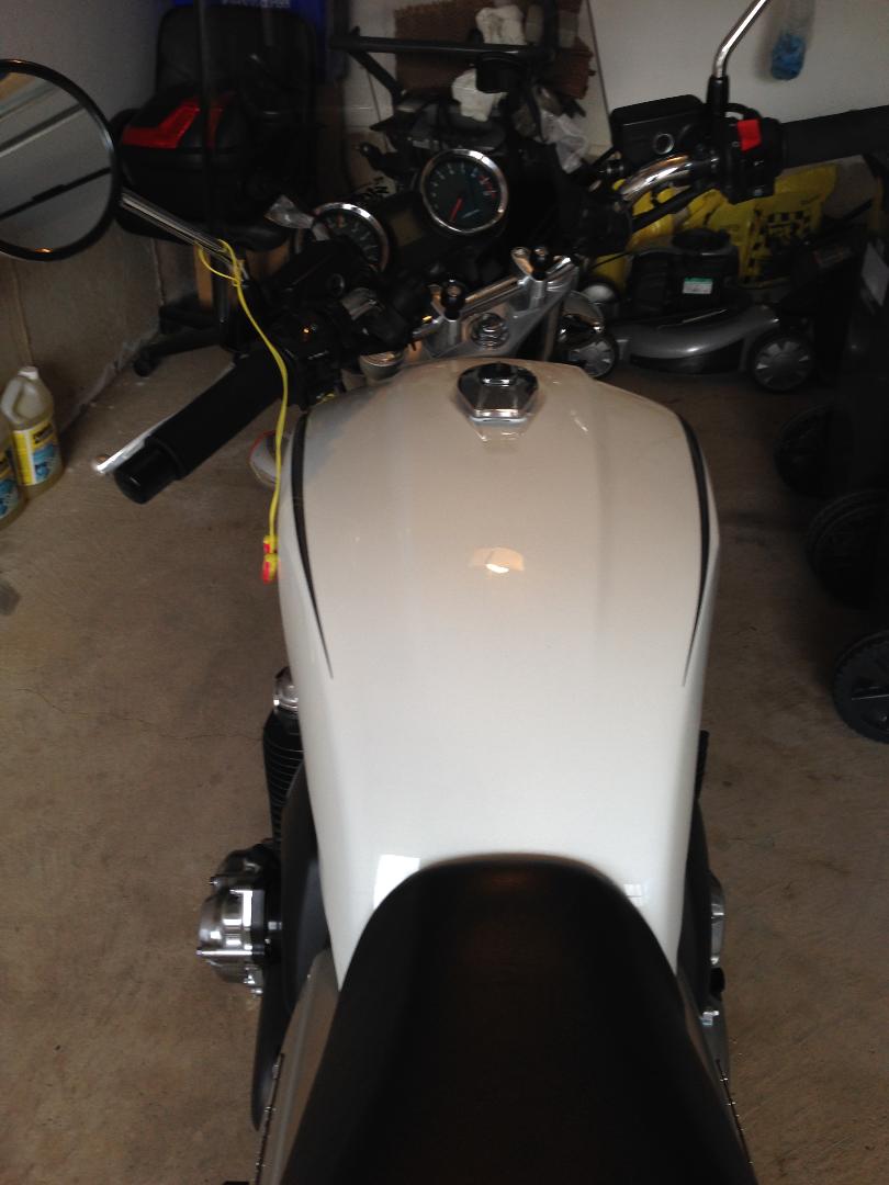

[Image: a10f338dba44a6c6e5c572cd629b2168.jpg]
14.6L
[Image: 687ecfcfa58f7ce1a73c6bd84195e8dd.jpg]
'14 model with 16.8L from Samurider/Mr.Takashi
[Image: dec7d437d6982fcf09db4f62298c7a0e.jpg]
for comparison, 14.6L and installed 16.8L
More kms/300+, without stopping and refuelling!!
