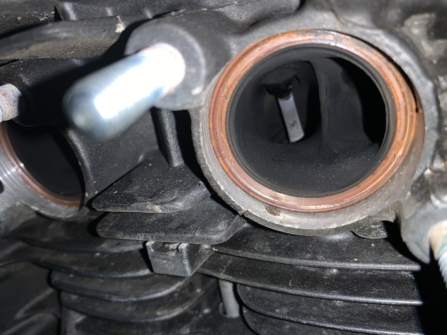

2) There appears to me to be a stock copper gasket in the exhaust manifold output ports where the headers were, because it looks copper colored to me. Was uncertain if I should dig it out, or it was rust, but believe they are copper washers and should come out. Then I replace with the supplied Delkevic crush washers that will seal during the final torquing of the header nut caps. Confirm?

Now I am pretty sure I am supposed to dig out those (what looks to me like) stock exhaust crush washers.
Am looking for some confidence before I get them out, and hopefully without scratching the ports. Any handy tips on that would be appreciated.

I am thinking if you don't remove (presumably) the stock ones, the new crush might not properly seal, and the system would be 2mm or so too far forward.

Easy to get the old gaskets out with "dentists " pick , set of them are cheap but very handy , they have different types in the set.

(08-25-2020, 02:28 AM)Houtman_imp Wrote: Easy to get the old gaskets out with "dentists " pick , set of them are cheap but very handy , they have different types in the set.
I have those picks. So you agree those need to come out then.

Yes, they have to come out ,never leave old gaskets in before you put new ones in.
