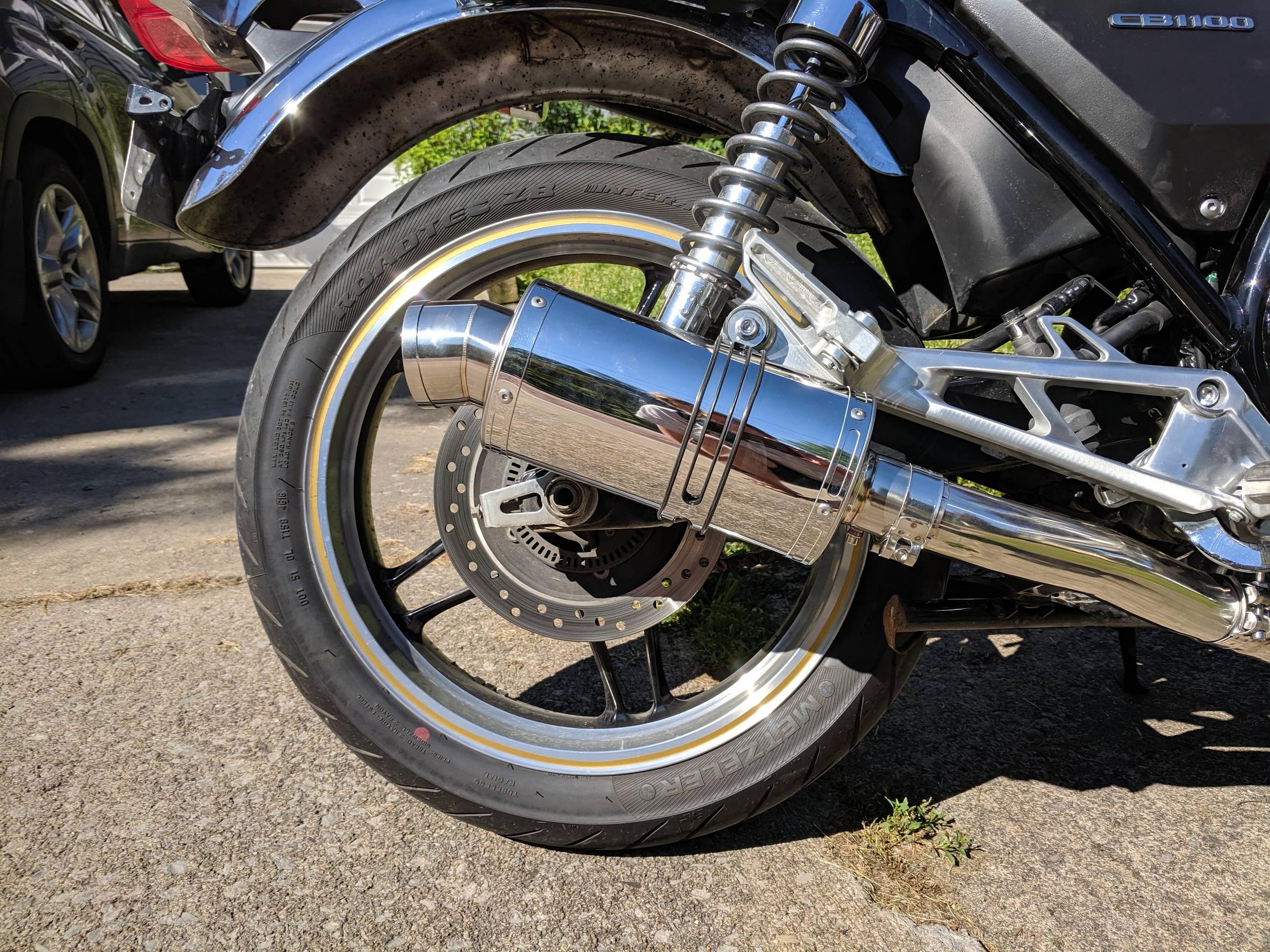

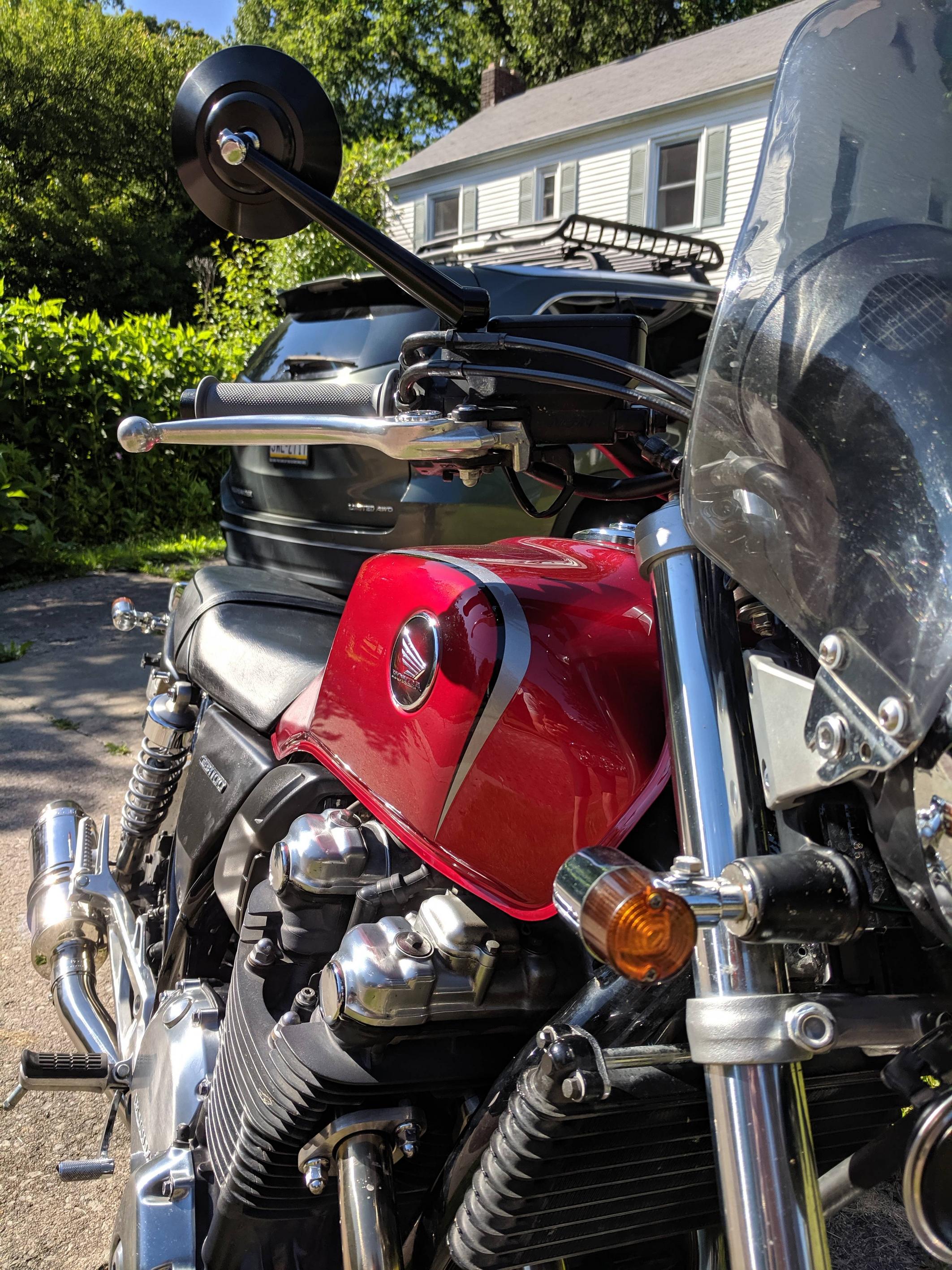

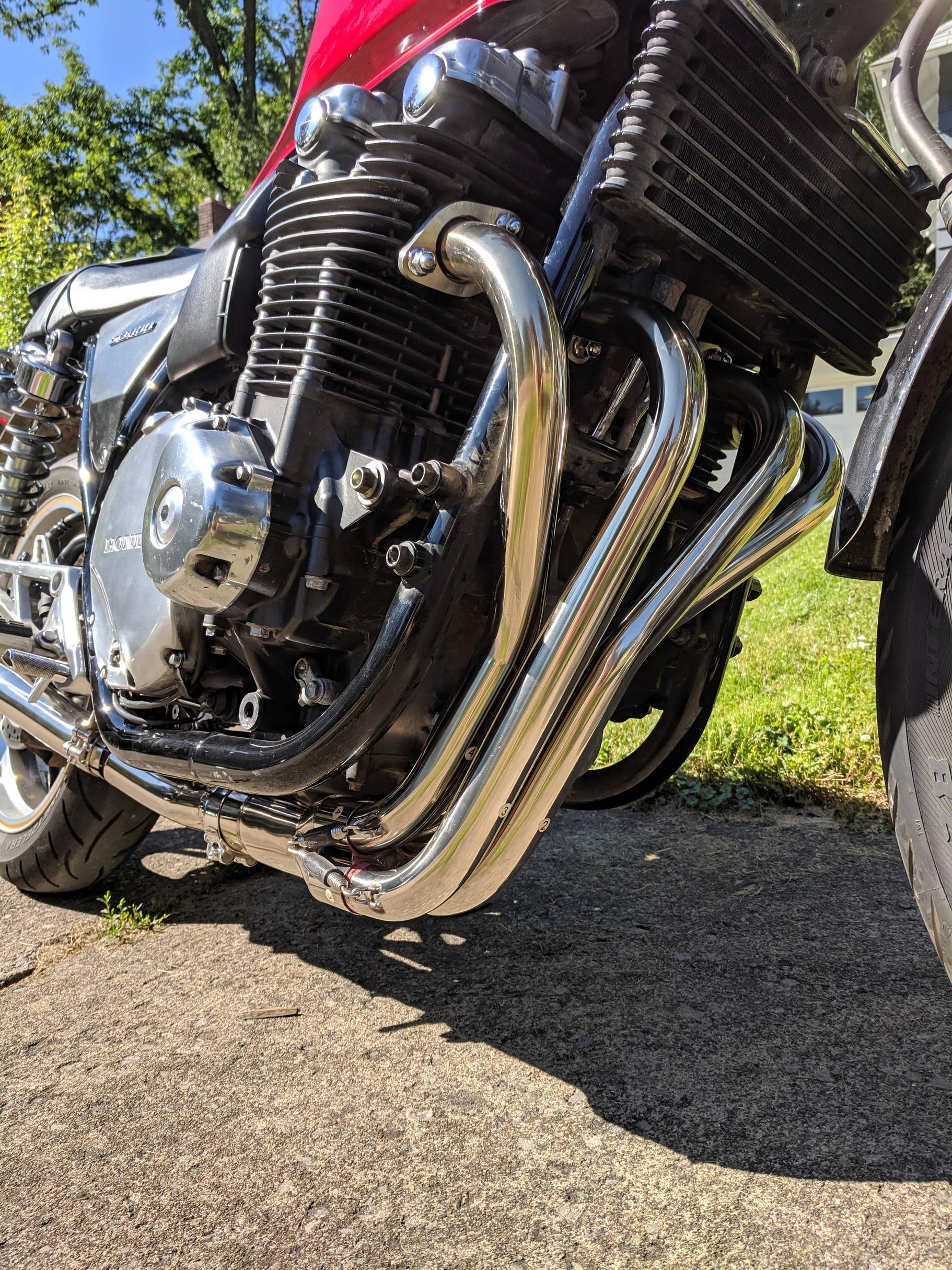

Hi all!
I spent a few hours today installing a Delkevic 9" muffler and stainless exhaust. I also fitted some new mirrors, a milled oil cap from a fellow member, and plasti-dipped panels.
I'm going to do a full frame re-paint, tank re-paint and spoked wheels next year, so I decided to go ahead with some simple mods to see what I like.
If anyone wants links, I'm happy to post them. I can also make some videos of the new pipes and how they sound.
A quick review:
Pros
- Deeper sound at idle, but not too loud
- Amazing upper-end howl
- Competitive price
- Superb fit and finish
- Easy installation (at least once I made a 17mm O2 sensor tool from a husky wrench)
Cons
- No instructions in the box
- Maybe a few too many pops on deceleration
In anticipation of new wheels next year, I did a (terrible) gold rim tape to see if I liked it.
I've also got a Renthal bar, Renthal grips, Emgo windshield and a couple of other bits. Anyway, on to photos.
Let me know if you want videos to hear the new setup! I'd also be happy to show folks how to make a simple O2 sensor tool or do a tutorial on the whole process. I made mistakes that are easy to rectify if you know what to do.
[Image: ec5582040a04d99414eaacb1b086797c.jpg]
[Image: e583963e596f87ea72dfcf247421652a.jpg]
[Image: a6590ce3205cf671231b93cef35b766e.jpg]
[Image: b4019ce3a4fb6895b0c39940e26df78c.jpg]
[Image: a229049c61c5656356802e35d9ccdf4c.jpg]
[Image: fde04b1bd9be097bca3579f169b85a2d.jpg]
[Image: 8eeeaf9b5c173f083a3e3f20dfa75bd0.jpg]
[Image: 5373c392849c301cfd580e5514f3d0ac.jpg]
I should mention that with the O2 sensor reinstalled in the new collector, I've had no warning lights and no fueling issues. Delkevic really did their homework. This kit is insanely well done for the money.

Hi x(why)z! Plugging the air injection intake with a ball bearing or such should reduce or eliminate the popping. Remove left side cover, may need to lift rear of tank, remove rubber hose from front of air cleaner box, plug hose and reconnect. Not legal where applicable, blah, blah, blah...

Here's the original thread for the PAIR valve mod. By all reports, it should take care of your popping on deceleration.

looking great! it's good to see another delky out and about on the road. i went for the 8" round myself, but i didn't pair it with the delkevic headers, i used a set of titanium pipes instead.
are the delkevic headers cat free i wonder?
Also, on the Pros list, you forgot a very big one: superior weight. there's almost nothing on the market for our CB lighter than a short Delkevic.

Yes a video link would be great. Video never does a system/pipe justice but I can get an idea. Wish you would have put up a tutorial but I guess I'll let that slide. Do it by yourself or have a second pair of hands?

(06-25-2019, 11:02 AM)Ben70_imp Wrote: Hi x(why)z! Plugging the air injection intake with a ball bearing or such should reduce or eliminate the popping. Remove left side cover, may need to lift rear of tank, remove rubber hose from front of air cleaner box, plug hose and reconnect. Not legal where applicable, blah, blah, blah...
Nice looking mods!
Ben
Awesome tip. I'm going to look into this next weekend.
(06-25-2019, 11:27 AM)Flynrider_imp Wrote: Here's the original thread for the PAIR valve mod. By all reports, it should take care of your popping on deceleration.
http://cb1100forum.com/forum/showthread.php?tid=1824
Much appreciated!
(06-25-2019, 11:34 AM)misterprofessionality_imp Wrote: looking great! it's good to see another delky out and about on the road. i went for the 8" round myself, but i didn't pair it with the delkevic headers, i used a set of titanium pipes instead.
Yep, cat free, but they have the bung for the O2 sensor which I reinstalled after making a tool using a 17mm wrench.
And you're right! The weight difference was insane. And, I may have a miscalibrated butt dyno, but it felt like it had a few extra ponies.

And I can make a tutorial no problem. I learned a lot along the way. And I did it by myself in about an hour and twenty minutes from start to finish. I think it would be doable in half that if you knew what you were doing.
I just shot a short video, so I'll upload it. This weekend I'll try and find my gopro to really capture something on the road.
