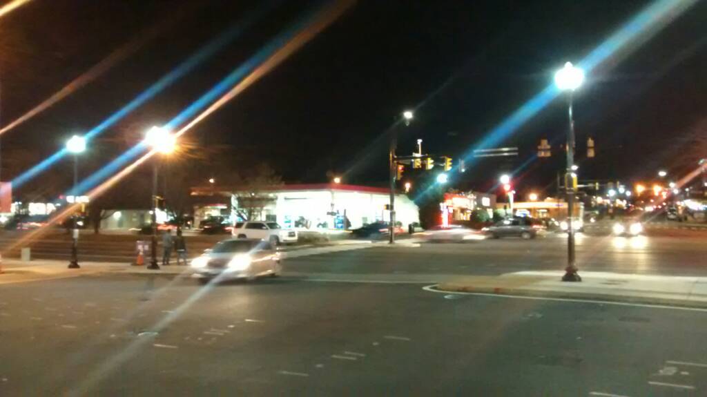

I only had some short trips to do around the DC, so I didn't stop to fill up the tank yesterday when the initial Estimated Miles Remaining came on. Still had 30+ miles left today, so I took the "long" way home and stopped to eat dinner in Crystal City. After dinner, the bike wouldn't start! Battery was still good, and the starter sounded good. I suspected the fuel because the estimated miles left had changed several times between yesterday and today. I tried rocking/tilting the bike to get fuel where it needed to be, but no luck.
I walked to the nearest gas station, got a container and a gallon of gas, and returned to successfully start the bike.
[Image: 4435e28f4c192126036dcbf9d6510063.jpg]
Big thank you to the attendant at the gas station at Rt. 1 and 23rd. He gave me a free gallon of gas *and* showed me how to open the surprisingly complex container.
