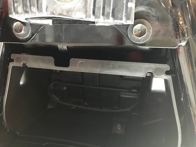

Taking out battery 1)Negative out 2)Positive out Putting it back in 1)Positive In 2)Negative In I woke up an hour early to check the thread and to redo the leds just Incase I put them in wrong, which I did . I’ll upload a pic shortly of what it looks like. I’ll also report in on the clicking sound . This is what I’m understanding Battery + Bike Cable + Tender Leads sit on top + screw So pretty much the same position as when I popped the seat off originally . Now I’m just removing the screws placing the “pigtail leads” on top and screwing back in. Thanks everyone!!! Ok, I'm back so I tried taking the negative off and checked for sound and it's there. So i'm just going to assume it's normal. I re did the pigtails and have attached some photos. I also forgot to ask, for the tool compartment basket is it supposed to be flush when I put it back in? I forgot to take a before photo to see how it was originally. When I placed it back, I just sort of screwed it in place and popped the button in. Looks kind of weird with a gap but I'm not sure if this is right lol. how I wired it the first time how I wired it this morning (revised) how the bucket looks when screwed in ( has gap ) a better pic of the gapthanks everyone .
04-30-2018, 05:38 AM
It looks to me like it is forced into position so you could get the fasteners installed. Hard to tell, but it may be hung up on the cables on the positive fastener. Pull the tool holder back out and see what you have. May have to move some terminals around or maybe a cable is in the way.
