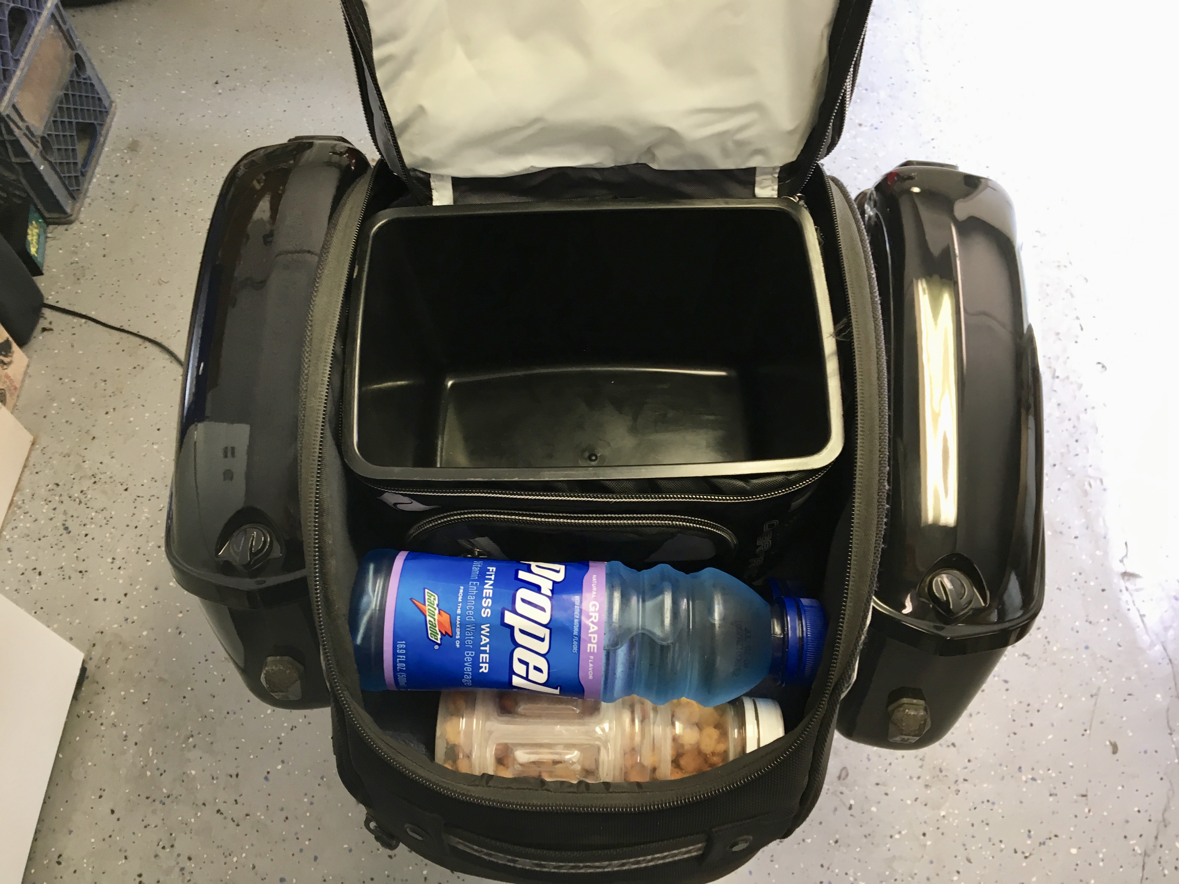

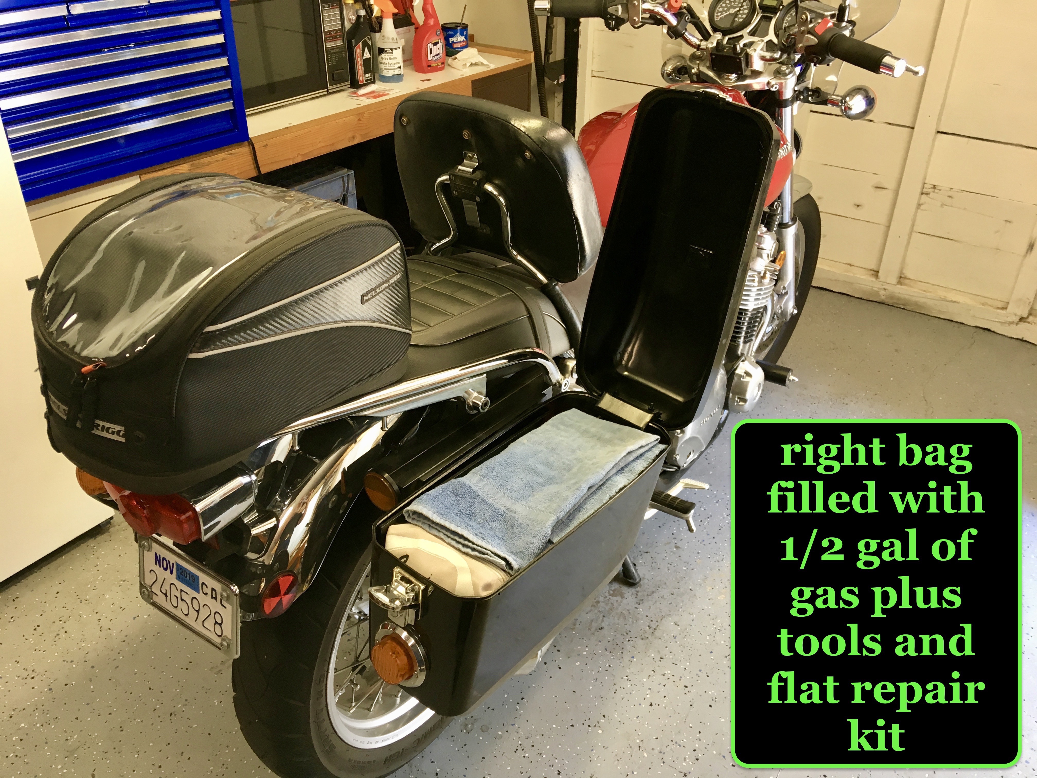

thanks for the compliment pd.. I am just a day tripper.. max was 500mi most are 150 or 200.. but isn't that always a bikers dream, to just get on it and go .. I would have plenty of room to store stuff behind my riders backrest and in front of my tailbag ..plus the hard bag storage of course..

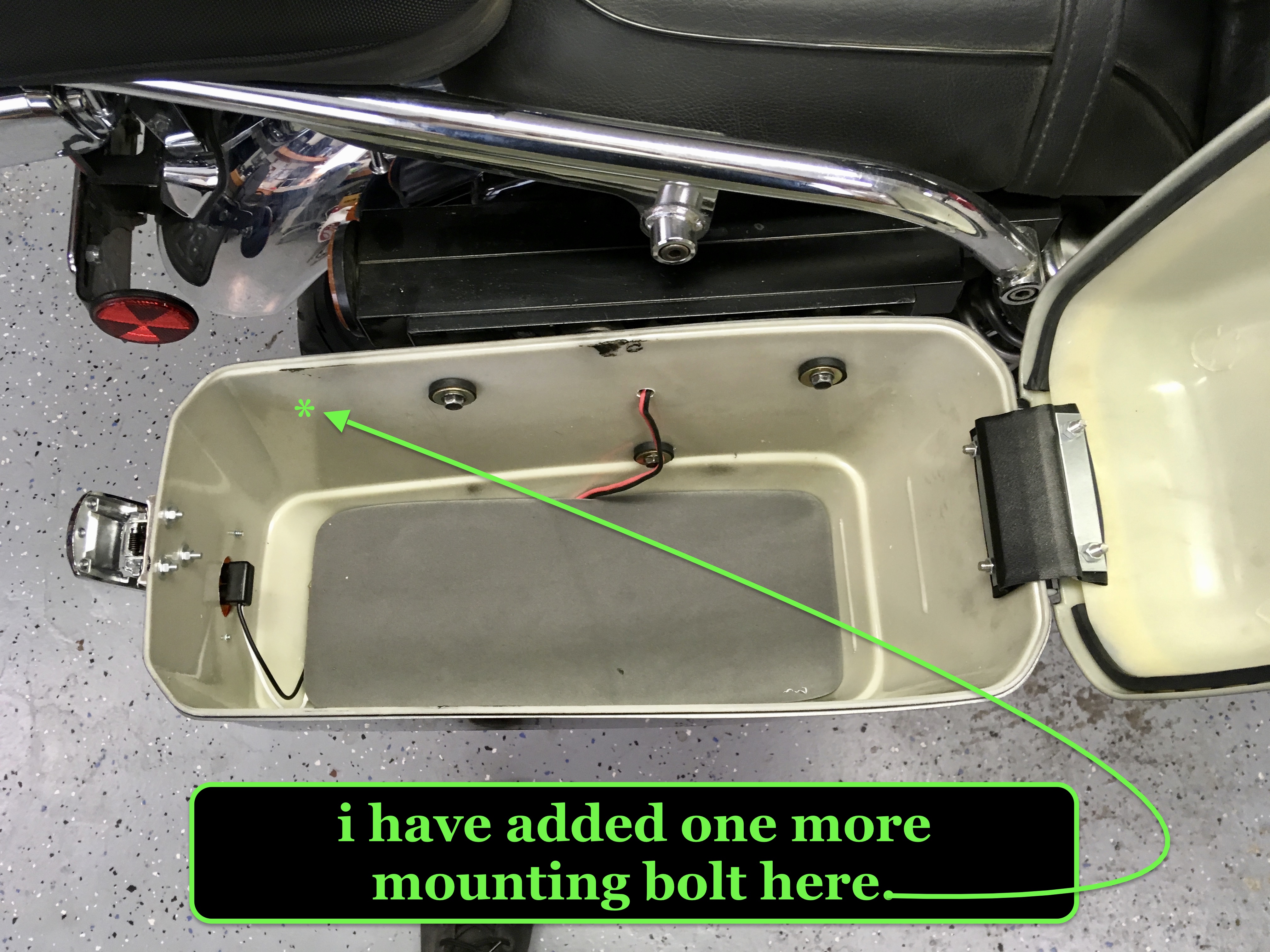

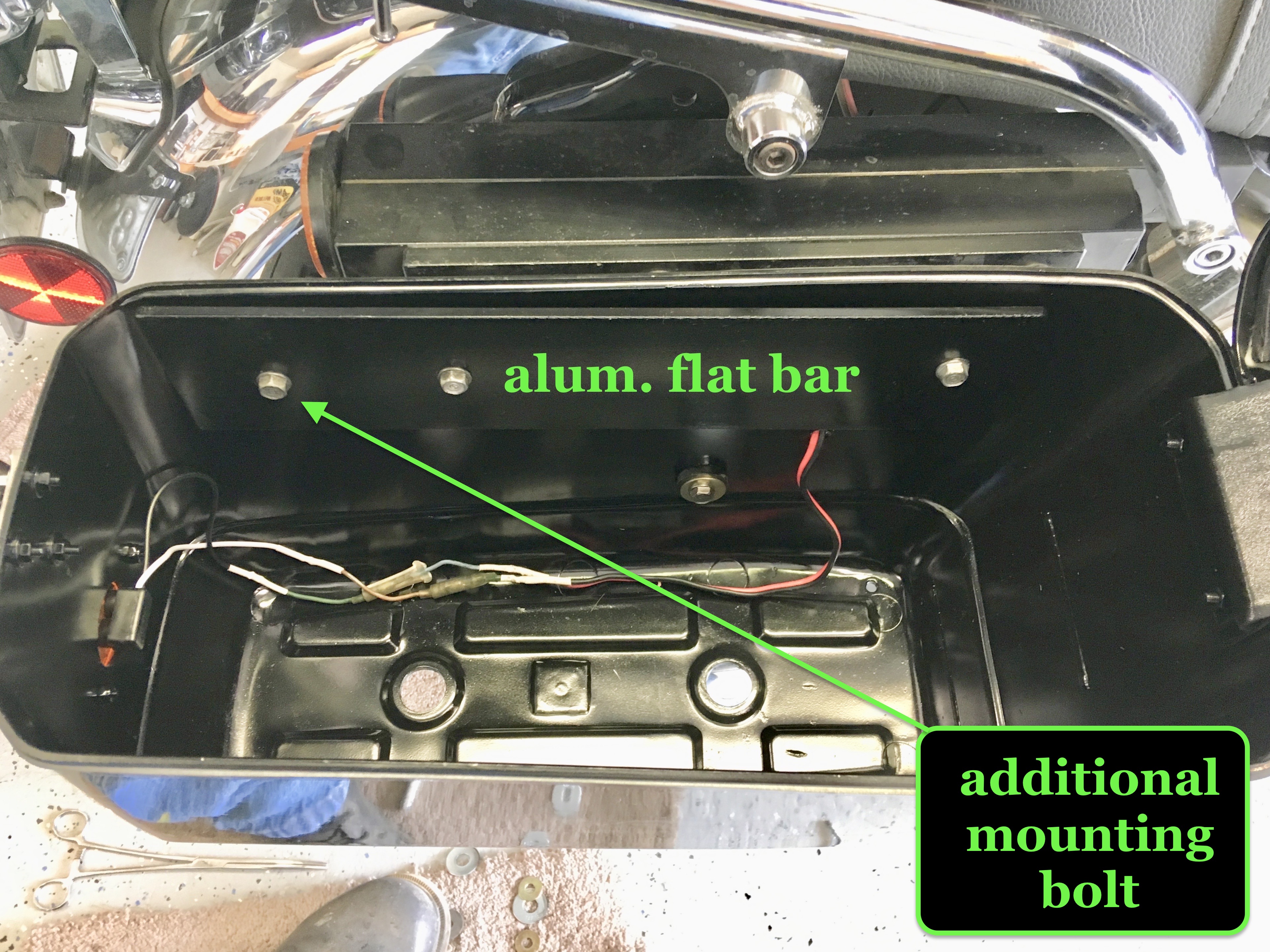

the pic of the tailbag shows my first hard bags.. they were too narrow for the things I wanted to store.. those larger hard bags were pretty cheap, like $65. for the pair including hardware.. but they must have been a close out.. for that price, I was tempted to buy a second pair, but they were all gone.. I did add a little reinforcement in them, just to be safe.. they are holding up well ..

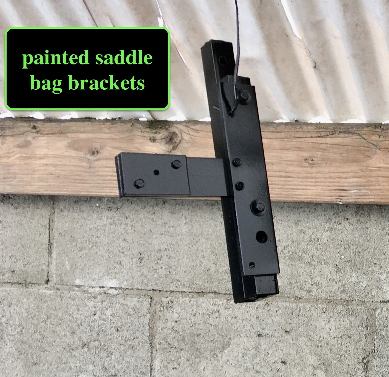

Chuckk,

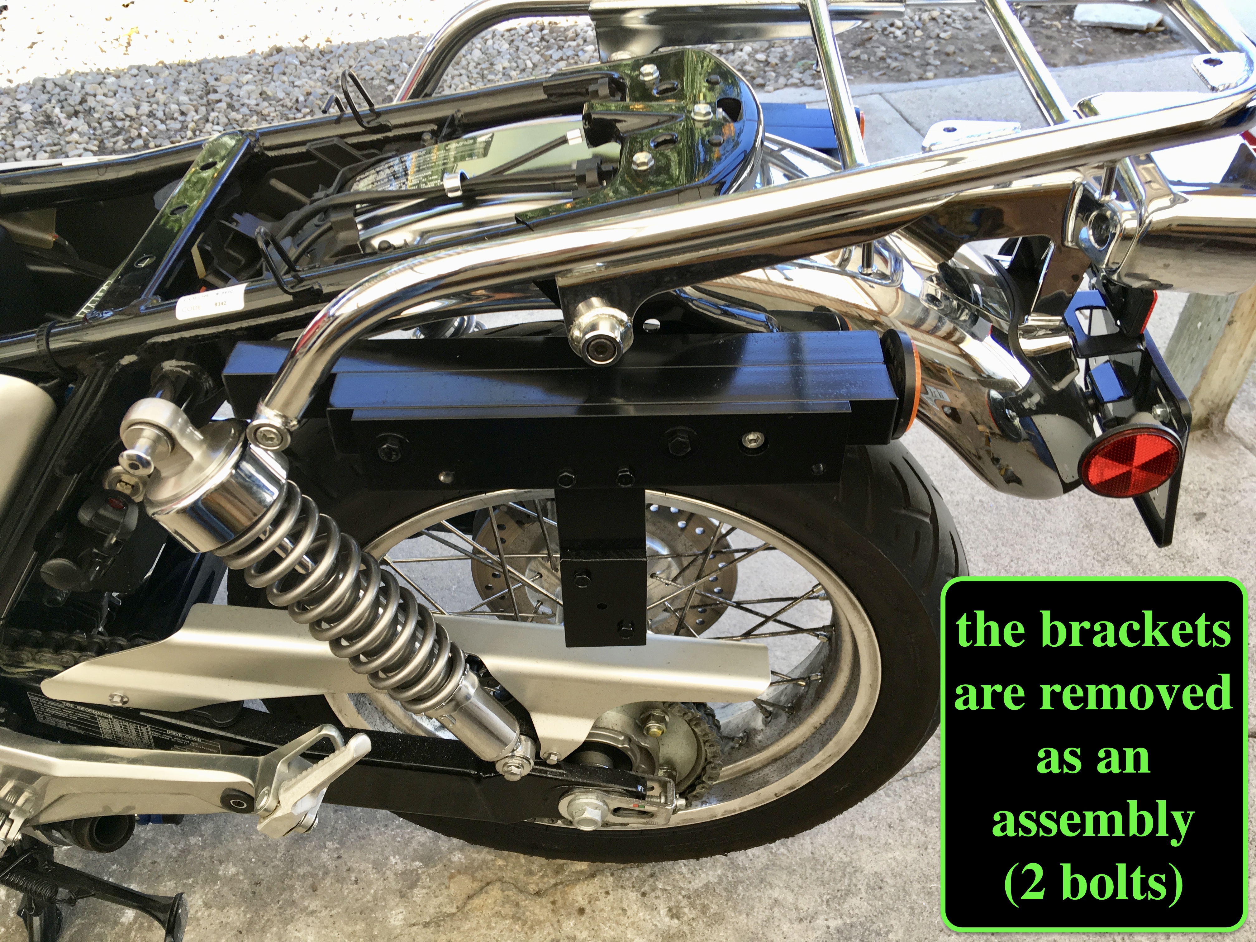

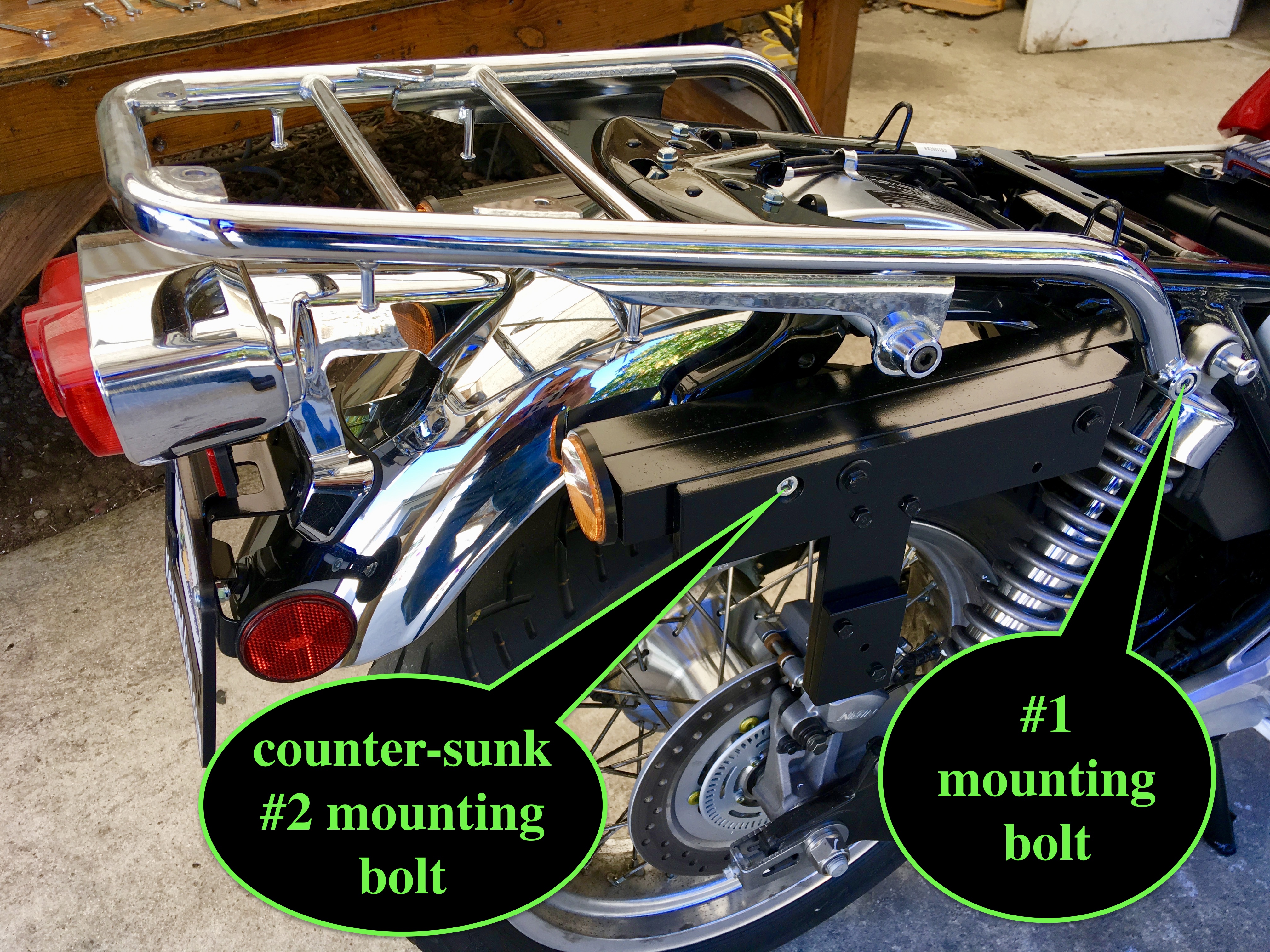

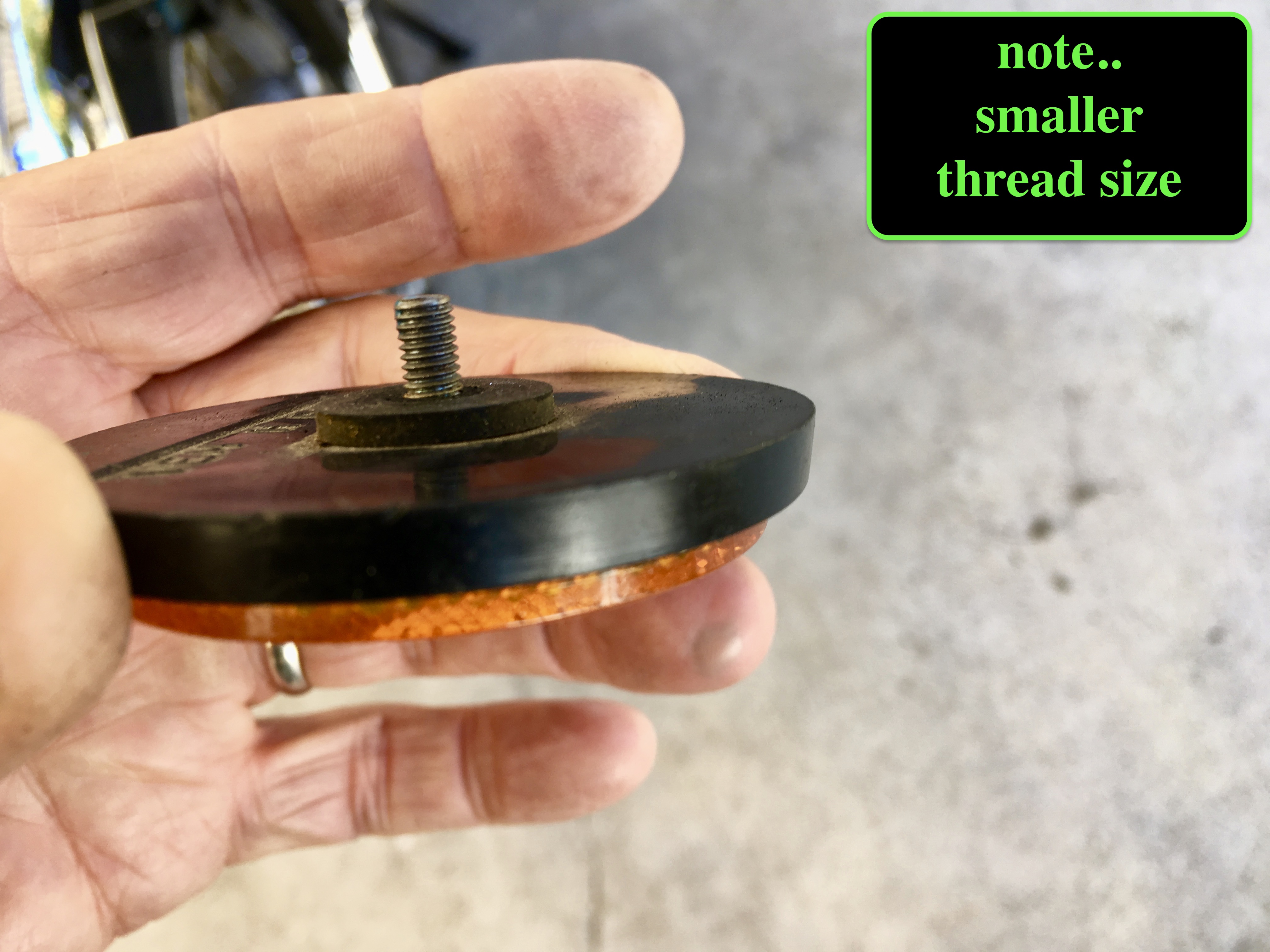

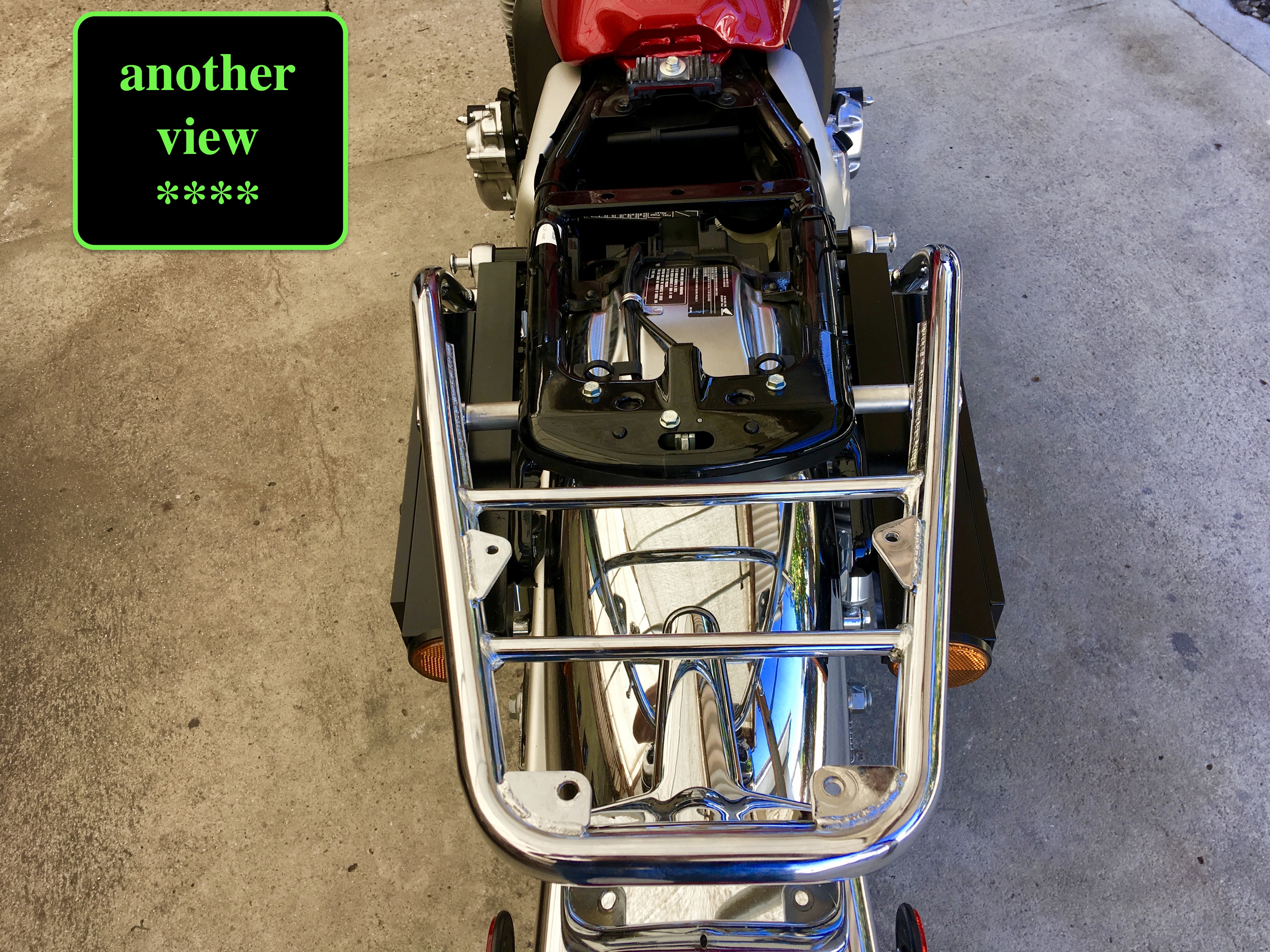

REALLY like your hard panniers -- they look like they belong there! Moving the turn signals onto the bags frees up positioning them a lot. Where did you find the cases and what kind of rack system are you using to mount them?
Not to derail the 2020 thread... you could post a separate thread on your setup - I would sure be interested as might others.

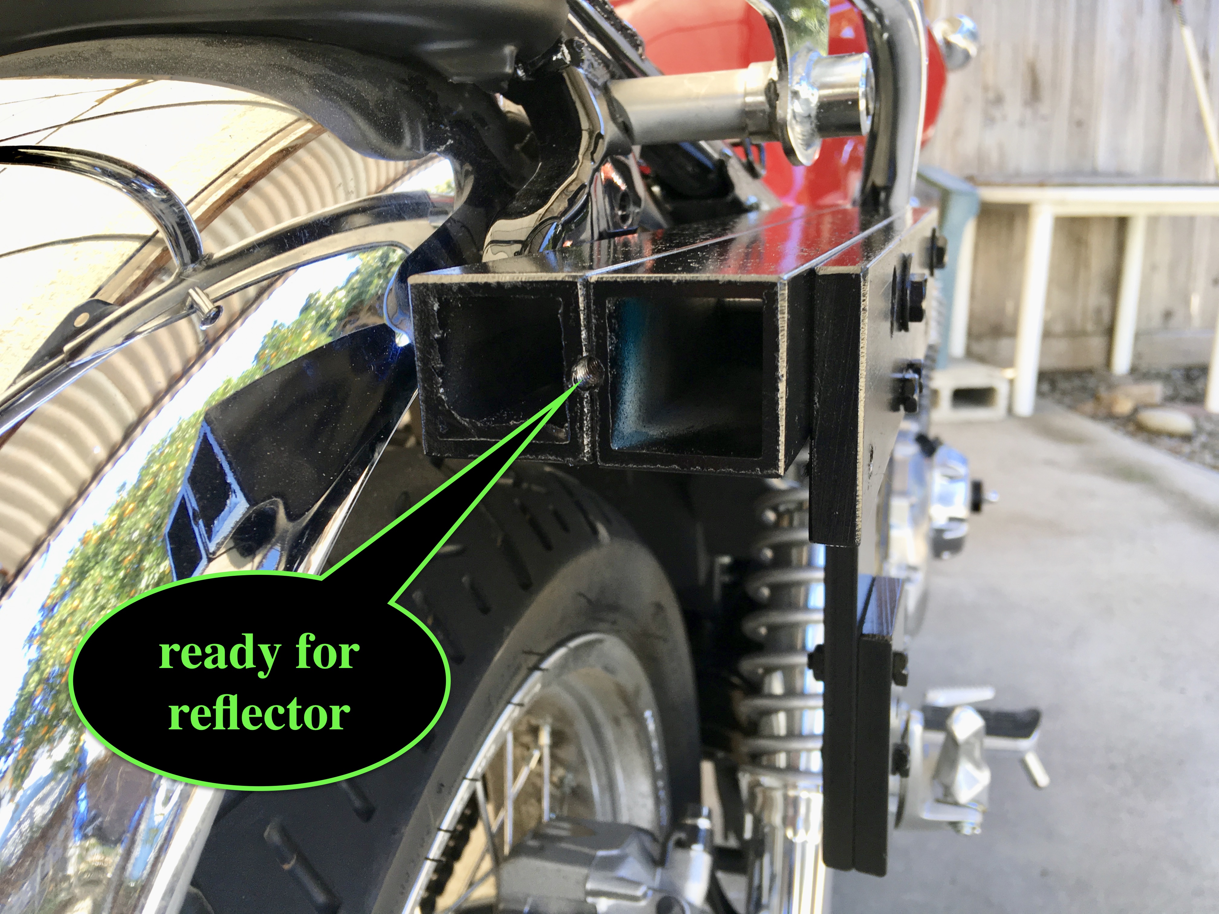

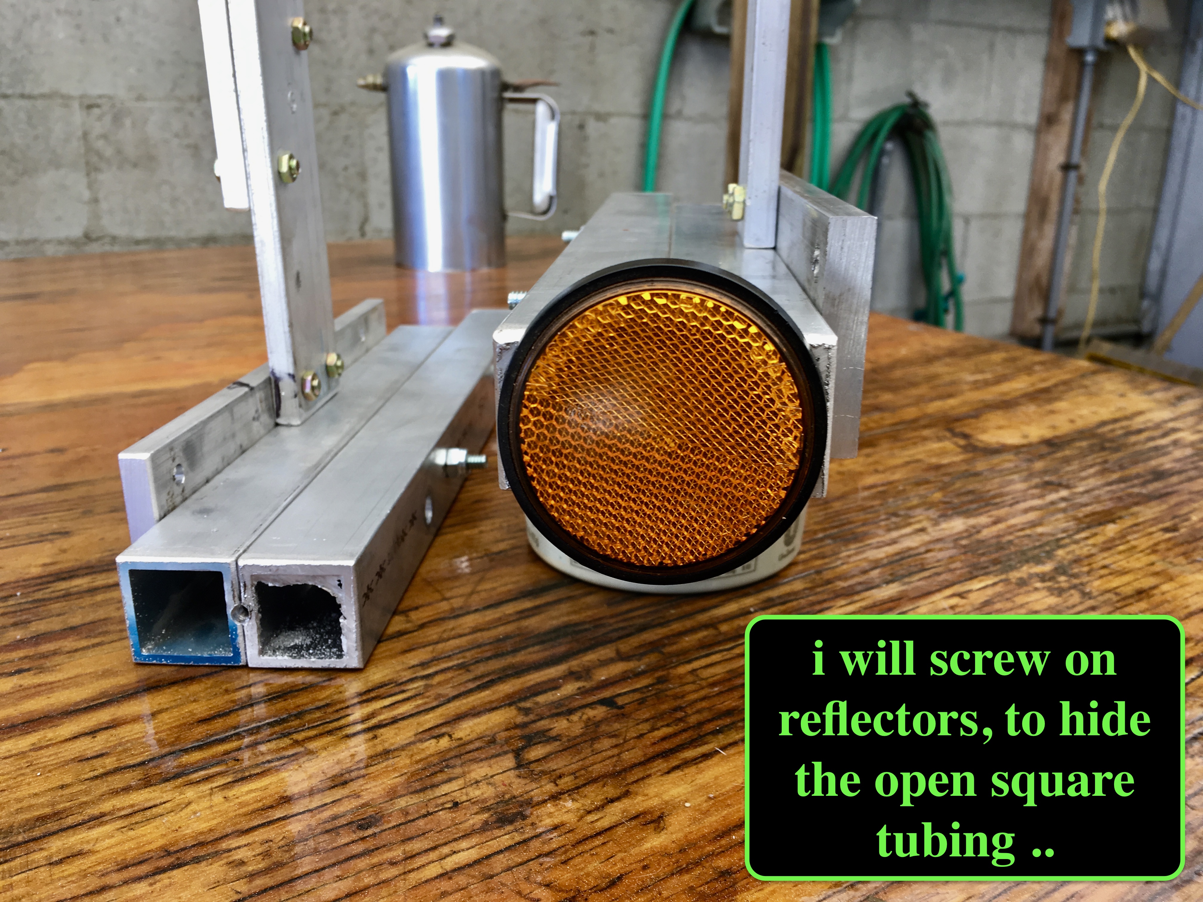

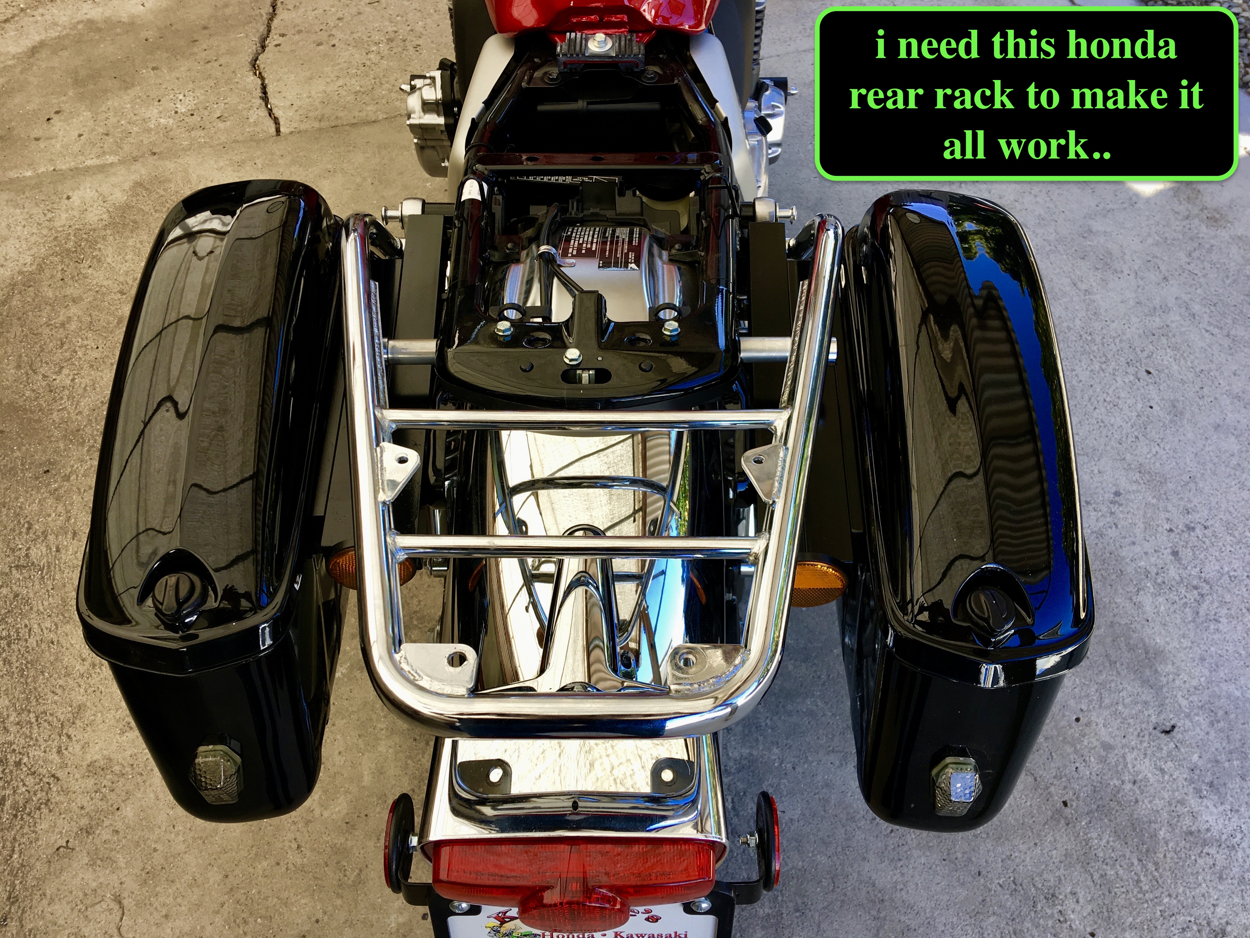

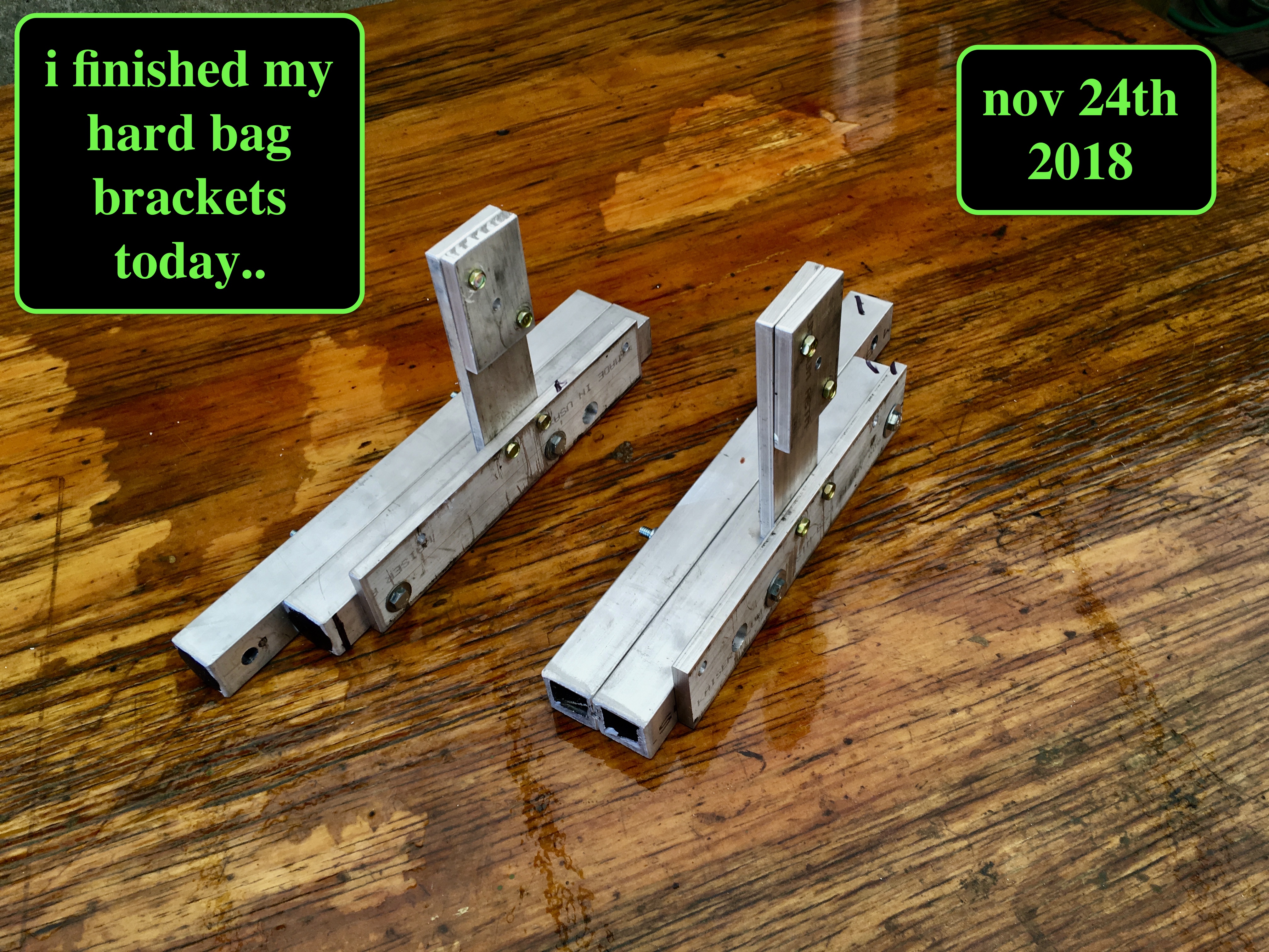

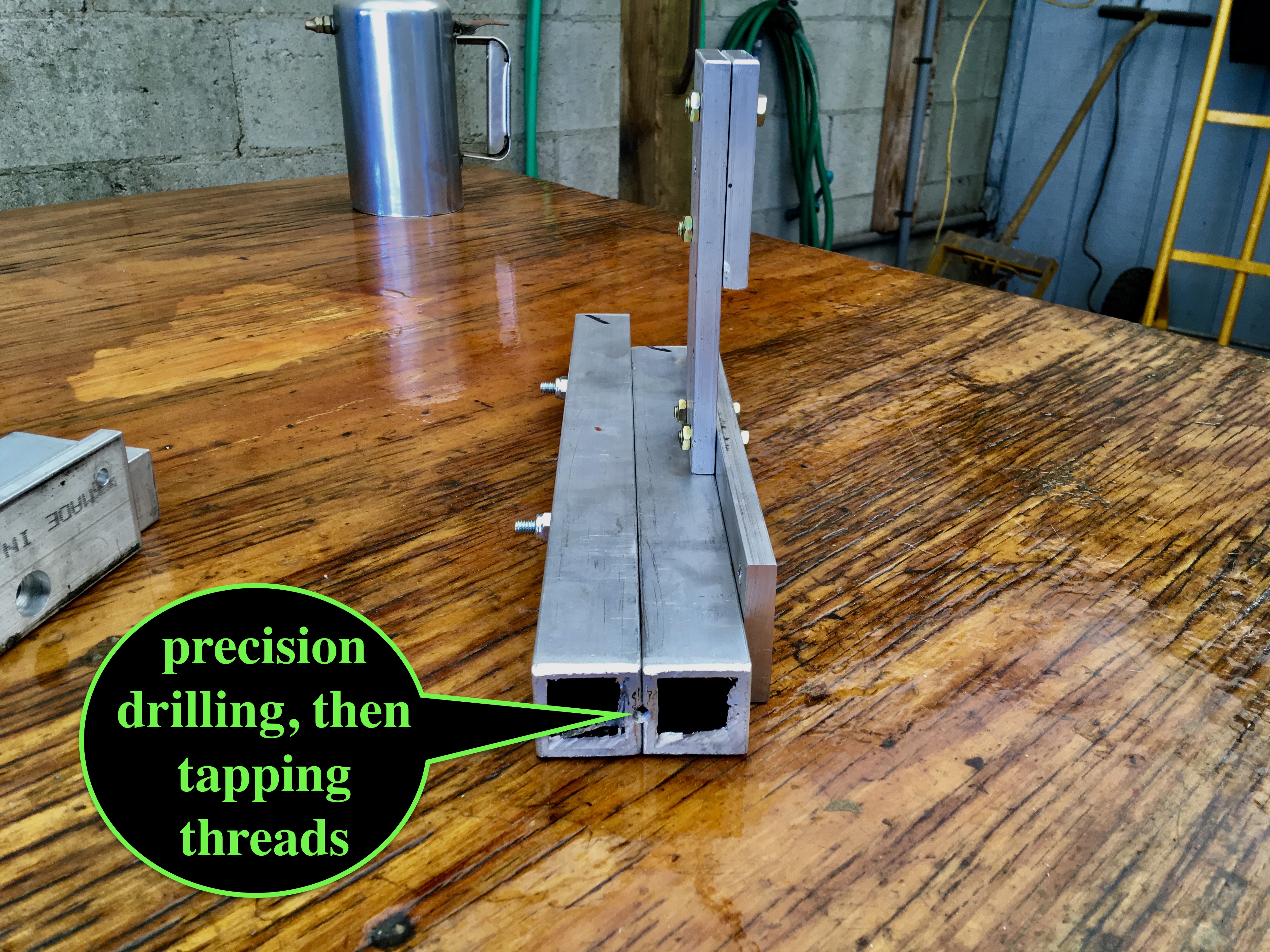

pics are worth a thousand words.. making the brackets was the challenging part.. I wanted them to be tucked in as much as possible..I may have posted some of these before.. my bags are 26L ..

I bought the cases on eBay .. hard to find the 26L ones now it seems.. the ones that are offered are a little larger.. they still might work though.. I have mentioned this before, the narrow bags taught me a lesson.. I had to use a key, every time I wanted in to the bags.. the 26L ones I have now have lockable latches, but one doesn't need to lock them if they don't need to.. something to remember when purchasing hard bags..

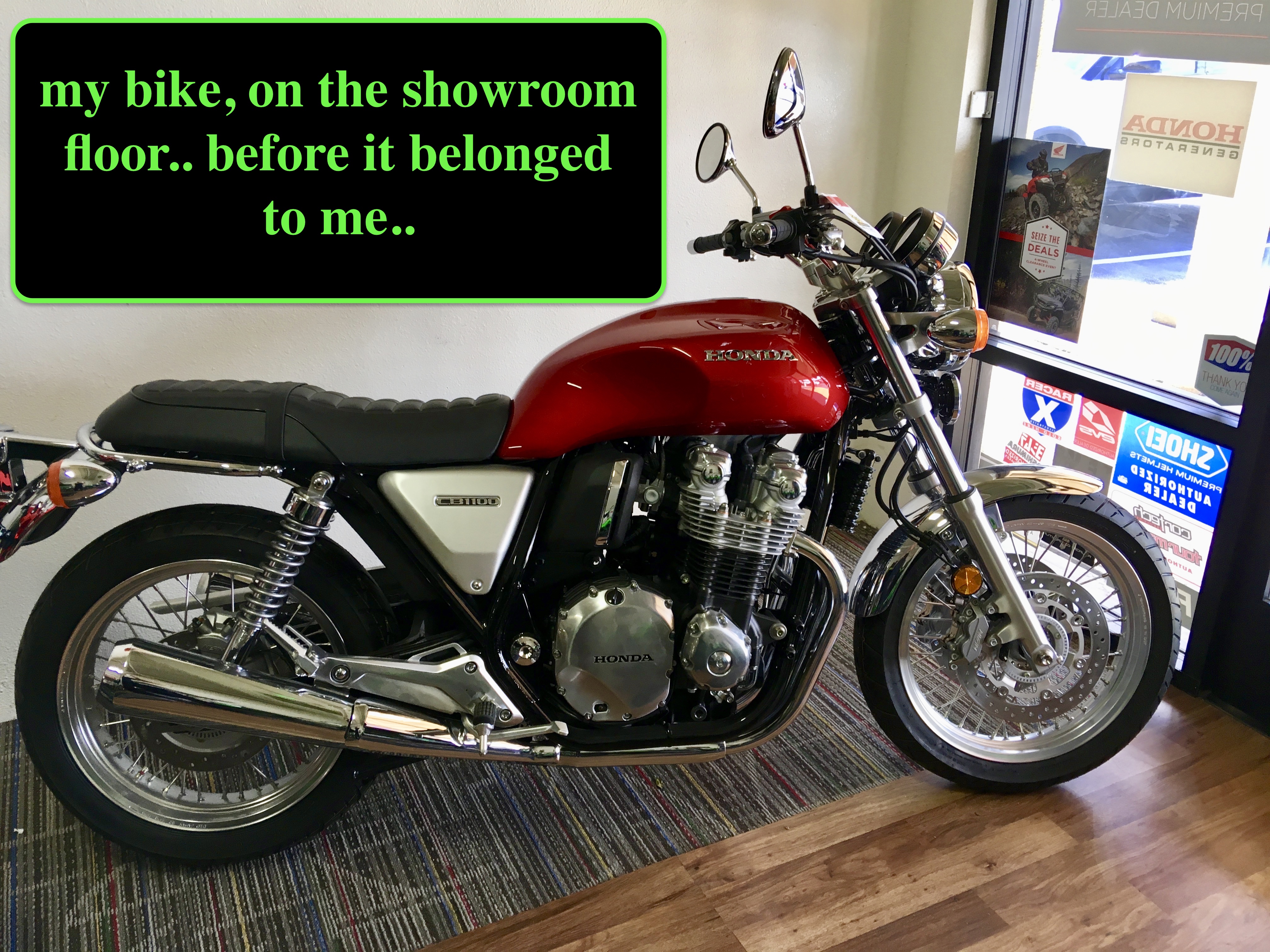

just a few memories on that last pic of the cb before I bought it..
