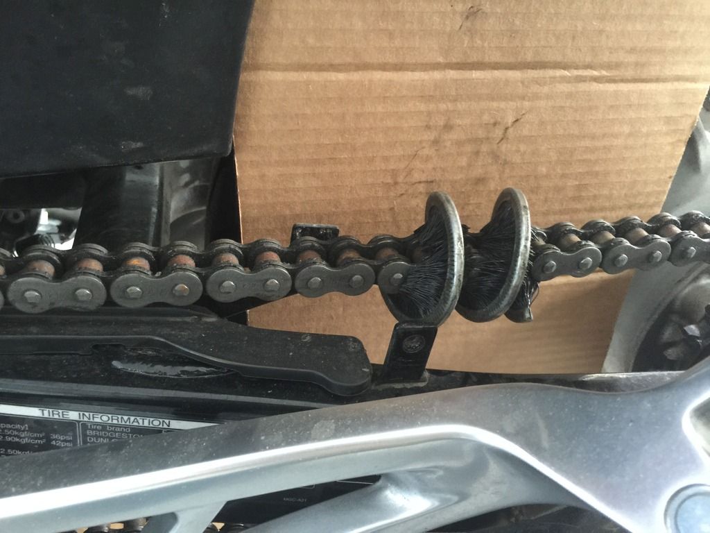

This is my first chain driven bike in a long time and cleaning it hasn't been my favorite thing to do. I picked up a Tirox chain brush and it makes the job much easier
[url=http://s1298.photobucket.com/user/aswreed/media/D750B061-D7FC-4581-A1B9-933642A7222C_zpsnfkbxo1c.jpg.html][Image: 9ee7fa546794d7b637d68ae395cc0f5b.jpg]
