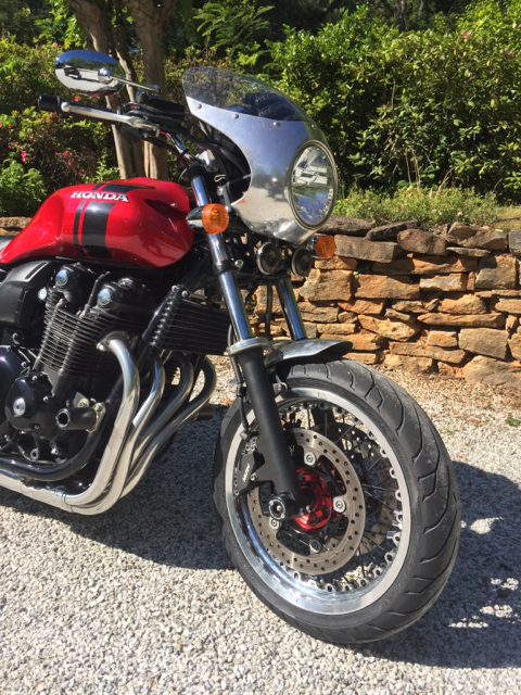

I gave up trying to keep mine polished and had them coated at jethot. It's not nearly as polished and beautiful as the stainless but it has kept its chrome like finish without discoloration for a year. [Image: 9ec2864efb84d7674e85e8e7f0c7492e.jpg]

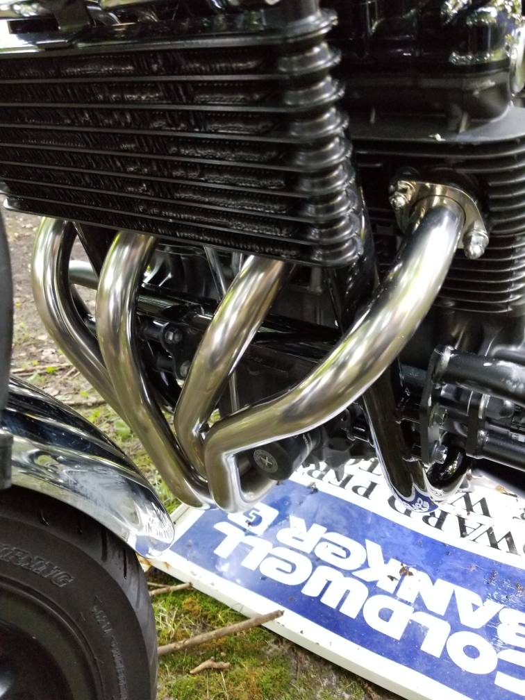

Today I tackled this one and used Toillett bowl cleaner to start with. This is how I started (1st pic)
First I used Lysol Toillett bowl cleaner to get the results of second pic. The Lysol Toillett cleaner ileft for 10 minutes then washed it of with a scotch pad, then I washed the bike and used the Mothers Mag & Aluminum polish and the result was the third pic. The fourth pic is the t-shirts after use. I only did it for about ten minutes and I know I could have done better with more time spent.[Image: 708efd7f737bf122a209b44e53997b34.jpg][Image: 20ecd6e2a0a769c0c1d7e093bc34dde7.jpg][Image: 5e0058aaf5b044c8d6b63d6b6fa7dad8.jpg][Image: 956df4b86893294b0b1bab4714bf2eec.jpg]
