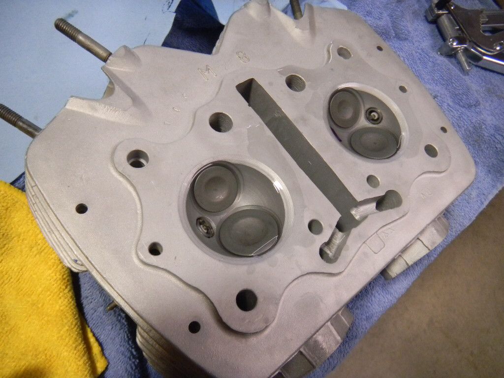

Started in on the engine. Progress will be slow. Recleaned the cases, cylinder & head.
Some pics
[Image: 8da77a03faf79a0a82d1e056b6d209b6.jpg]
After lapping the valves and assembly. I like to "leak check" with alcohol for about an hour.
[Image: 795c29cdc94c140db03402b9f666c09b.jpg]
I check it about every 10-15 minutes.
Not the best pic, but no leak through Big Grin
