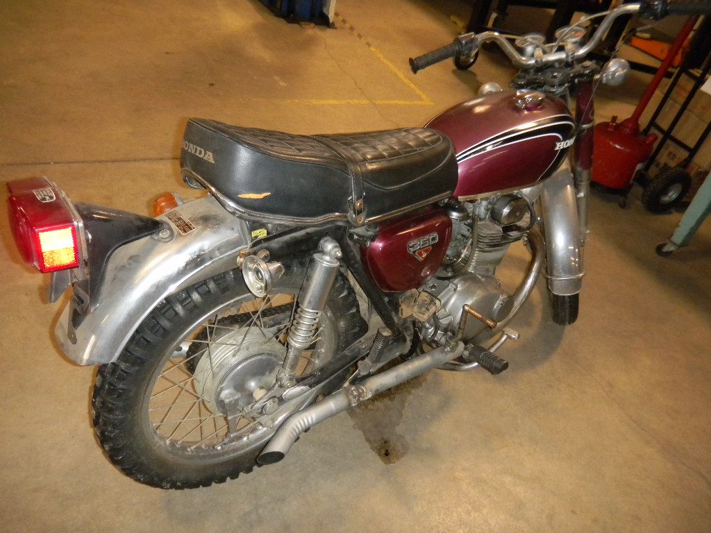

The Honda CB350 seemed to a good starting point. After talking with a good friend... he just happened to have one. A few minutes of negotiation, and a 1972 CB350 made it home.
[Image: f530e5ccabf0f7f16c71de96ef2d093f.jpg]

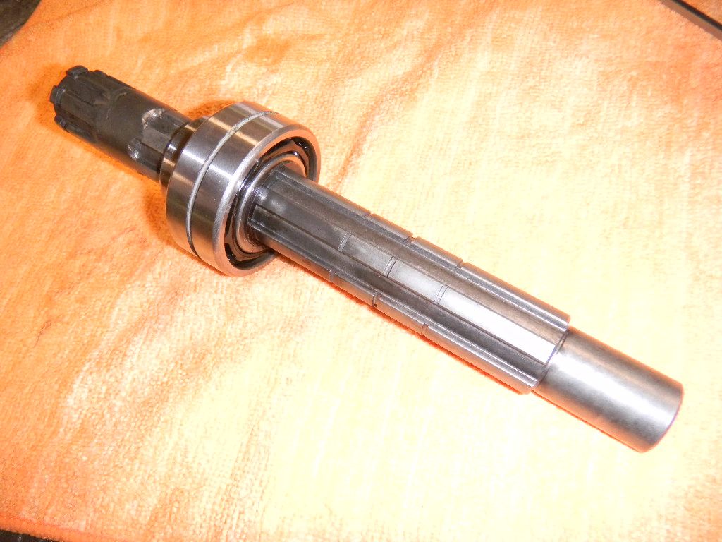

Extended the counter shaft to align the sprockets
[Image: 6efe5a8d6369607c6373fb4f71a81e3b.jpg]
