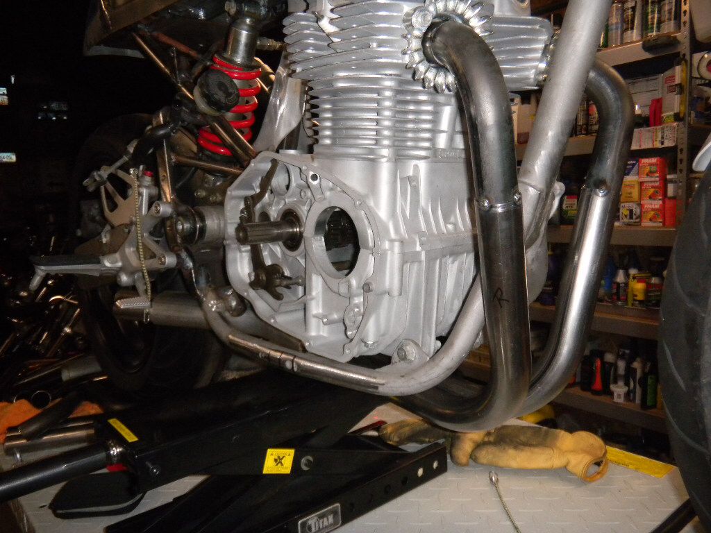

Haven't done a whole lot, but thought I'd post some updates.
exhaust pics
[Image: 47f4e4871c8b98db1a32fb38e56e7439.jpg]
Will have just enough clearance to remove the drain plug
[Image: bb7776c39d0bef912271b127878ab2a9.jpg]

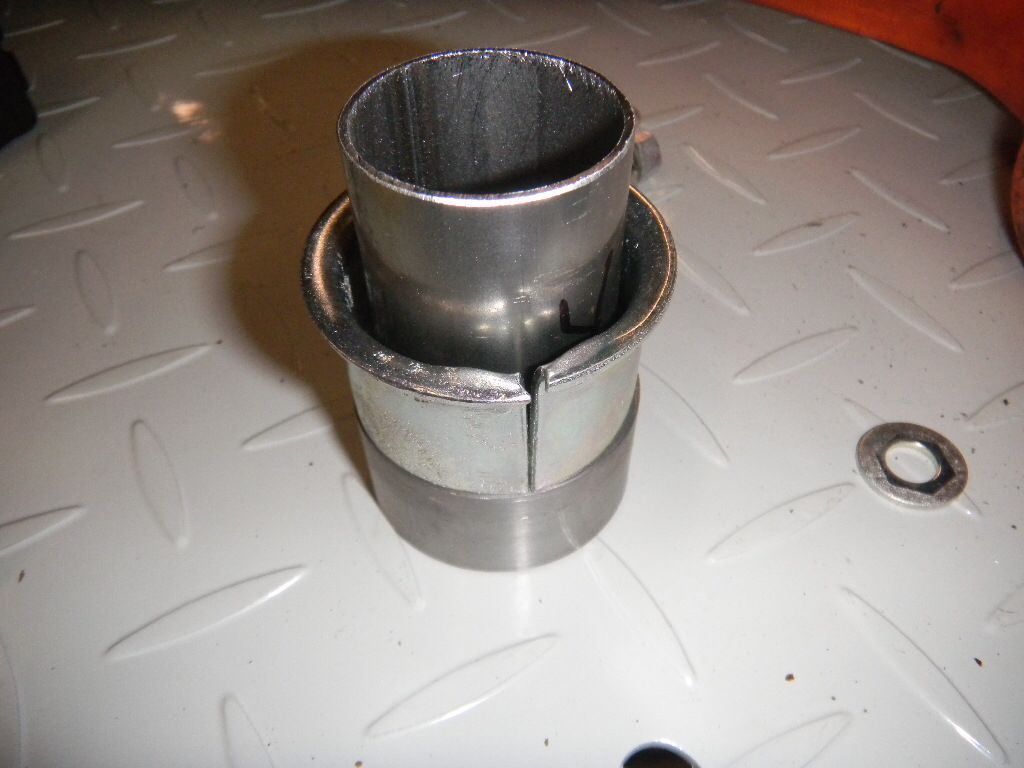

Still need to fab a rear mount, and a sleeve for the #1 pipe.

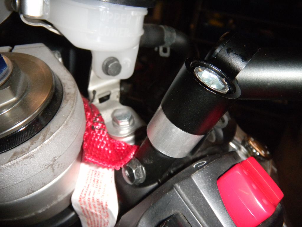

Machined a small spacer so the right mirror would clear the controls. I'll paint it to match.

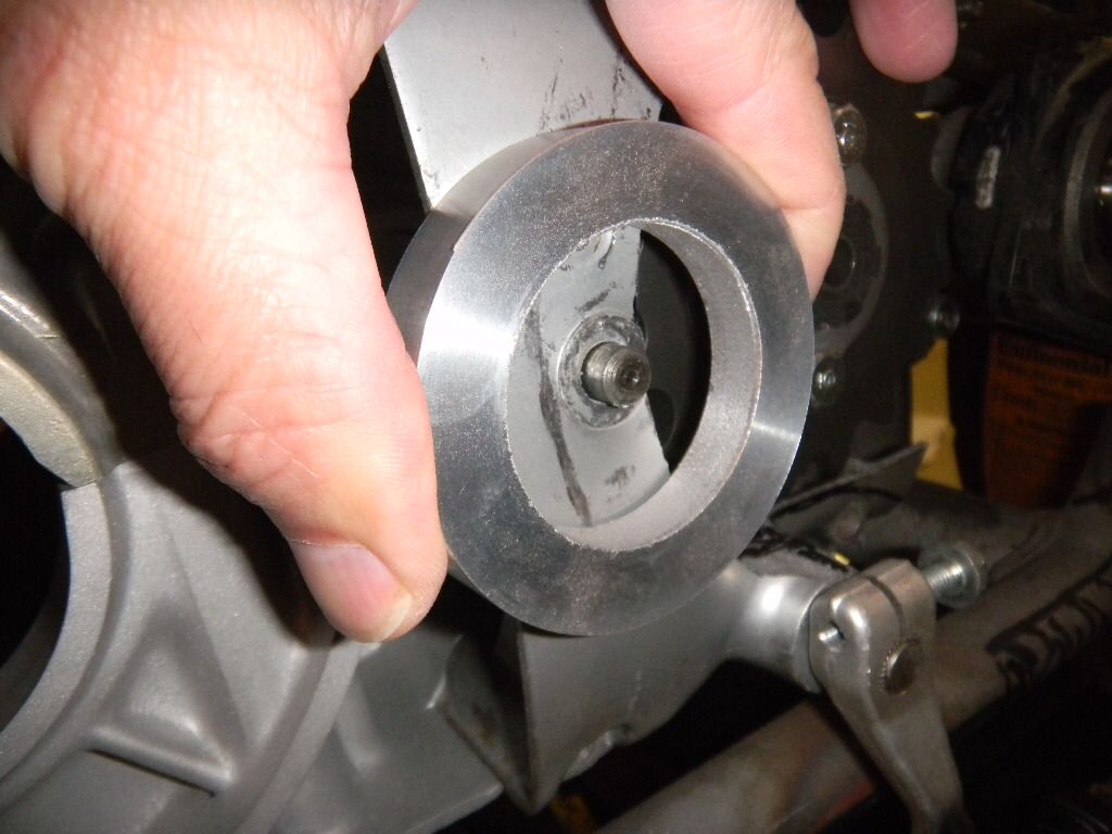

Really want to go with a hydraulic clutch. Challenge is mounting the slave and somehow having a way to have clearance between the slave piston and push rod.
Machined a piece that will get welded onto the side cover.
[Image: 9b9c51fd554f04889557e2d29ea89dcd.jpg]
The slave cylinder will mount to it.
[Image: f85f91d659f0dcfdeebdaaf85077d4e9.jpg]
