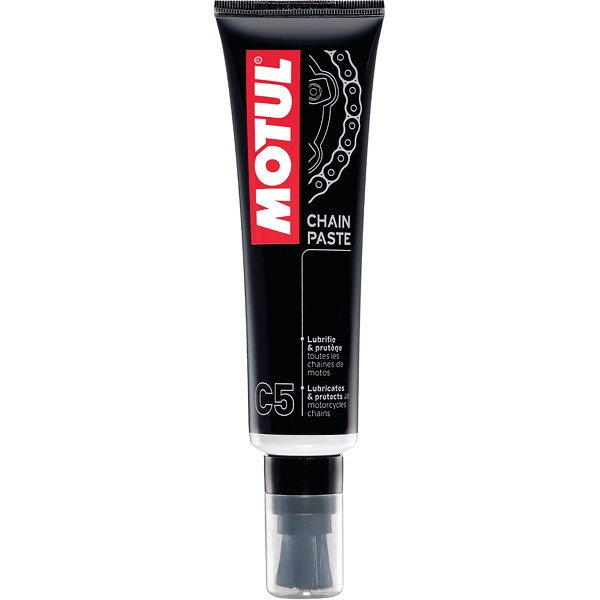

(08-24-2016, 12:11 AM)Riko_imp Wrote: After one month I did see the same spots again.
Now I am waiting and its been about a month, dunno for sure, forgot, but nothing so far.
And I switched to Motul chain paste, comes with a brush, very handy and clean way to apply.
[Image: 0c826fe8a785eda46a4b07b4adbd0f59.jpg]
At that time I used S100 chain spray to lube the chain.
Its a spray, not the thick stuff like Motul.
Dealers theory was that's an area that gets really hot and there is indeed a lot of piled up chain grease or durt as you see on the picture.
I did always use a lot of the spray stuff...
So the hot metal causes it to melt...wich explains the grease trail, according to him.
Dunno...

At any rate, if you overlube the chain you'll get that. I stopped using those thinner lubes about 20 years ago. Maxima Chain Wax was the first "wax" type lube I can recall but most all the good ones are like a wax now, they don't fling off and you don't need to hose it down.
