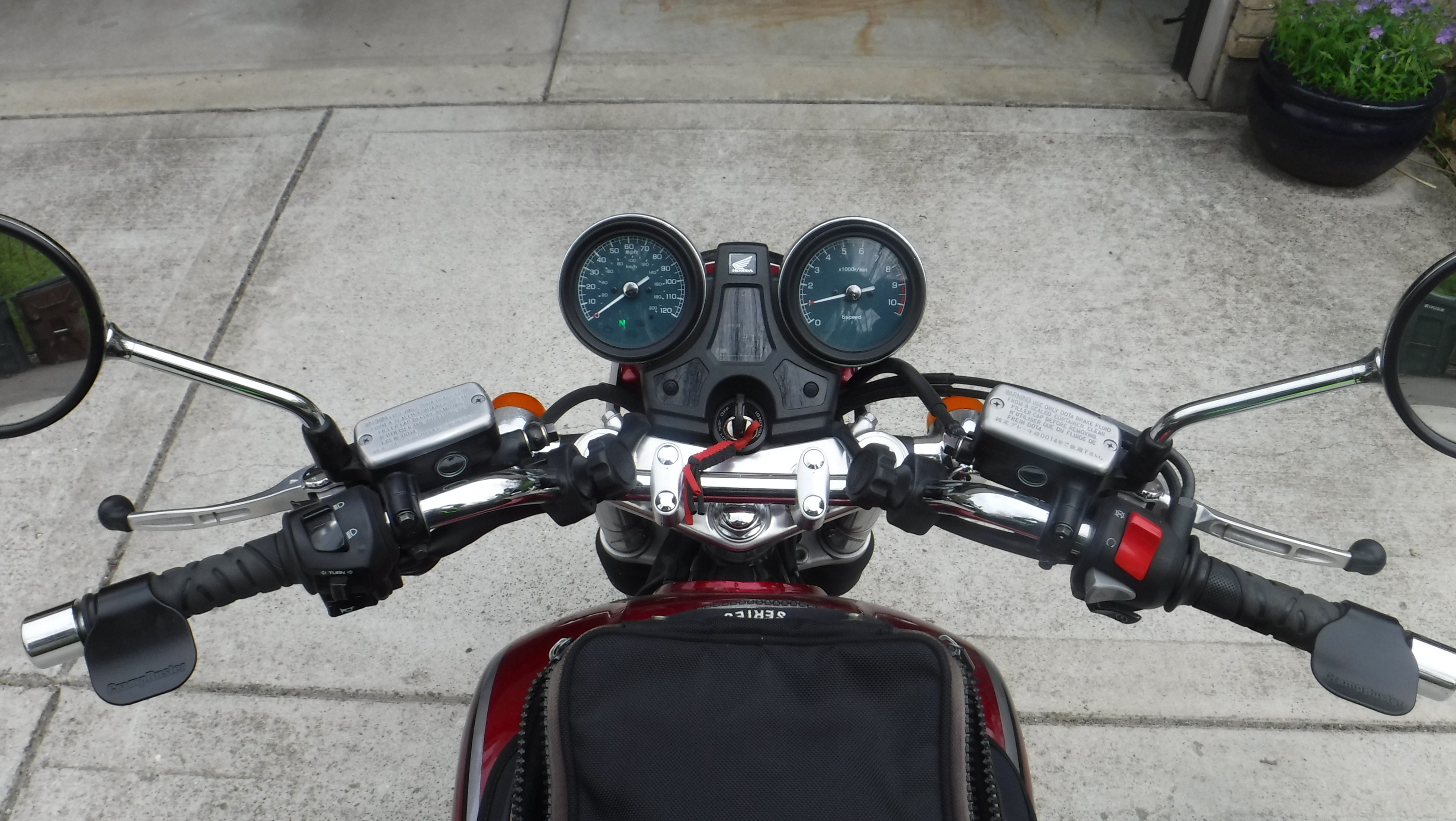

Today I got out for my first ride in a month (long story) and I tried the dual cramp buster set up. I kinda liked it, but didn't really need it because unlike the throttle side, you can lay out your fingers flat on the clutch lever anyway without having to grip the bar all the time. Still it's worth trying some more before making the decision whether to leave it on the clutch side or removing it.
[Image: b51c10f7b6b506859321e7821f2bd01c.jpg]
