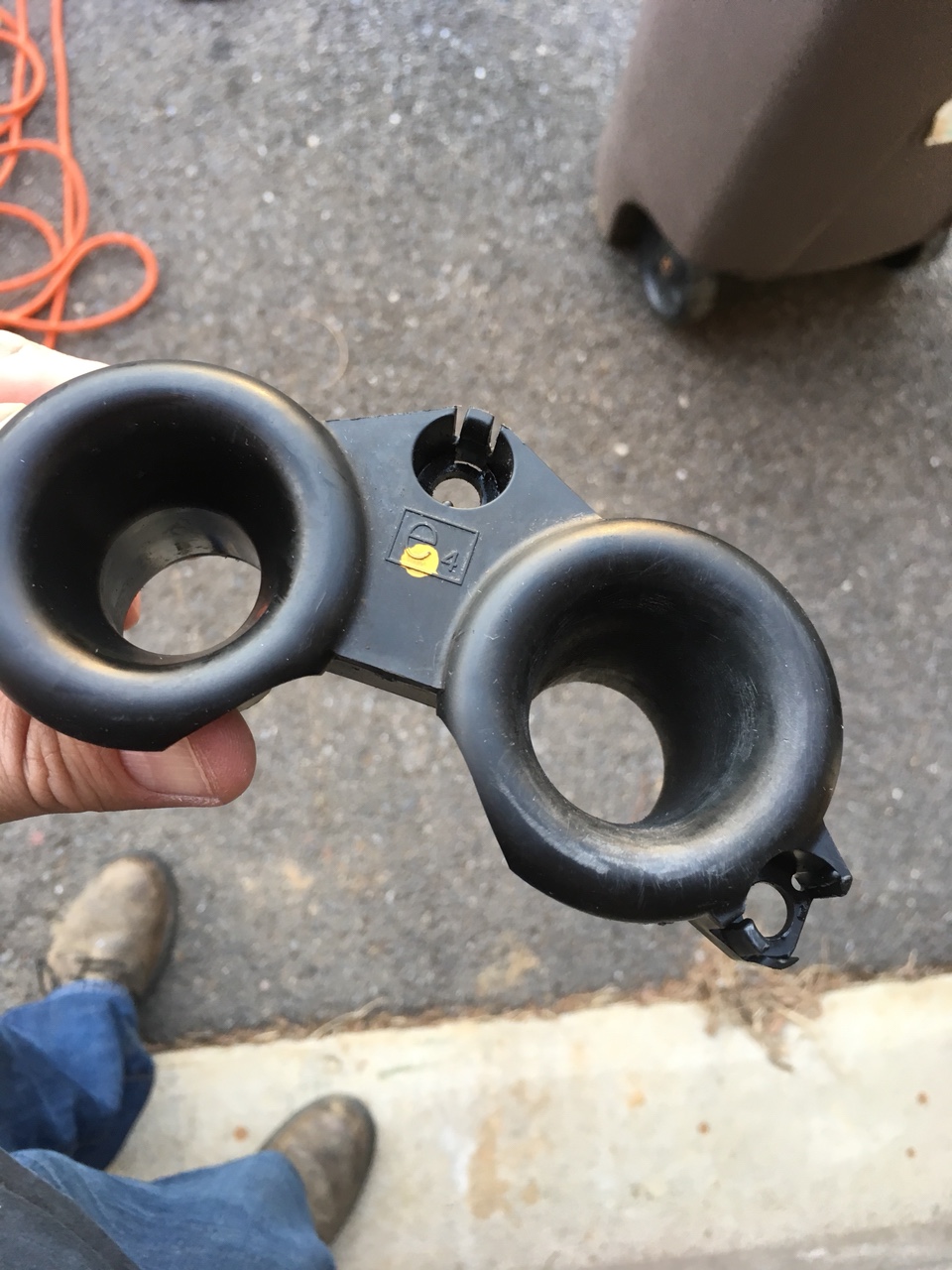

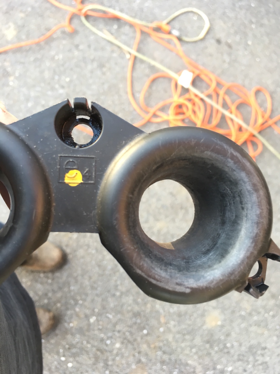

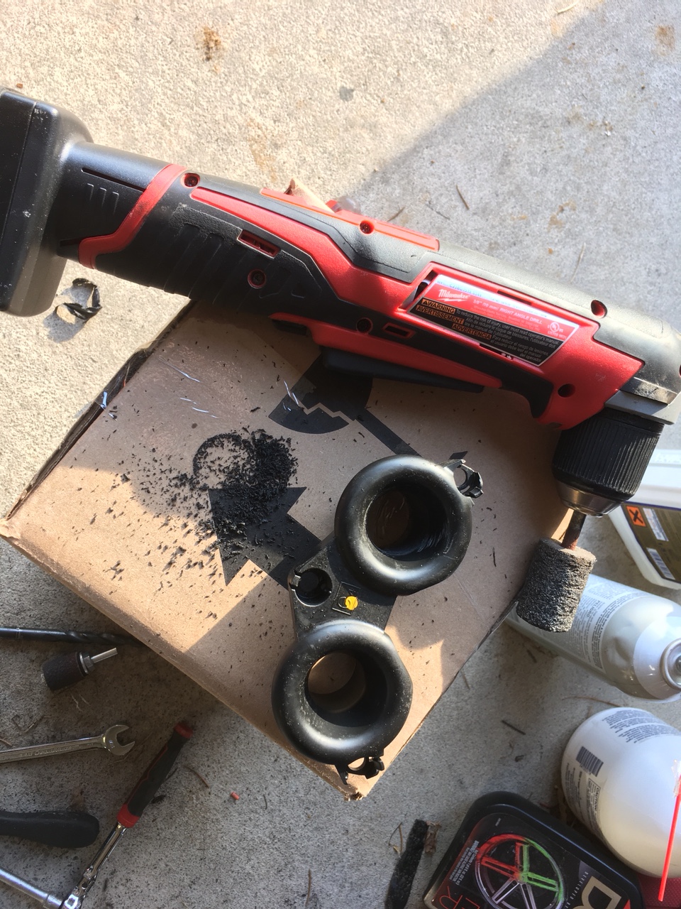

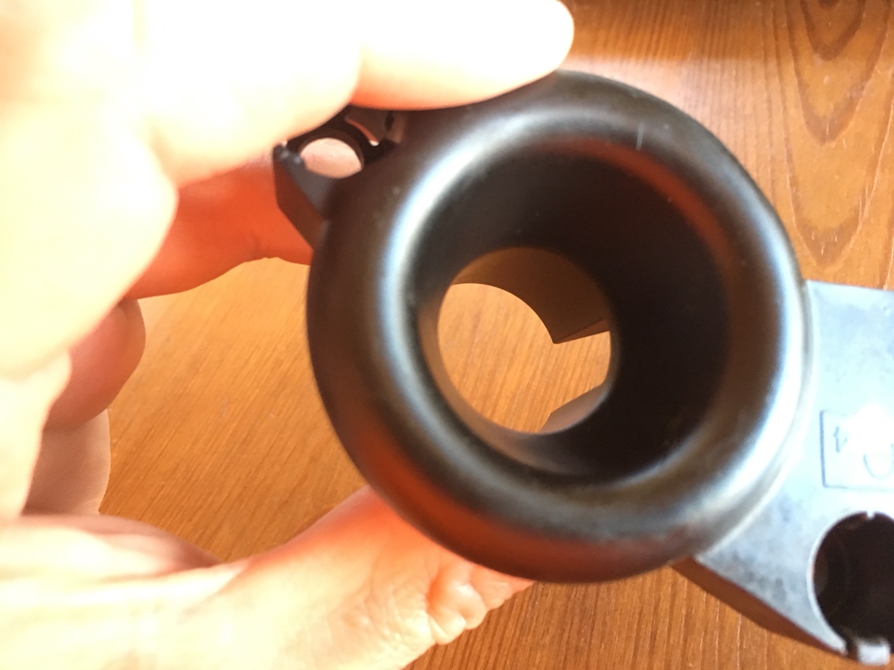

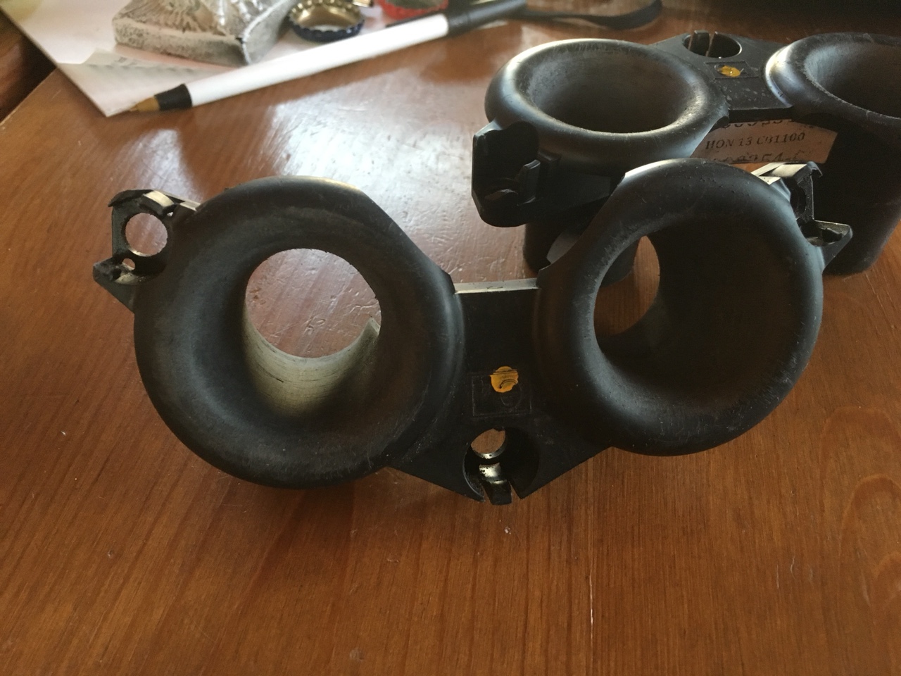

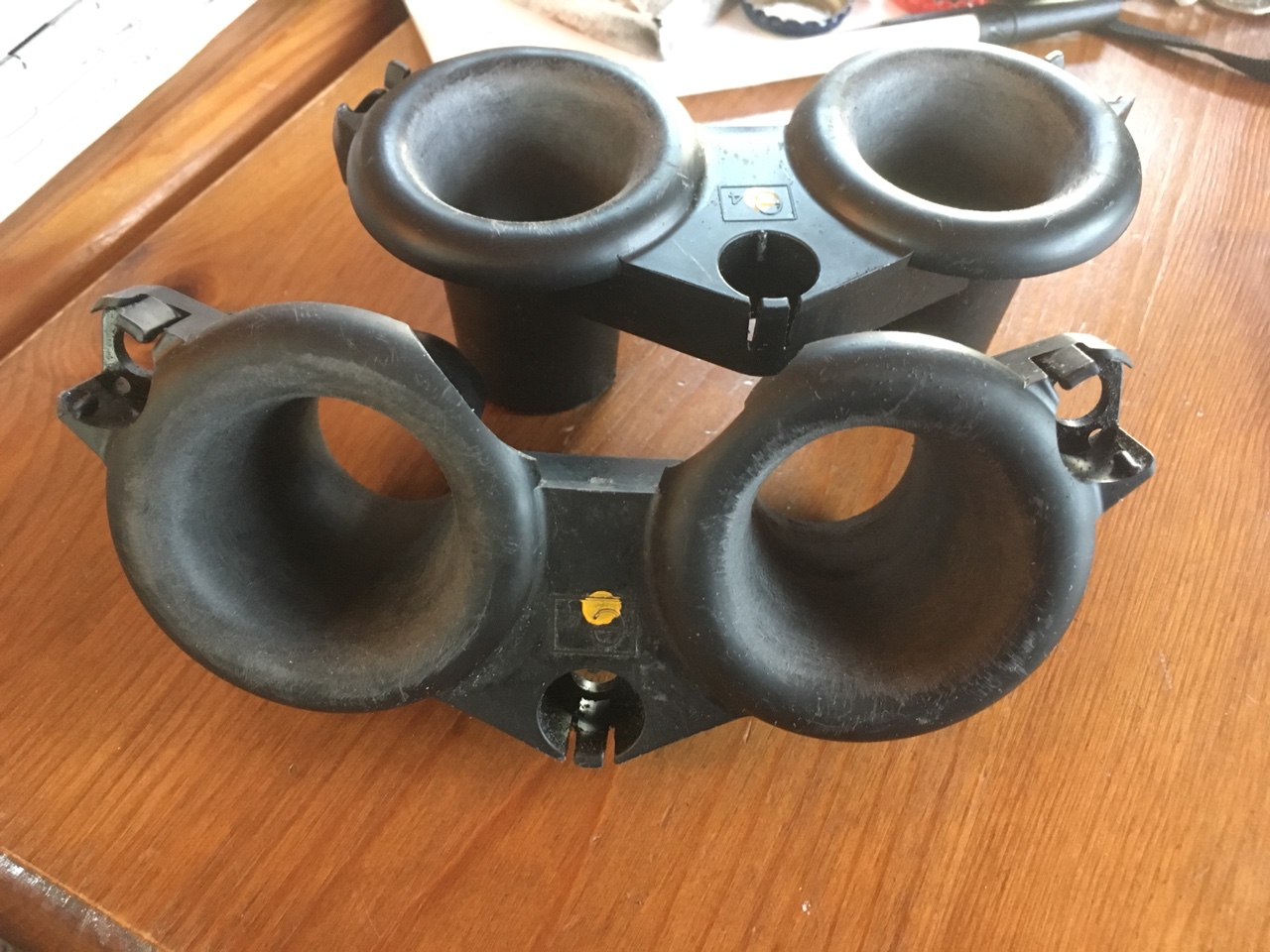

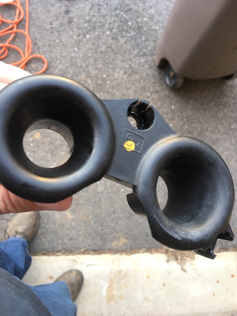

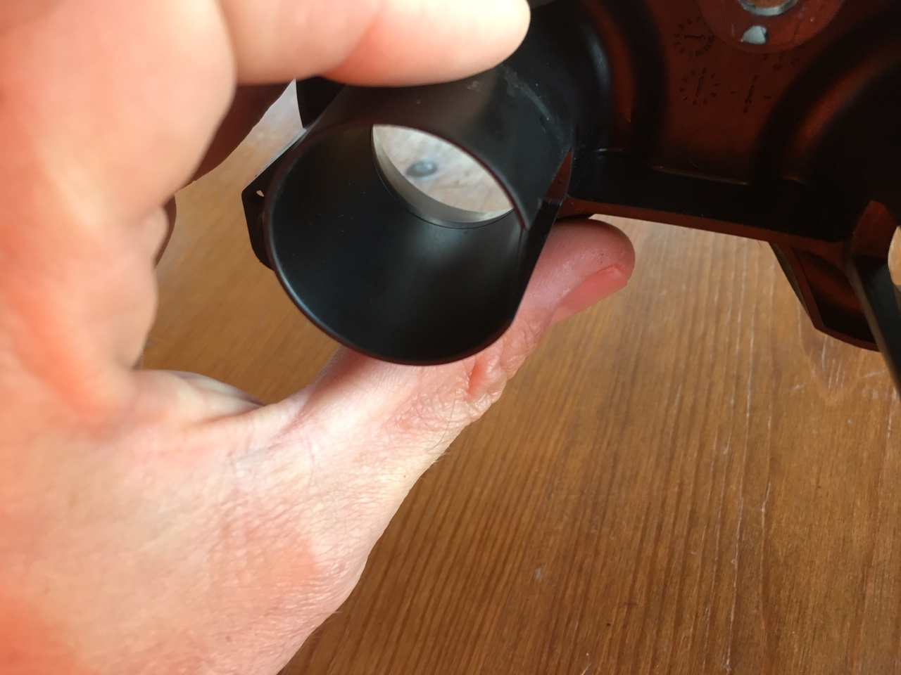

Give me a minute- I'll dig around for pics and update the post to show you what I did.
My stacks. Started with-
[Image: b25cf8418ef9cc422eb4d9fea15888fd.jpg][Image: de43b48f66c33891668b62c13f7524bd.jpg]
And then did this-
[Image: 1b751cd5bf79e8a833f35923d2c3fa51.jpg]
[Image: 6f8d16d54c2434a05abfb21af4833755.jpg]
[Image: a2747b8f5000e6780fd01e57e43e7408.jpg]
[Image: 9b0c2d0f5bd3e002523325727ca54e81.jpg]
[Image: e1589e52fb40ec5f33a034dc2e6a358b.jpg]
[Image: 19295a18bf99f8b5d205cb8869684170.jpg]
Unlike the TSR- I am keeping the exact same factory lip shape, same intake diameter, same outlet diameter... just removing what I believe to be an intentional midway choke point.
And since these are available dirt cheap and are plug and play with no modification needed (holes drilled in airbox) I have nothing to loose but time.
