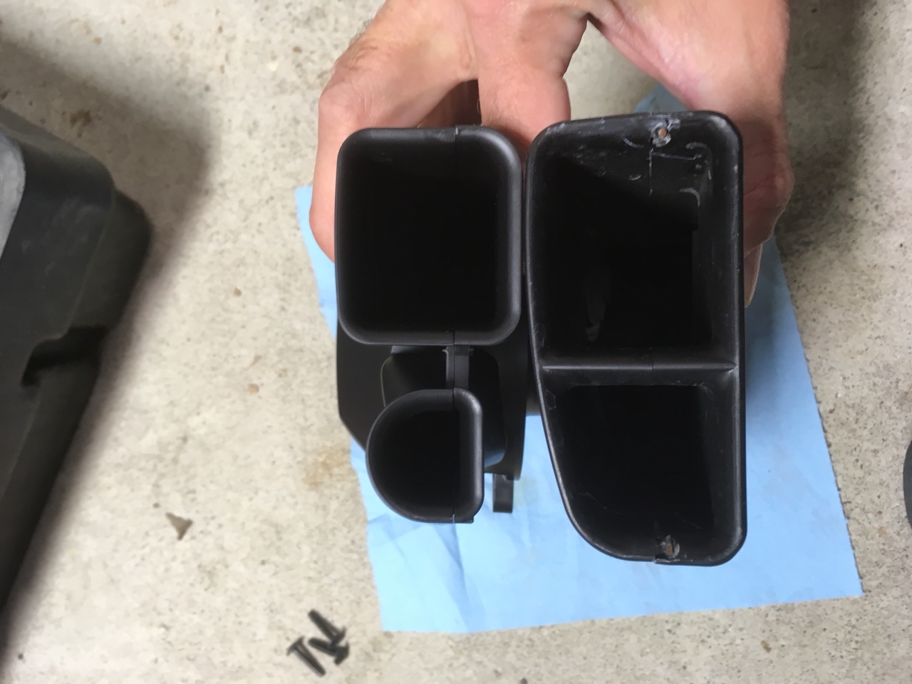

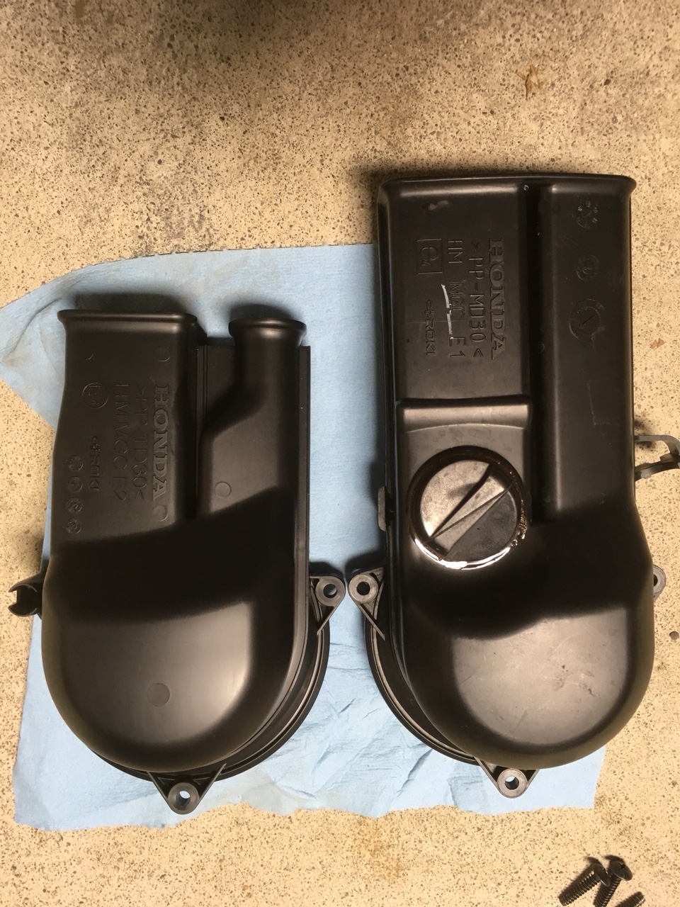

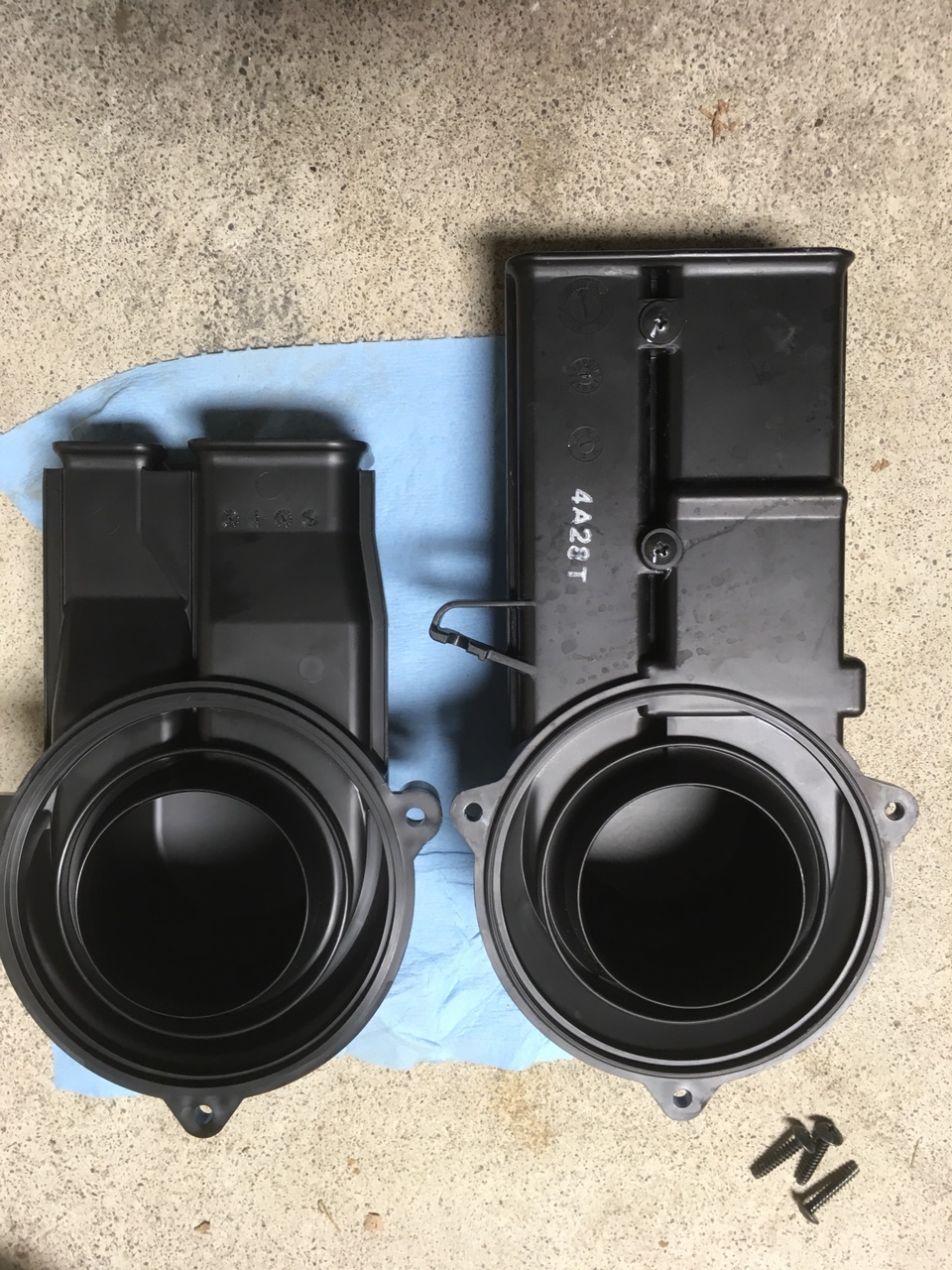

2014 / 2017 airbox snorkels

Wonder why the change (2107 on left)?
05-12-2018, 11:24 AM
Hard to say.
Smaller ports tend to increase velocity. Larger ports can flow more ultimate cfm. Longer runners tune for lower rpm, shorter lengths= higher. The ‘bowl’ on the end may act like a plenum a bit. Smaller equals throttle response, larger equals better top end breathing. I don’t expect the difference on the horn to make any drastic difference on it’s own. I also have the TSR plate that replaces these horns. I will be testing and comparing all 3 on the dyno. Sent from my iPhone using Tapatalk
05-12-2018, 02:05 PM
I sliced the "bowl" off mine.
05-12-2018, 10:52 PM
Yea- negating any resonance tuning of the entire thing.
I'm pretty sure you would see a loss on the dyno- especially if it was lower/mid rpm and part throttle.
