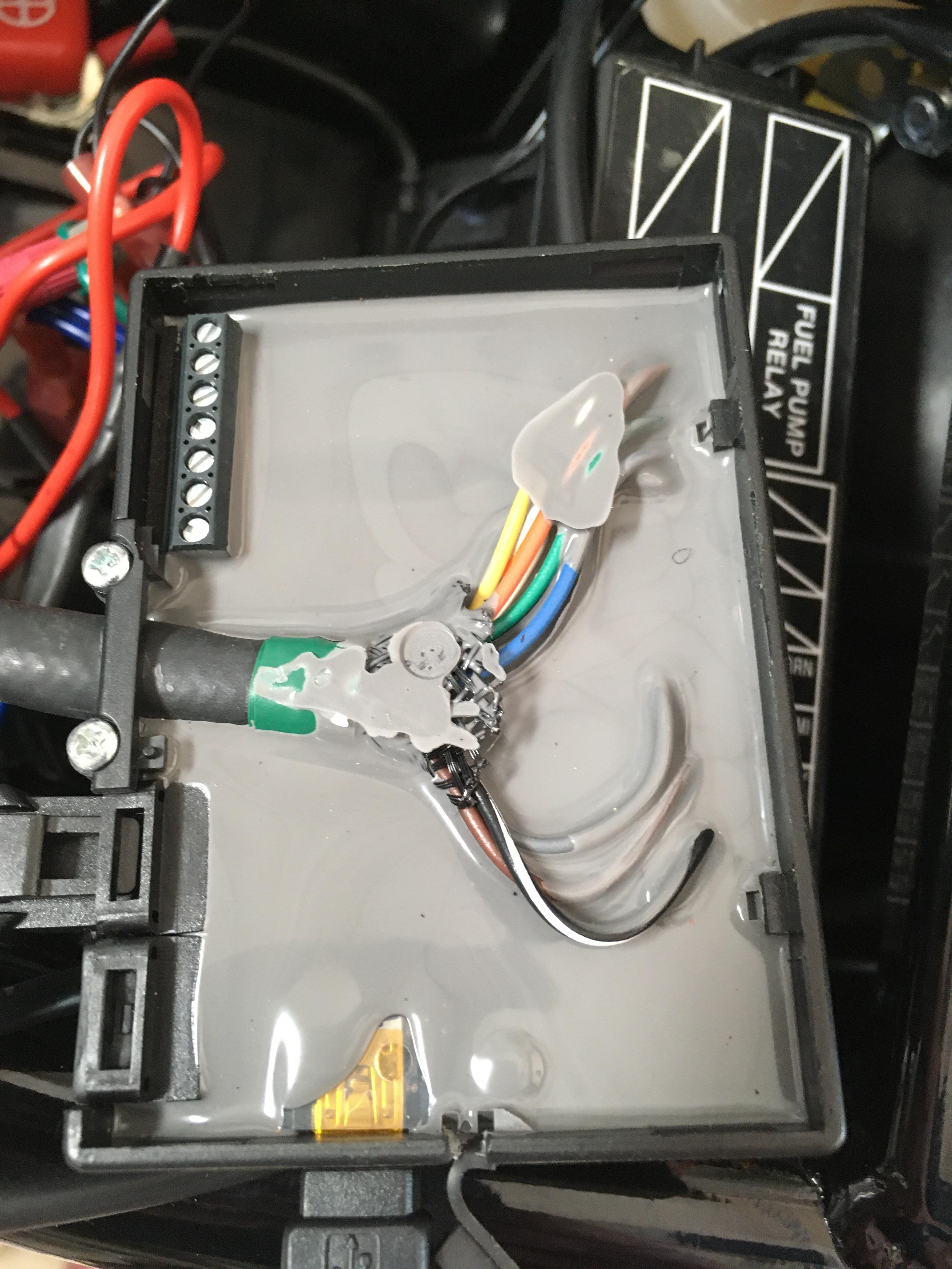

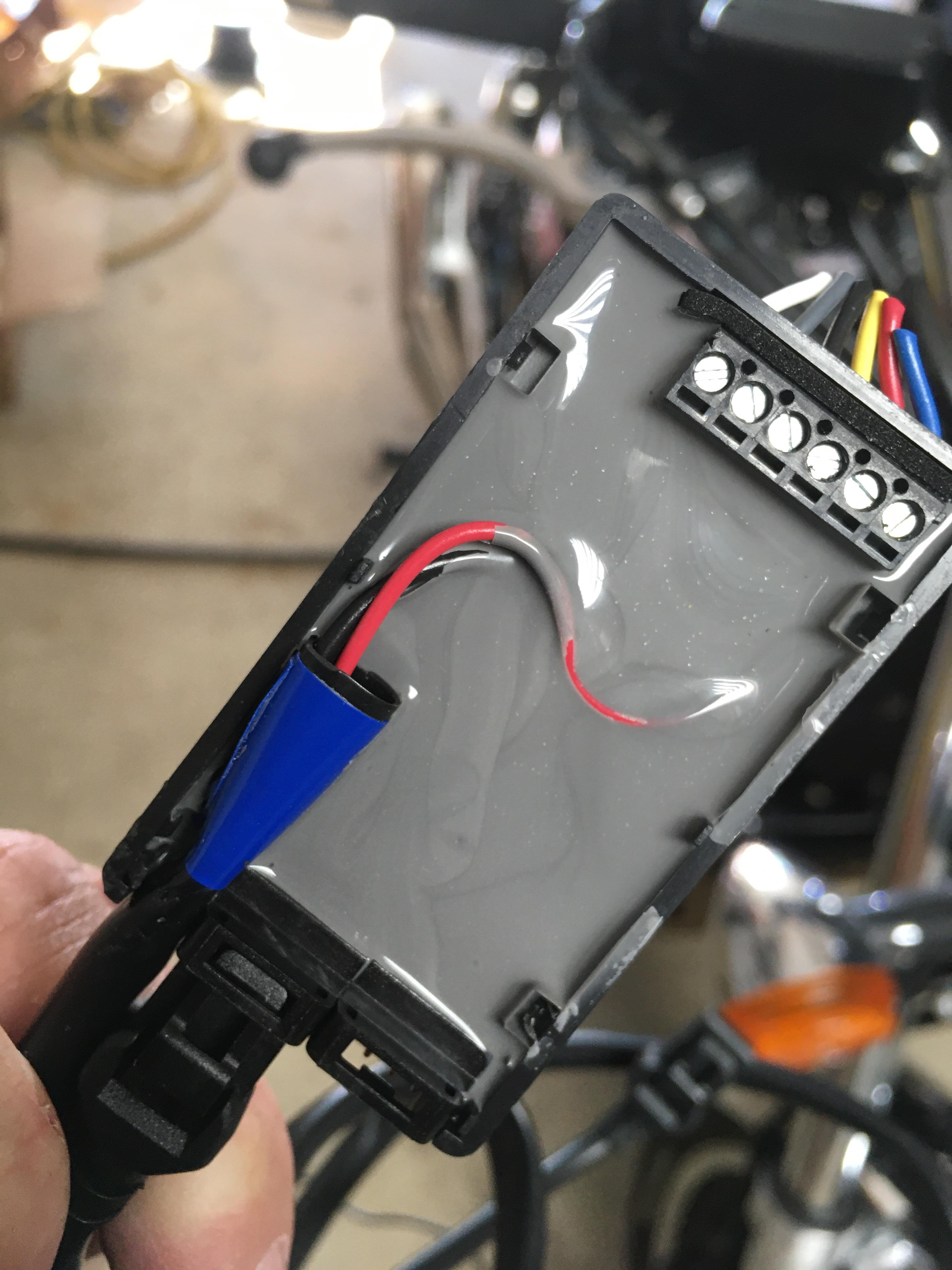

So the case on the power commander and autotune box both pop open easy enough- but both sealed solid construction inside.
No sign of heat, bubbling, smoke or anything on either one.
Since my garage computer can see the power commander when I plug into it- and gives no errors- I’m guessing it and maybe even the auto tune box are ok.
So- I need to figure out where the smoke and sizzle in the battery area came from.

Can't for the life of me find anything that seems discolored, melted, signs of heat, etc- all fuses good, diode tests good on meter, swapped relay positions in the fuse box.
I guess I wait for the new ECU to show up.
In the mean time if anyone has any suggestions...I'm all ears.
