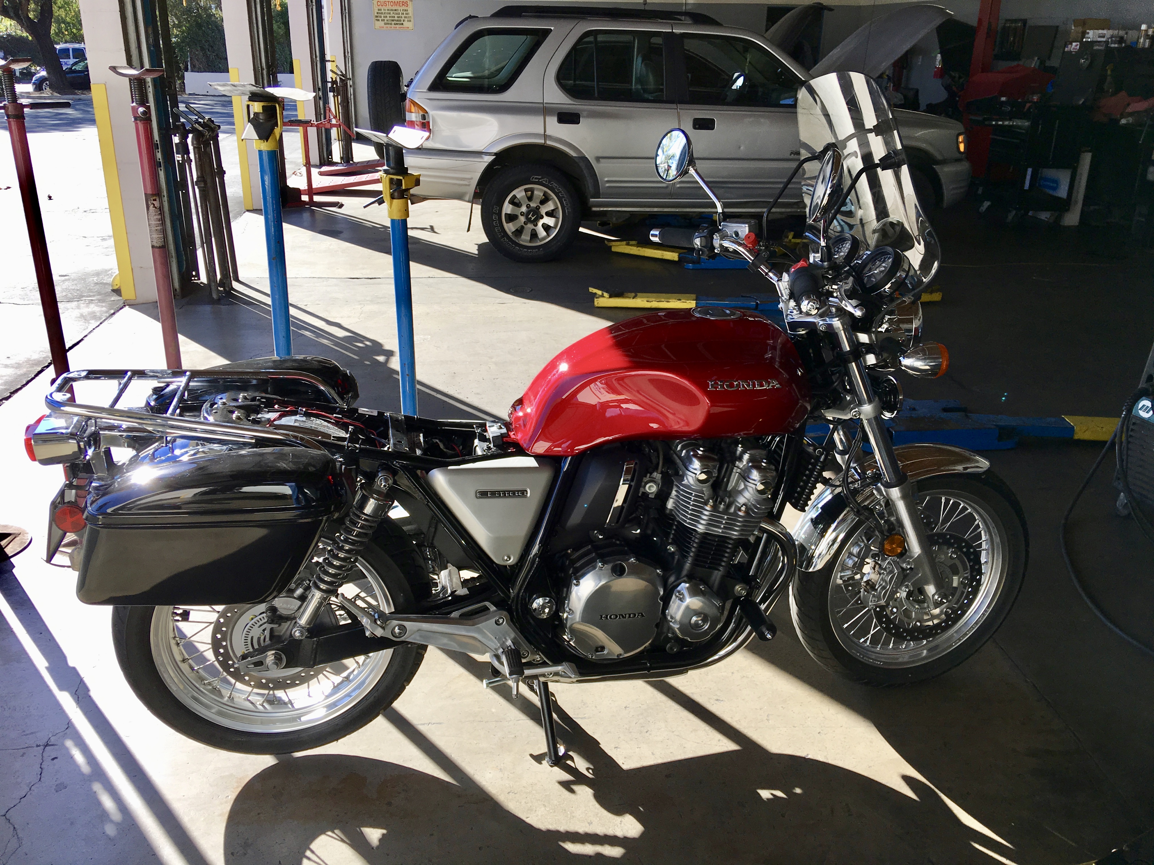

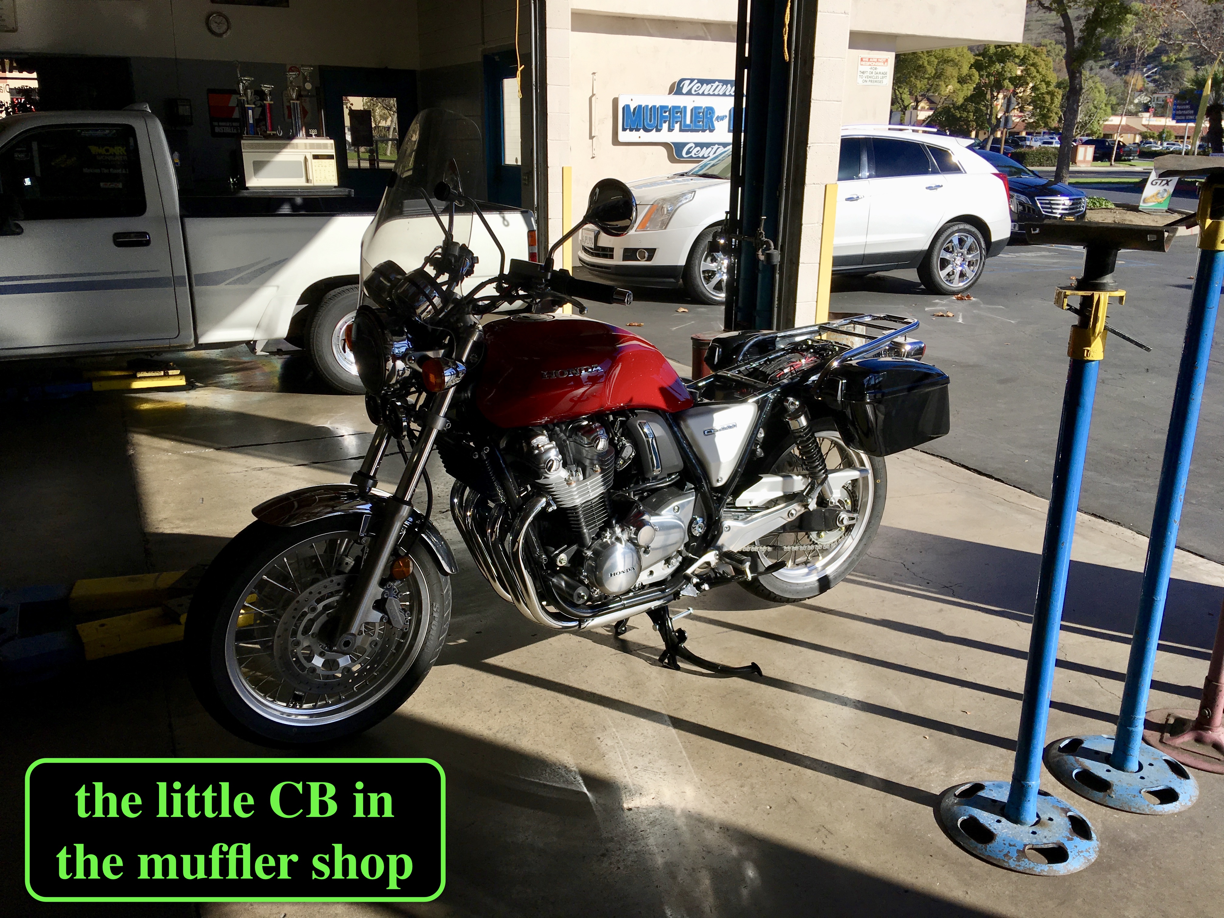

well, I have bought expensive slip-ons before.. 2 brothers for my 919 and stayintunes for my fjr.. lots of cash.. I feel great about my emgo shortie purchase.. If I recall they ran about $65. ea. then maybe another $50 at the muffler shop..I think they look good and sound good also.. [Image: de1dfad7b5eed14e0a308bb1ae888291.jpg][/b[Image: 1a77a5ff33e276f500ec38942f793900.jpg]

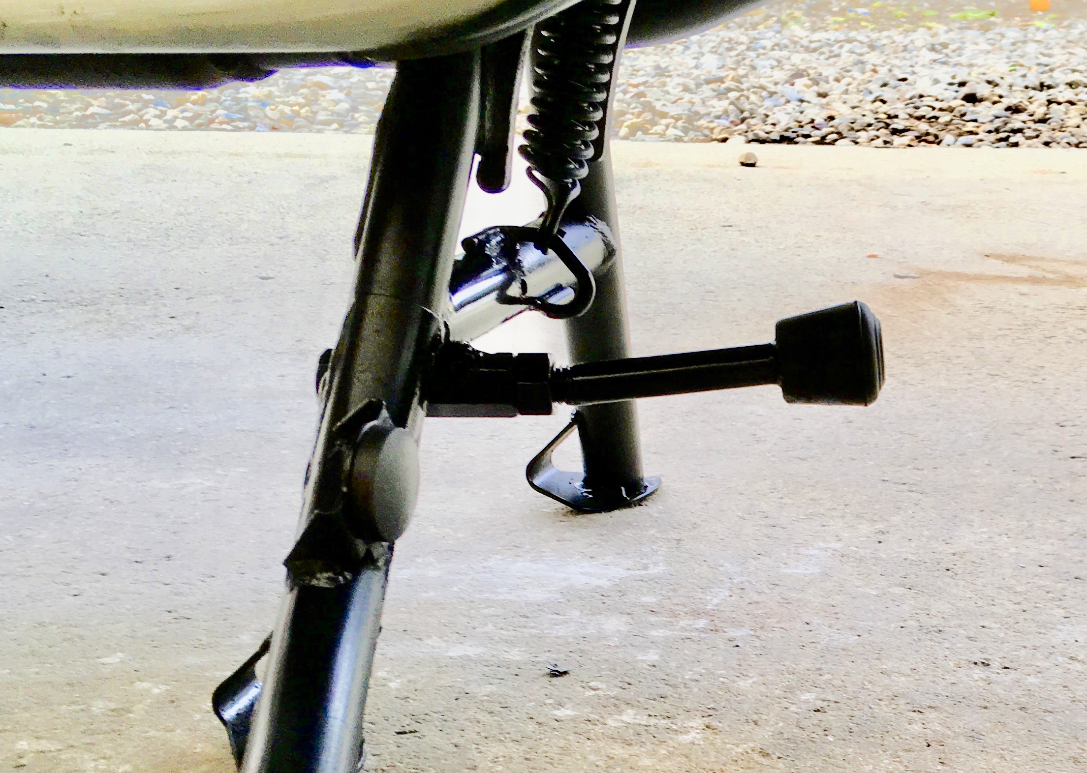

[b]I had my seat off, to disconnect the battery.. while I was having the 2 adapters made for my emgo's, I had the muffler guy weld the continuous thread nut onto my center stand .. I had it bolted in place, but I thought a weld would be better.. it was a perfect time to have it done.. then I would screw in the right length bolt (6 in. I think) and use a locking nut to lock it in place.. that allowed for some fine tuning on the final length.. I finished it off with the rubber tip from a cane and a little silicone to hold it on.. I have had to replace my cane tip once so far.. its very easy to do.. it works really well.. very quiet when rolling the bike off of the center stand.[Image: 56cd0736fa545949634df9f0527667a4.jpg]
I forgot to mention.. I pop riveted a hard rubber pad I made from an old foot peg onto the area where the cane tip strikes the under carriage.. (can't find the pic) .. it may have been about 3/8 in. thick by 2 in. by 3 in. I also put a slight bend in the bolt.. all part of the final tweaking

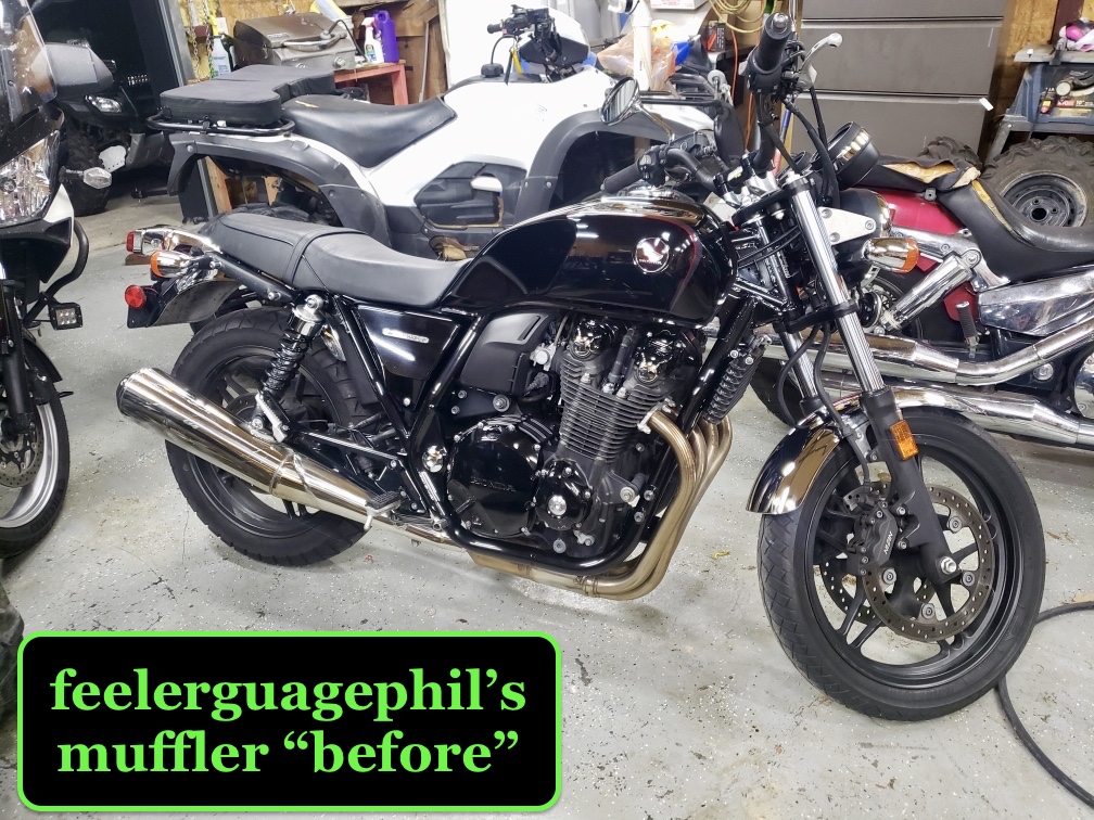

got the message Phil .. here is the "before" pic that you sent me ..
chuckk..
..[Image: 9b590bc7de5be774fc9122f6ce2f51ab.jpg]
Thx Chuck..
This is perfect "BEFORE" pic.. wheels are being rim stripped and tank has gone for repaint as with other little parts.
Head fairing is sat on shelf waiting for fitment, and shorty pipe is on.....

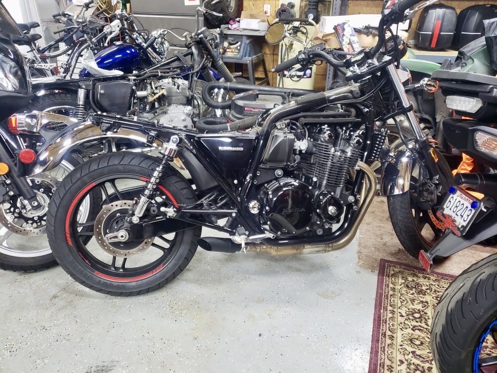

I am posting this pic for Feelergaugephil .. I'll bet it has a nice sound to it ..
.[Image: 240ecc0b720ffd2446799ebcb7df10f7.jpg]
Chuckk,
Nice pic of a dot Wink
nothing gets past you.. I am trying to figure out how to separate my pics from my text..
