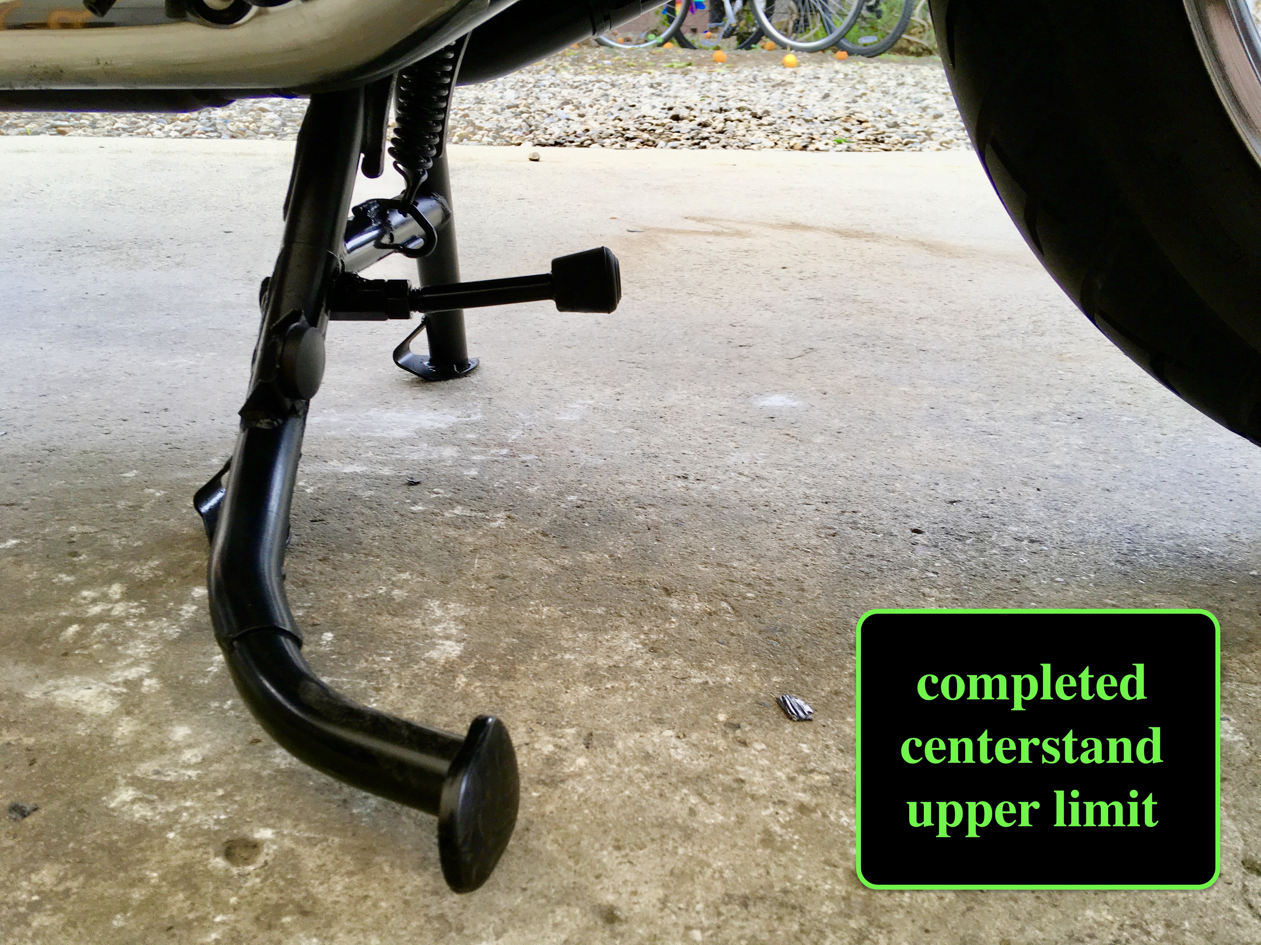

how about a pic of the slip-on installed..do you have dual exhaust or just a single exhaust ..do you have center stand issues..I installed dual after market slip-ons.. the reverse cone shorties.. they sound great!! .. I would leave the cats alone.. as you know, there is some nice sounds coming from them.. when I added my emgo slip-ons, the nice sound was still there.. I had to go to a muffler shop to have 2 short "s" extensions made.. they run from the cat, out to the side of the bike , then back.. then just slip on the slip-on's ..[Image: 1052d02a3e1ef343fcbb309f9306e62d.jpg][/b[Image: 40b692c11352f70a0a686d46b0e20b71.jpg]
[Image: bc493ccb21386fd7cbe4caa8cea95632.jpg]
[Image: b093d45d77840c8c15bc952c284c4f29.jpg]
[b]the packing was lacking ..... easy to take apart, I bought packing and rebuilt the mufflers right away.. it gave the exhaust a throatier sound.. the deeper sound was just perfect.. [Image: f663741941ccc9b818fd2b2bb33f269e.jpg]
