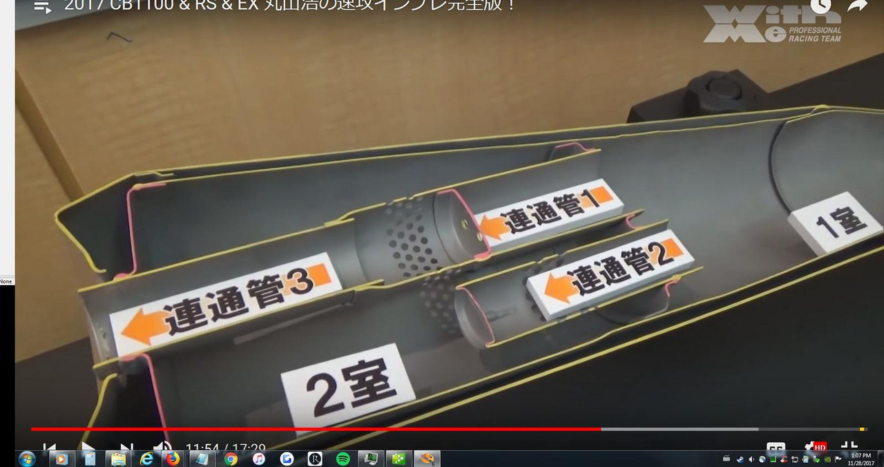

This is what the 2017 tip looks like in a cross section.
[Image: 8b06245a1b7a36ada3b1e545c5c26f91.jpg]
Looking at how it's baffled, I think one large hole that you suggested should do the trick.
[Image: c158859a882282c07ce249ec189d1b4b.jpg]
I don't know how you found that picture, but it is cool that you did.
