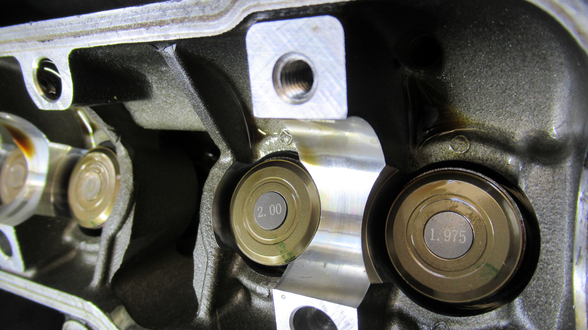

Well the valves are adjusted, took a few days because i did not have one shim so i ordered 5 locally and got them today.
As it happens i did the camshaft removal twice and got familiar with the process after assuring myself how the markings should look like by rotating the engine over by hand several times.
Once you've done this it becomes simpler to do, i was very fussy with the feeler gauges and spent a lot of time getting the numbers correct, at this time we are in lockdown so i had plenty of time to do this.
Here is the authentic record of the clearances as measured at 18.000 and 55.000 km;
[Image: ab97945109768eb9507213b91138c846.jpg]
and some calculations to the shim sizes old and new, only two ex valves were out and 5 were on the limit, all exhaust valves, the intakes had not moved in 47.000 km exept one;
[Image: dbb8dfcb789c40828fee15166bffc4bb.jpg]

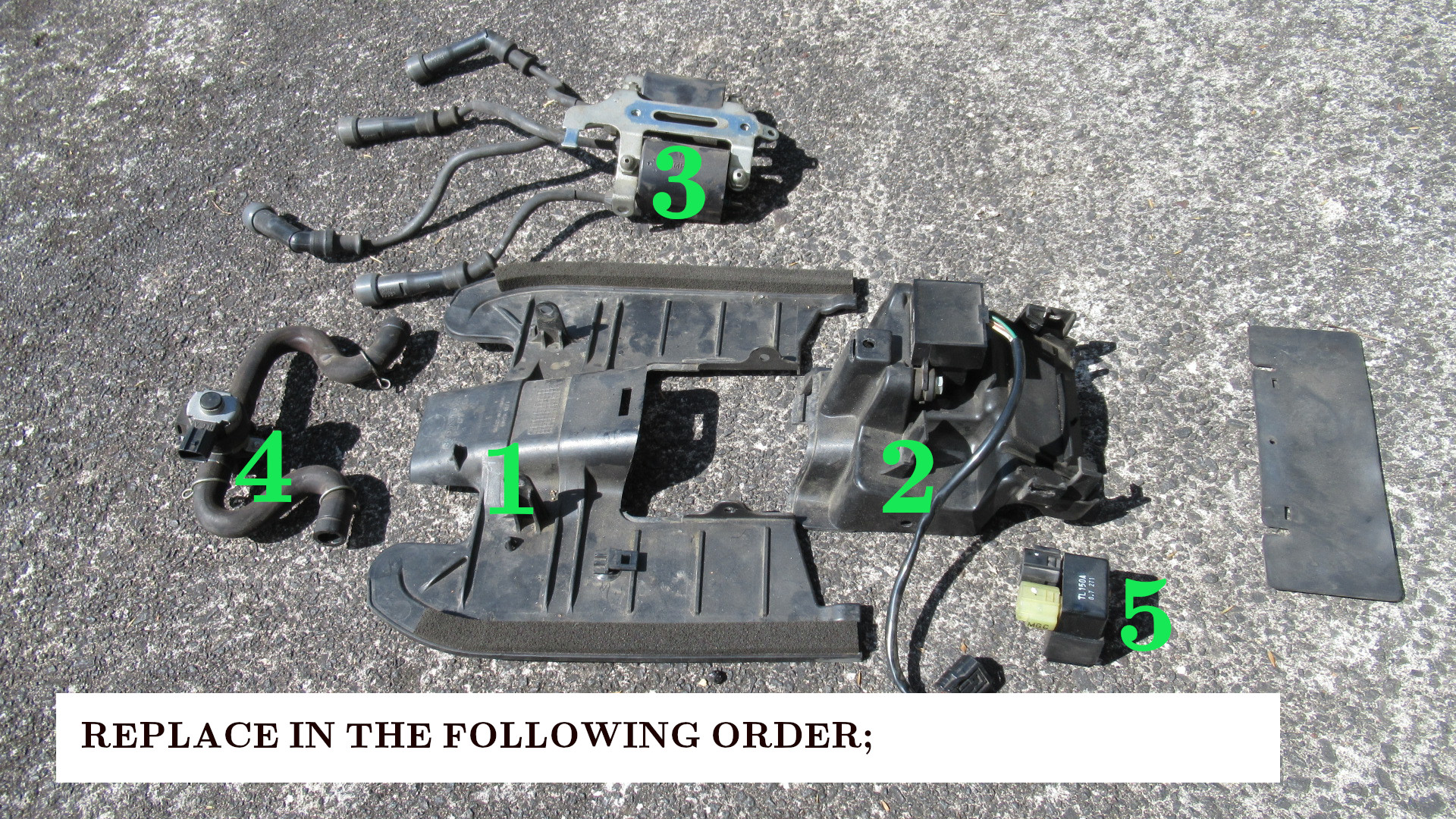

The other parts were installed in the following order, the heatshield inserted from the right side;
[Image: fdfd2080dadd9472606ae7fc28ce2ab8.jpg]

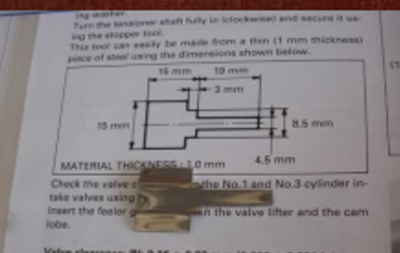

I have a tool that winds the tensioner back into itself and it is very small, you take out the screw and aluminium washer, use the tool to decompress the tensioner by winding it in, locate the slots and push the tool into two of the four slots which now prevents the tensioner from extending itself and now it does not fight you when unbolting the tensioner and it is straightforward to undo the two bolts and take the tensioner out.
In this video ( at 5 minutes in ) you can see what these four slots look like, their function is to hold the tool by itself and keep the tensioner spring wound up whilst mounting/unmounting the tensioner;
https://www.youtube.com/watch?v=VSr6zD4iT2s
[Image: 5a5c3c96bb0578efa05f42b61429165a.jpg]
As you can see on the picture there is not an abundance of room to have a larger tool do the same job, this little piece of copper works just fine.
