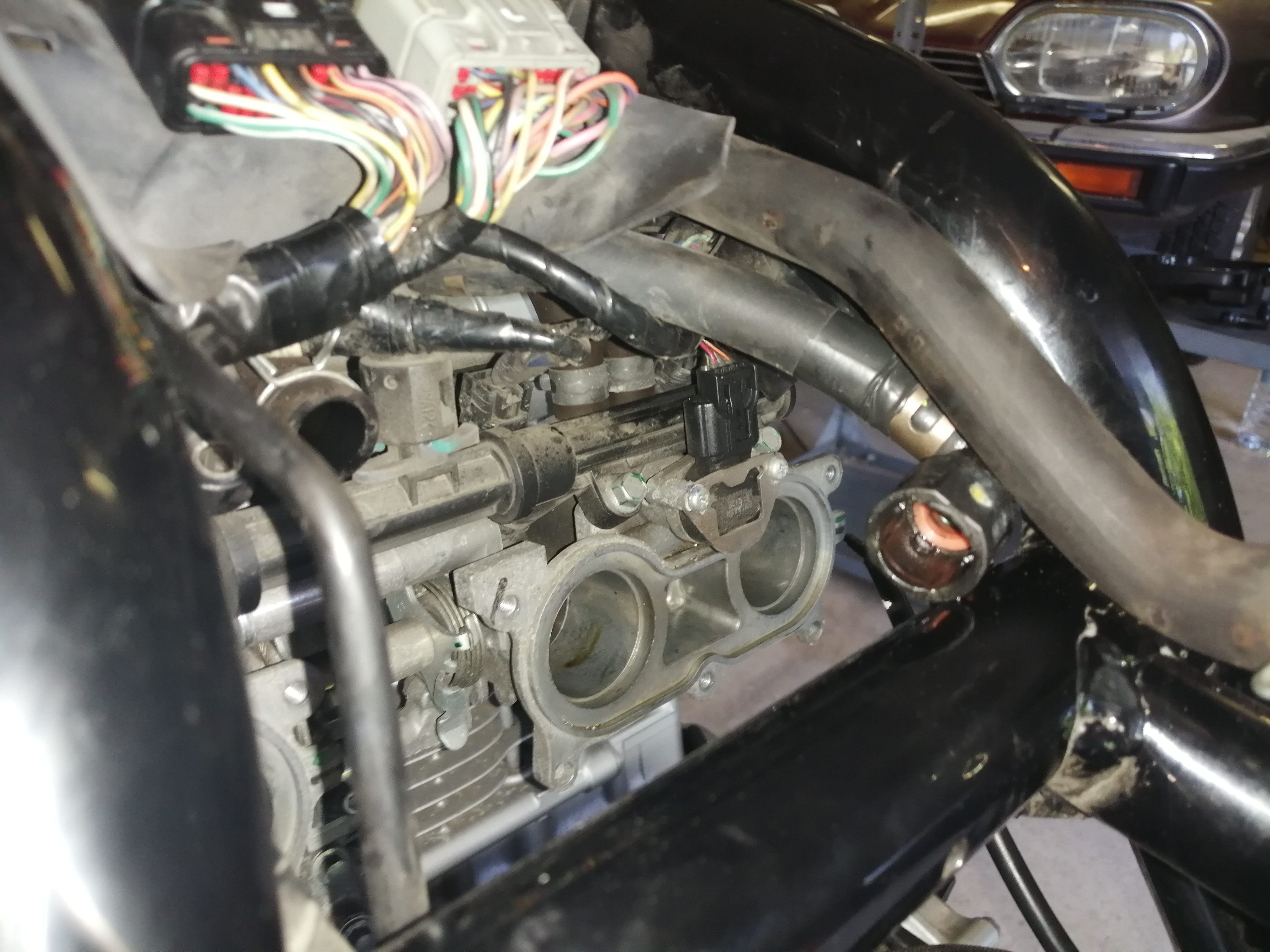

Just gained access to the IACV valve. Quite tricky to remove the inner part of the air filter box, very tight. I was afraid breaking some wire or hose. I am going to move the moustache and after that replacing the Valve.
[Image: 753d5ed1f1e65f8fe248ce78b67d6065.jpg]
I was afraid breaking some wire or hose too... it was the reason why i went to Honda service.
Nice IACV Smile
