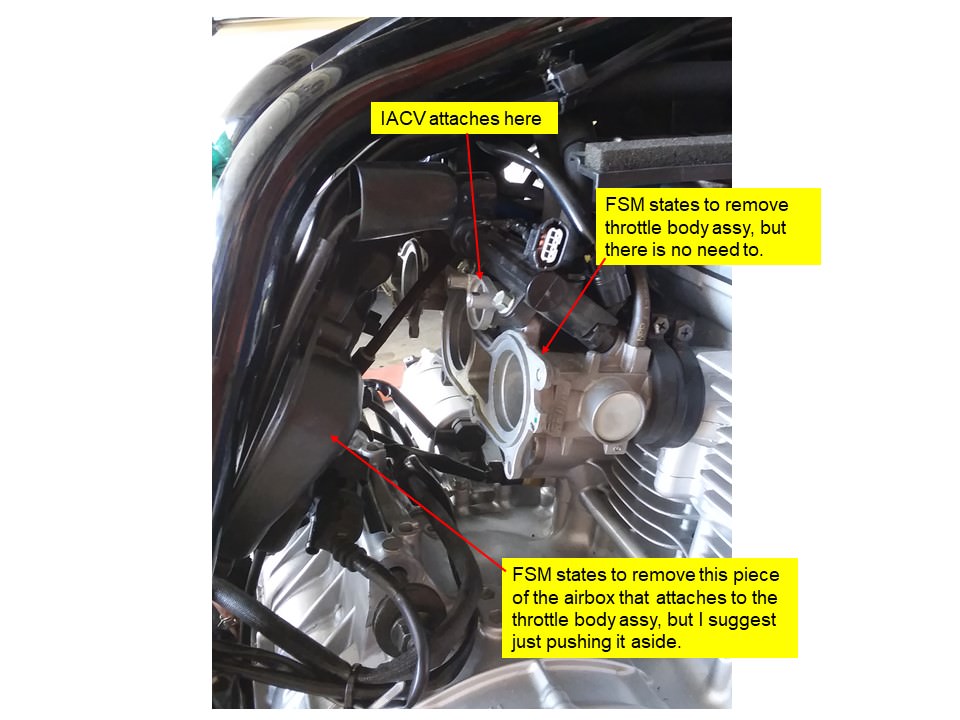

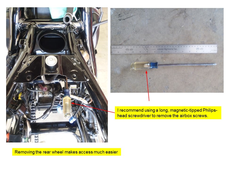

Here are some tips if anyone else wants to replace their IACV:
