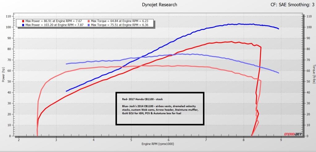

(03-02-2021, 08:48 AM)PowerDubs_imp Wrote: Yea. That was me that made 103whp, and over 75 wheel tq. Smile
[Image: 55abf4cf9717ab56dea6e21b8721293d.jpg]
I was hoping you'd chime in. I have a similar set up. Yoshi slip on, bellmouth, fuel module( Bazzaz instead of PC-V). Knowing the Guhl tune does that much makes it worth the money. Talking 14 CB1000r performance from an air cooled retro.
Impressive
