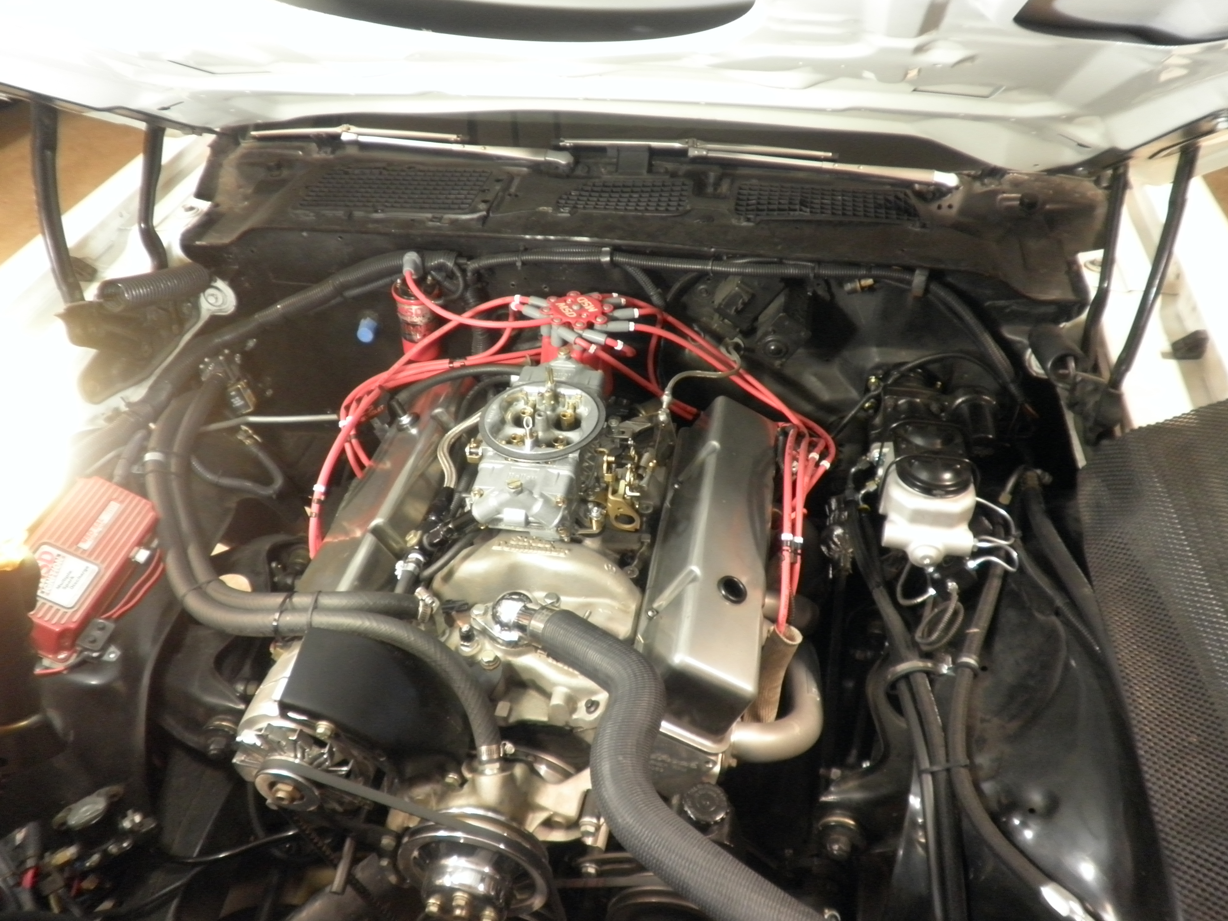

In the car world I had a Comp hyd roller very similar to your modified profile in my 1973 Camaro, it was 218*/224* @ .050 and was perfectly matched at 10.25-1 CR using minimum deck height, flat top pistons and alum heads

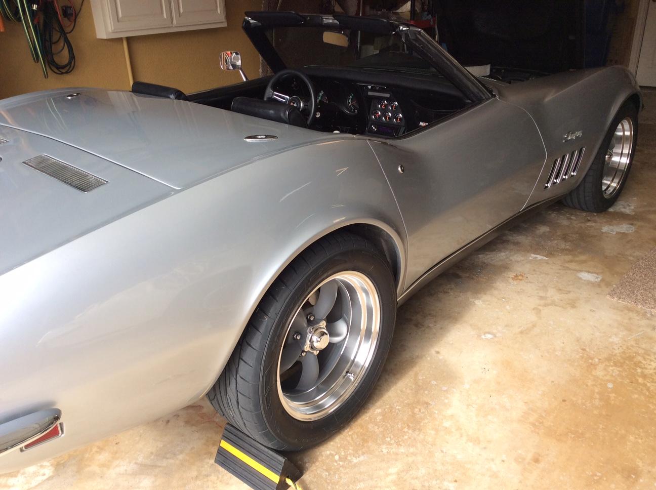

Same recipe of minimal deck height, flat tops, and alum heads with my 1969 Corvette, its got a little more cam at 224*/230* @ .050 but is matched appropriately with a CR of 10.5-1

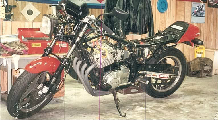

In the motorcycle world, my GS750 was hot rodded back in the 1980's. I ran multiple Cam Motion grinds out of Baton Rouge, La in it as well as a set of Megacycle cams in the .350 lift/240* duration @ .050 range at 11-1 CR. It ended up at 802cc and had a set of 36mm Mikuni's off an early GSXR1100 and a V&H Competition Plus 4-1 exhaust. It was a very strong runner that would keep up with the typical lightly modified 900/1000 cc bikes of its time.
