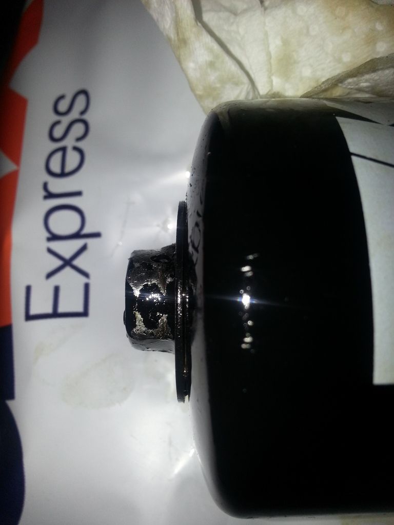

When I arrived, the first thing I did was have a close look at the oil filter, it was not difficult to see, oil was still seeping from between the plate the nut sits on, and the housing. The oil filter was the culprit, beyond any doubt. You can see in the pics below, that the nut and the plate that it is attached to, have separated from the housing, creating a massive leak.
I measured the amount of oil that I drained from the engine, there was about a quart remaining. This was nearly catastrophic, had I not managed to shut the motor down, a couple of additional minutes of running, and the engine beyond a doubt would have seized up. I then tried to remove the filter, and the 17mm nut, the one that makes it "easy" to remove the filter, a strong reason that I was using those filters, stripped right away when I put my 17mm open end wrench on it. Ironic, the filter nearly toasted my engine, and I didn't even get the benefit of easy removal, Smile . It was a long struggle to get that filter off, inexplicably, I did not bring my filter wrench, I thought the 17mm would be all that I needed. Despite being hand tightened when I installed it, the oil filter was really hard to get off, the nut stripped with very little effort. I eventually resorted to the old screwdriver method of oil filter removal, being careful of course not to damage or alter the place where the failure occurred.

In these pictures, you can clearly see the separation of the nut assembly from the housing. No, I did not tighten the filter with a wrench. It was hand tightened
[url=http://s1290.photobucket.com/user/dsargee/media/Oil%20Filter%20Failure/20160930_230207_zpszs83w10q.jpg.html][Image: 42dfcfadeea86ca5b7cff279aa0b39af.jpg]
The scratch marks on the 17mm nut are a result of the nut rounding off when I tried to loosen it with an open end wrench.
[url=http://s1290.photobucket.com/user/dsargee/media/Oil%20Filter%20Failure/20160930_230321_zpsrr6kkvsj.jpg.html][Image: 70e089df99b95b22609282afb332331e.jpg]
Amazing how that little seemingly insignificant nut causes so much trouble.
[url=http://s1290.photobucket.com/user/dsargee/media/Oil%20Filter%20Failure/20160930_230517_zpsjmkv0vjb.jpg.html][Image: ac57be316ee32b796e89839806bffd18.jpg]

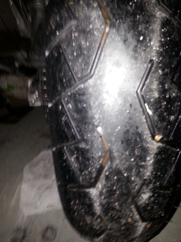

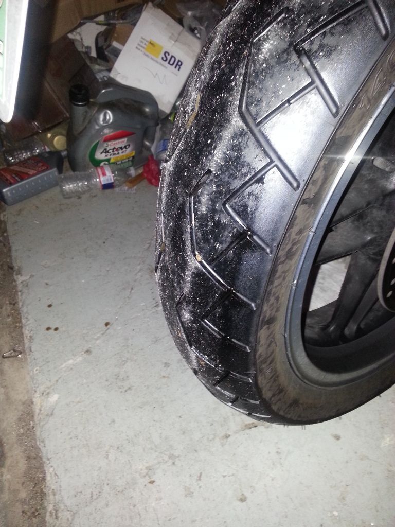

A few shots of the rear tire, still covered in oil after 2 days.
[url=http://s1290.photobucket.com/user/dsargee/media/Oil%20Filter%20Failure/20160930_230607_zpsobulc9kd.jpg.html][Image: cd816554e8f66333cd6f8e7247d8c519.jpg]
[url=http://s1290.photobucket.com/user/dsargee/media/Oil%20Filter%20Failure/20160930_230625_zpsvk12etcl.jpg.html][Image: 88b676629ef43e4c6669c1ed894e9f9d.jpg]
[url=http://s1290.photobucket.com/user/dsargee/media/Oil%20Filter%20Failure/20160930_230704_zpsmsn77gkc.jpg.html][Image: 8eb3afeceb6237e503282529958f12c5.jpg]
Rear tire, oil all over the fender well.

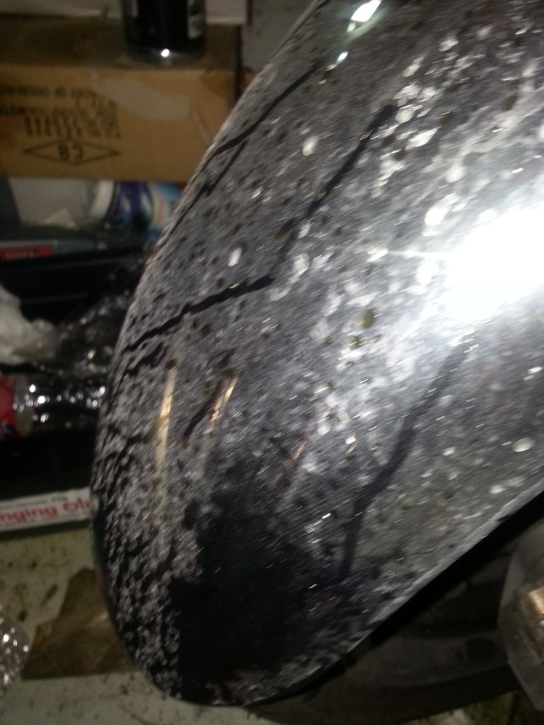

Pics of the front fender, oil splattered on the back of it.
[url=http://s1290.photobucket.com/user/dsargee/media/Oil%20Filter%20Failure/20160930_231044_zpsu4i9ja1o.jpg.html][Image: cf859db10c1a22a1bd420ee21effbeb6.jpg]
[url=http://s1290.photobucket.com/user/dsargee/media/Oil%20Filter%20Failure/20160930_231233_zpsi6vohmks.jpg.html][Image: bbb3d43ad12605df3c6a44033a4cae3b.jpg]

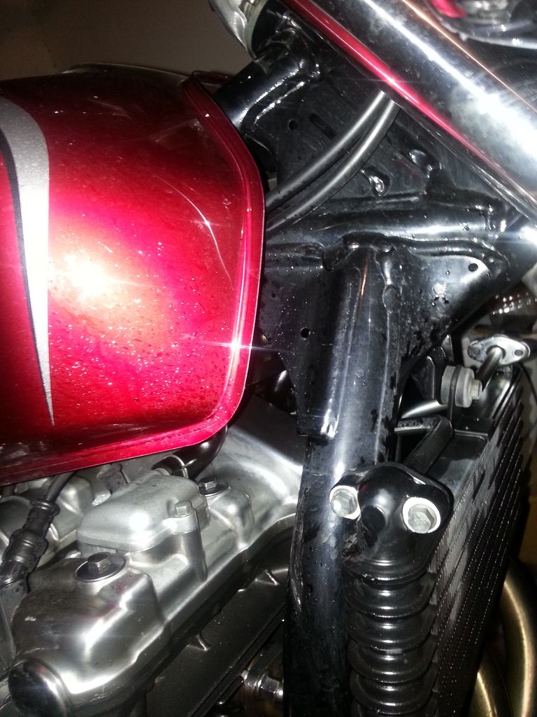

Oil spatter on the front of the tank, and triple-tree.
[url=http://s1290.photobucket.com/user/dsargee/media/Oil%20Filter%20Failure/20160930_231315_zps2ieycuaq.jpg.html][Image: 7158c54a5655fb7d7e5ee2eee3006d5c.jpg]
[url=http://s1290.photobucket.com/user/dsargee/media/Oil%20Filter%20Failure/20160930_231422_zps7m1fpblt.jpg.html][Image: 27a6b3871372826746042bc5a1554b2b.jpg]
