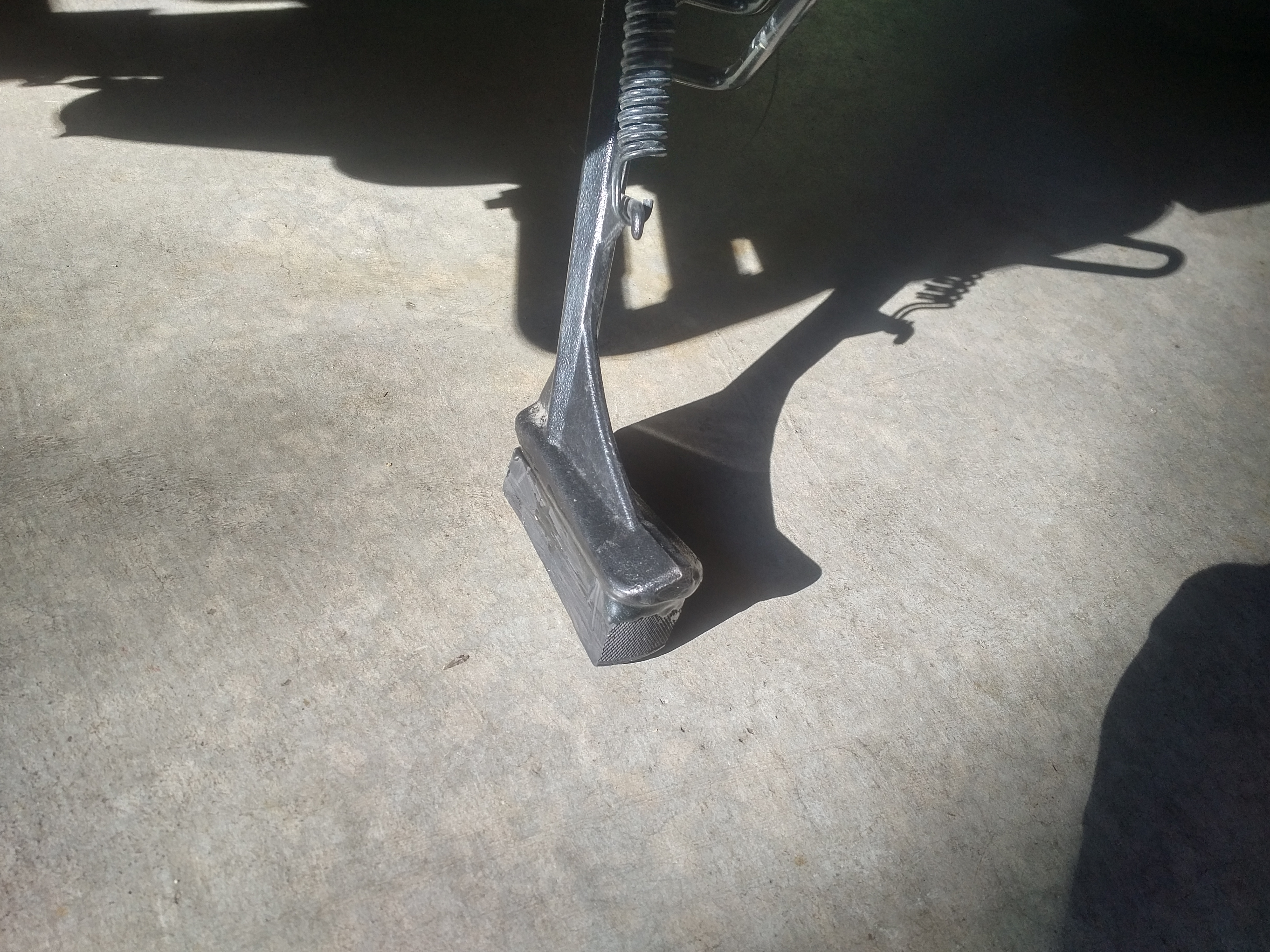

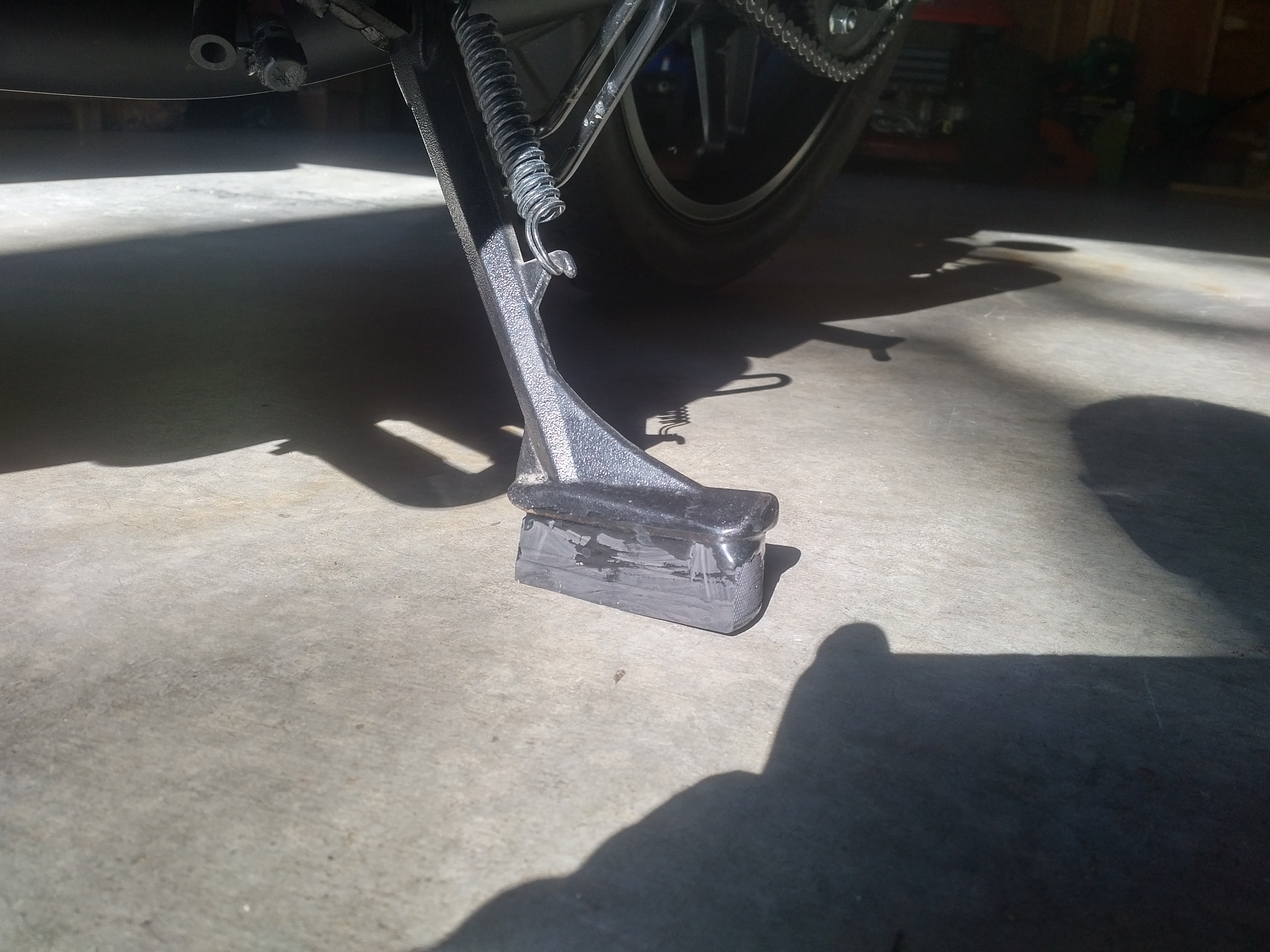

I found this cheap-but-effective option from the creative guys (& gals) on advrider.com: a hockey puck! I might give that a try.
[Image: b20ad861f6fadcfcd116212c42948f86.jpg]
So I copied this idea, and cut a hockey puck to the right shape and glued it (with epoxy) underneath my stand. 15 minute job. And so far (having used it for a few weeks now on an almost daily basis) so good. If it every falls off, I'll just glue a new one on.
[Image: 690b353a8a46d71c49e7a857626714c5.jpg]
[Image: faa30ab3b1cca2c6fbbb1b1678ffdd43.jpg]
how does it look folded up bioman? Might have been an opportunity to make the footprint a little larger too.
(08-09-2020, 10:25 AM)The ferret_imp Wrote: how does it look folded up bioman? Might have been an opportunity to make the footprint a little larger too.
Agree with "The ferret" with the wide foot print, this help on soft asphalt or grassy area.
