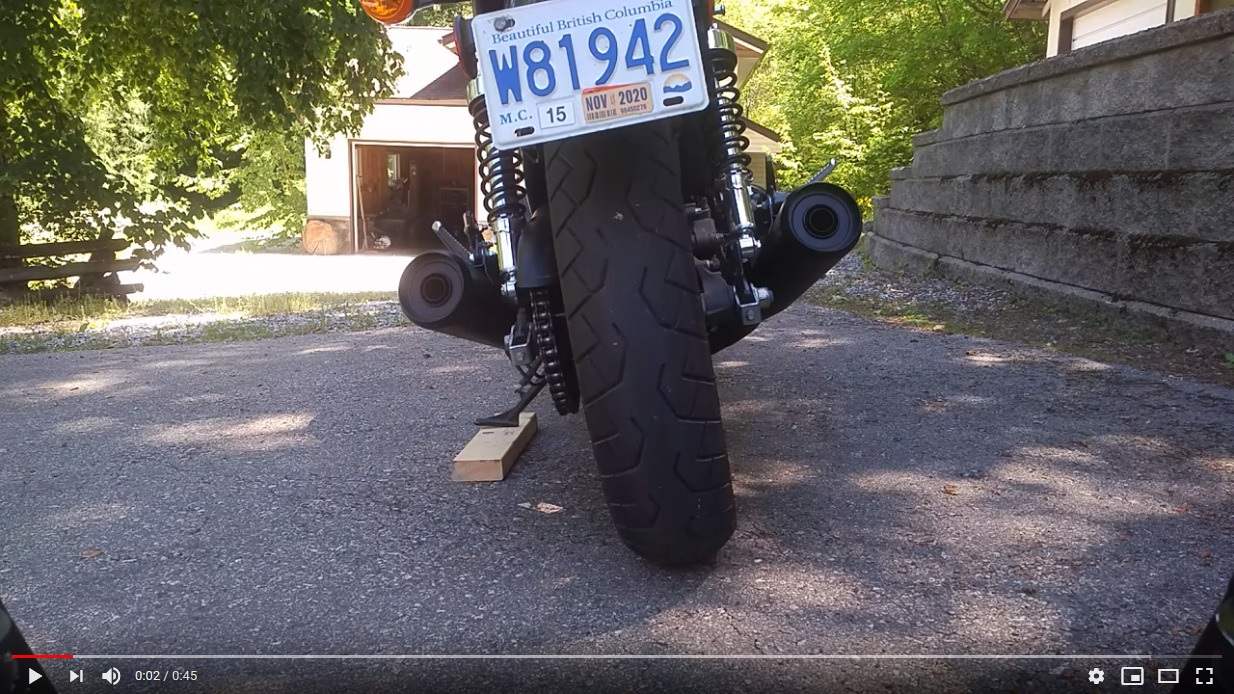

I noticed it before, but now, as I "lost" my center stand, I think that the side stand on my bike is really 5 cm (2 inches) too short. It works but I do not find it very secure, and certainly not if the ground is uneven, soft, or the bike is parked on a slope (with the left/stand side down).
See here: (and that is with a 2-by-4 under it!)

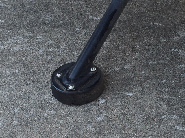

I found this cheap-but-effective option from the creative guys (& gals) on advrider.com: a hockey puck! I might give that a try.
[Image: b20ad861f6fadcfcd116212c42948f86.jpg]
